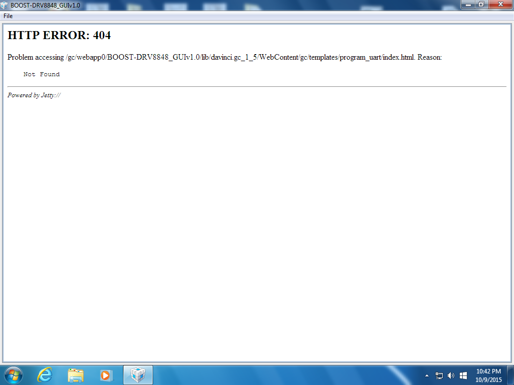

     I tried to run the GUI that is intended to run with the booster pack.   However, I received a reply from the web telling me that there was a "HTTP ERROR 404" - a file was not found.    I have attached a "screenshot" to show you the exact message that I received.
     Can a TI engineer please tell me why the GUI did not work correctly?

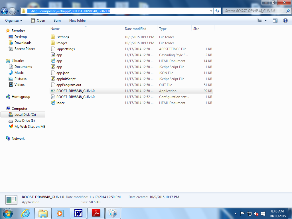

  • As a follow up, it would appear that my installation directory set up is valid.  Enclosed is a screen shot.
    I noticed that I may be missing a *.lib file.   I conducted a conventional installation of the TI download but it appears that I am missing the *.lib file.
    See the first screenshot that references the *.lib folder.
    This is a theory as to why the GUI may not be operating correctly.  I am not certain why the GUI is not working.
    Can a TI engineer explain to me why this typical, conventional, download and installation is not working.

  • Hi Michael,
    Strange, I have not seen this error before. It seems like the GC Runtime ran into an error when it tried to open the app. I will ask the team here if they have seen this before.
    Can you confirm a few things...
    • What version of the GUI Composer Runtime did you install?
    • You are using a MSP430G2 LaunchPad with an MSP430G2553 device, correct?
    • The LaunchPad was programmed through CCS?

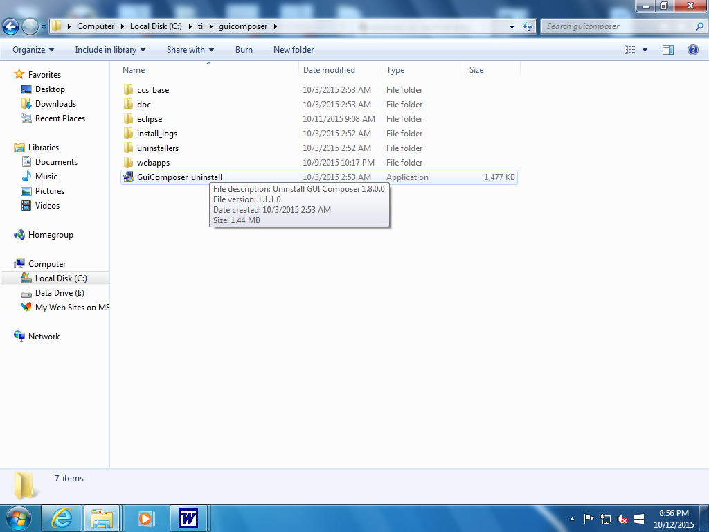

  • Dear Nick;
         Thank you for replying to my post.
          I am not exactly certain about the "Runtime" term that you used when you wrote:
    "What version of the GUI Composer Runtime did you install?"
          Therefore, I am enclosing a "screenshot" of what I believe is the information you are seeking:

  • Hi Michael,
    Thanks for the information. I was looking for which run-time version was installed from the below link. It is recommended to always install the latest.
    http://processors.wiki.ti.com/index.php/Category:GUI_Composer#GUI_Composer_Runtime
    We use the GUI-C tool since it is integrated into CCS and allows us to create simple apps that a customer can also modify. It also provides a simple interface to most TI MCUs. The team thinks that possibly an install error happened or an outdated version of the runtime is in use.
    I would recommend uninstalling your current version and then installing the latest version from the link above. After you install the runtime, you can place the app in the webapps directory and try running as before.

  • You should be able to install the new version into a different directory, just change the name of the install directory. I have done something similar for my machine. I believe some of the c2k kits utilize a subset of the GUI Composer Runtime. This subset of GUI-C does not contain the libraries for MSP devices.
    The app is not actually accessing the web when it is running. GUI Composer is a standalone tool. I believe you see an error similar to a web access error because GUI C uses a web based formatting for creating the GUI (HTML + JavaScript). It is convenient to use HTML and JavaScript for GUI creation as it a well know format and language for creating visual interfaces. But the app is running entirely local to your machine.
  • Dear Mr. Oborny;
    I would like to thank you for your information, the download and install of the latest GUI Composer software package resulted in a working GUI.

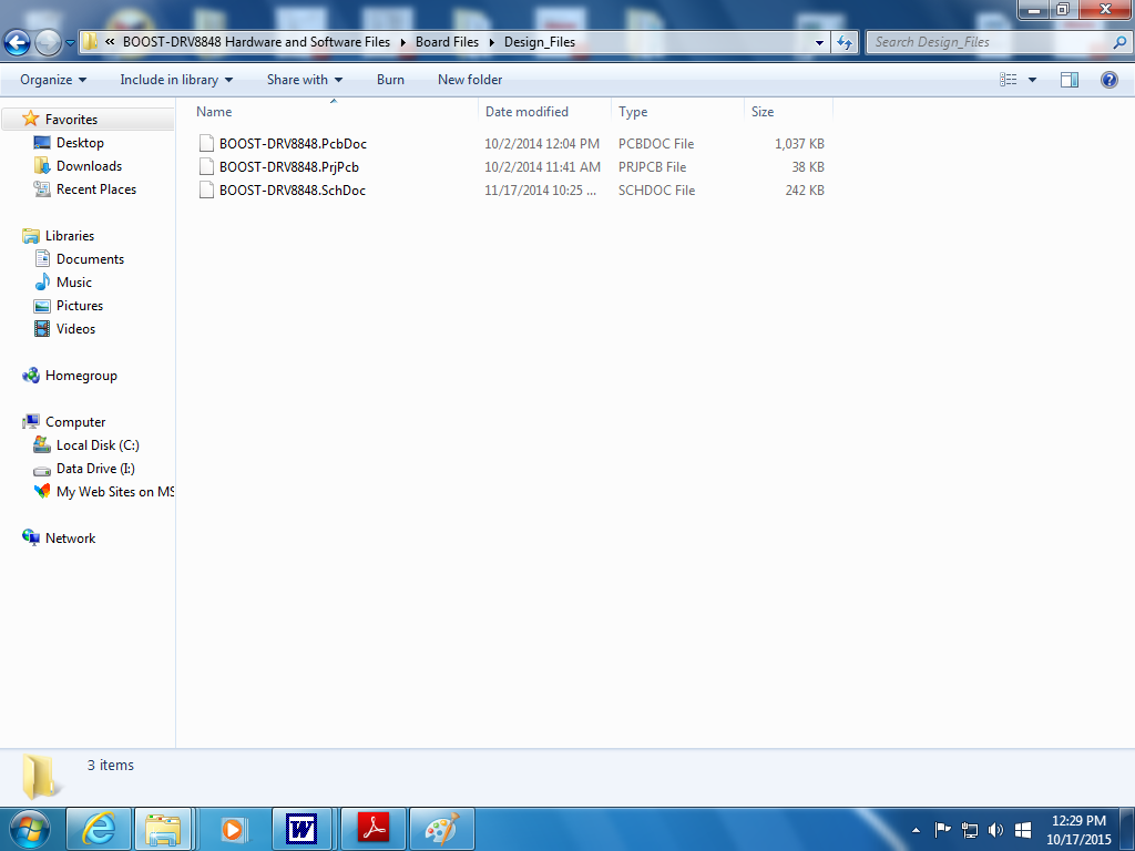

         I would have replied sooner.  However, installing and obtaining the Altium product was a difficult, convoluted, process.  I finally did install the trial software and obtained my license.    Afterward, when I looked at the BOOST schematic in Altium, I discovered that it was the same deficient schematic that I originally observed.
         I have uploaded a screenshot of the schematic so that you may be able to observe what I have observed.
         As you can see this schematic is deficient.    The customer wants to see exactly how the MSP430G2553 is connected to the BOOST brushed DC motor kit.
         I really have to say, the decision to use this schematic was a complete and total mistake.    An engineer, technician, student, or a hobbyist, wants to see the complete circuit, not disconnected portions of a circuit.

  • Michael,
    The LaunchPad schematic is not included here as it is not the same PCB. This is a daughter board for the LaunchPad. As we do not know for sure which LaunchPad the BOOST-DRV8848 will be connected to we do not attempt to provide it here. It you know what specific LaunchPad you are using you can find it's schematic as well on ti.com.
    http://www.ti.com/ww/en/launchpad/launchpad.html?DCMP=mcu-launchpad&HQS=launchpad
    The connections to the LaunchPad connector are indicated with the "LaunchPad Connection" section. You will find similar connectors on the LaunchPad. I admit that the connections may not be obvious but we try and follow a similar format where the left header on the BoosterPack schematic is associated with the left connector on the LaunchPad with similar orientation and same for the right connector.
    I'm sorry for the miss-understanding but there is no simulation model available for this PCB at the time being. This is a PCB CAD schematic, not a circuit simulation.
    Altium is a PCB CAD tool, similar to many others out there. The majority, but not all of TI's eval boards are done with it.
