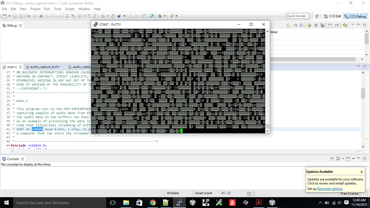

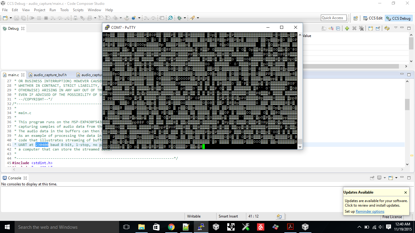

  • Lorin I have two questions:
    What do negative numbers in the context of the captured audio mean? I was expecting everything to be absolute value. Secondly, the uart output is garbage data on my screen. Could this be a symptom of having to byte swap the values? I am sure I set the baud rate to 230400 and I can tell that the data matches of with whatever sound there is.
  • Micah,
    It actually looks like you have got it working. I also use PuTTY, and the output is supposed to look like nonsense.  That is because the program streams raw binary audio data samples. The code is written so the ADC will output audio samples as 16-bit two's compliment binary audio samples to the buffer. These two's compliment binary samples are streamed to the PC a byte at a time. Set PuTTY to capture all data in the log file. Its also a good idea to set PuTTY to not output any bell sound, since the binary audio data bytes will randomly match the ascii bell value. After collecting data for a while, stop collection. Then open the log file in some program that can read and plot binary data, such as Matlab. You should get a signal showing the speech data as shown below. If it does not look like a speech signal, then bytes may have to be swapped, since PuTTY sometimes seems to have some extra bytes at the beginning of the log file.
  • Hi Lorin,
    My data plotted by matlab definitely doesn't look like a audio signal, as all the values are positive. Byte swapping this data would still give a positive value, so that makes me think the data needs to be swapped before its sent to putty. I am confused how to do this. From what I understand, the code sends the data through UART with this:

  • I am very confident this code does work. it should not be necessary to byte swap or alter the data prior to transmitting it. Would it be possible for you to record some audio with the program and share the PuTTY log file with me?
    The line of code you listed just sets up DMA channel 2 with the destination address of the DMA transfer, which is the UCA1 UART transmit buffer. It does not start any transfer. The actual transfer is accomplished in the audioCapture function while loop. Look at the lines of code following the comment:

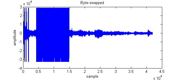

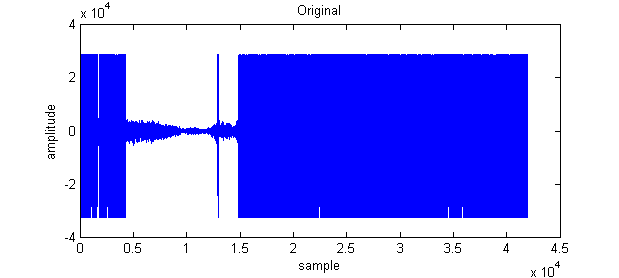

  • Ok, thanks. Its make more sense. Ive attached some recorded audio. Out of curiosity, did you try or were you able to extract the FFT code from the users example? I am having a heck of a time integrating that code into this one. audioCapture1.brd
  • I looked at the data you sent me. I plotted both the original data, and the data byte-reversed. They are shown below.  It appears that at some points in the transfer of the data bytes are being dropped.  I played the section of code in the original data in the range of samples between about .5e4 and 1.5e4, and in the byte-swapped data between about 1.5e4 and 4.2e4. These are valid audio signals. The byte dropping does not happen in my tests. You could try to record again with the PC running as few apps as possible to see if that helps.
    I have not tried to extract the FFT code from the UserExperience demo code. Since the FFT is written in assembly it may be a little more difficult to adapt to your application.  You might also want to look at FFT example code in the MSPWare  IQMathLib example. Under MSPWare look at iqmathlib -> examples ->CCS->msp430
  • Huh, interesting. I'll look further into why my PC may be doing this. In any case, my application does not critically depend on the uart streaming, but its a nice feature.
    I was able to integrate the FFT code. It took some fishing but it is now working. For your code, it is wise to extent the frame size to 1024? The reason I ask is the because the FFT code performs a 512 point FFT and the audio is stored into a buffer of size 1024.  I suppose I could also collect enough samples then truncate to the necessary length if the frame size is best at 160.

    Also, what matlab commands are you using to generate those plots above? I am plotting the same data and am not getting valid audio data. My matlab code is as follows:
    fileID = fopen('test2.bin');
    A = fread(fileID);
    B=swapbytes(A);
    figure(1);
    plot(A);
    figure(2);
    plot(B);

    Matlab code I used is:
    >> fid = fopen('audioCapture1.brd','r');
    >> A = fread(fid,inf,'short');
    >> plot(A);
    >> B = double(swapbytes(int16(A)));
    >> plot(B);

    It seems that my data is still being corrupted when I transfer it to my PC. This is making it difficult to create a template. I am running with only CCS open, do you have any idea why this could be happening? When I play the recording in Matlab its just static with bits and pieces of valid audio.
  • My thought is still that somehow bytes are being dropped. I tried the audio capture code with CCS and several other programs open, and had no problem. Make sure that PuTTY is set to 230400, 8 data bits, 1 stop bit, no parity, and that under session logging "All session output" is selected.
    Are you sure the audio capture is finishing in the allowed 20ms? You may want to light an LED if real-time is lost. That can be done in the DMA interrupt.
    If you are convinced that real-time is not lost and PuTTY settings are correct, would it be possible to distill your code to simple audio capture/streaming, and share it so I could test?
