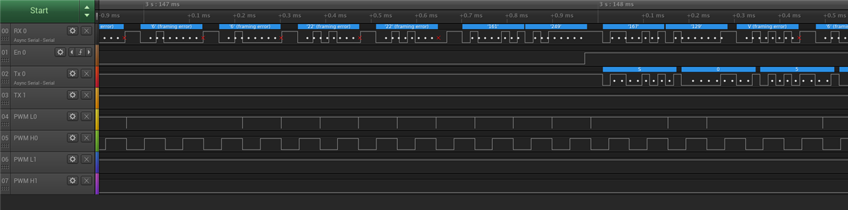

     Processor is MSP2553 QFN32, board under test is on the bench and I am trying isolate issue, PWM is generated from timer 1 interrupt is disabled CCR0 is set to 1040 and max PMW is set tl 1020.
     Output from Port 3 (bottom traces) are the worst, output from channel 2, the one running most of time are upper traces, they must be complementary to drive low and high side but one side behave worst. Timer 0 is used for timing purposes and generate regular interrupt but no PWM.
     here the waveform:

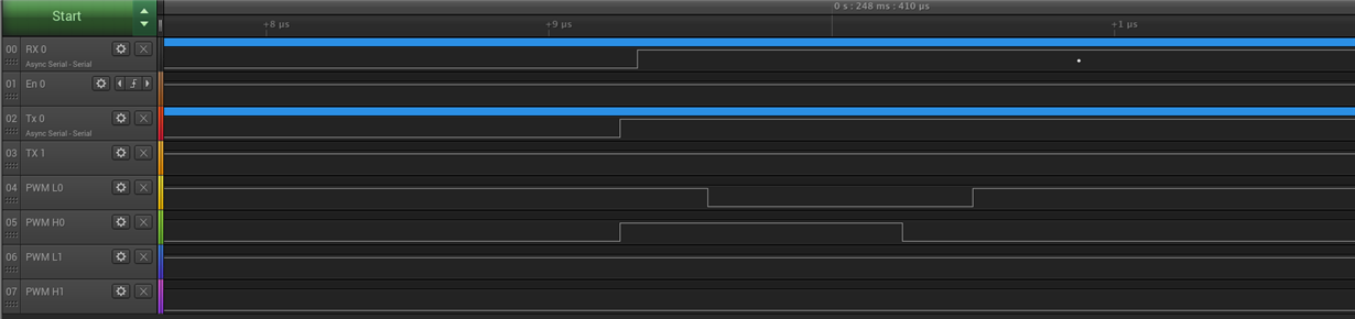

     complementary from port 3 are both high with some spike and big jitter.
     Here the port 2, timing on Low PWM value, waveform are correct but this strange phase shift appear, can be justified on ccr load but this can be just one cycle.
     Low channel is missing some pulses driving high also when high side driven, H bridge driver prevent shoot trough but this is unwanted...

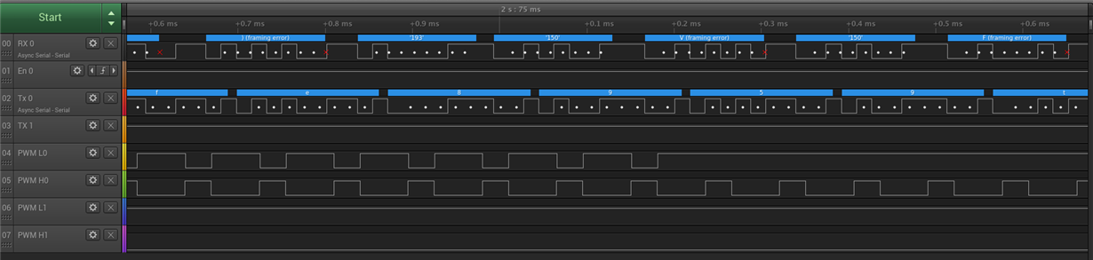

    here again PWM channel stop and leave output High.
     Trouble on restart channel pwm is wrong, register are both at same value.
     Here after restart some jitter and noise are present on Low channel

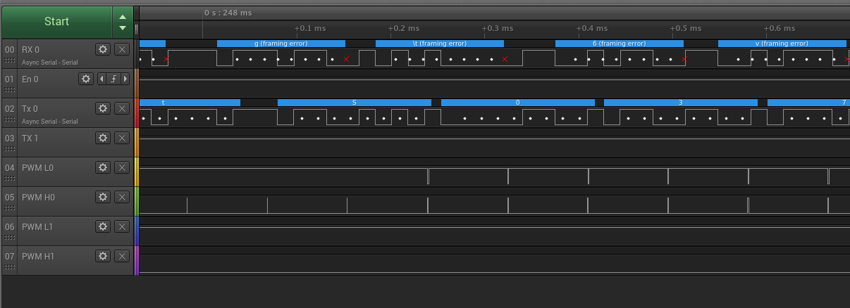

     And here the worst, this noise on drive.
     This issue on same test repeat across different processors, both CCR1 and CCR2 get written at same time, I still don't know when this problem get fired but when appear first time then PWM is no more reliable.
     Code is compiled on CCS, the strange that same code compiled on IAR was less sensitive to this issue, the board from where waveform where taken is on bench without motor and power section, Bridge driver removed and connected to logic probe. At first glance appear as issue is related to some PWM values, and happen related to serial channel signalling too. Next week I try drive from constant drive and do some experiment on chunk of code generating PWM with and without communication protocol.

           	waitms(3);
    And the ISR::
     *  ======== Timer1_A3 Interrupt Service Routine ========
    #pragma vector=TIMER1_A0_VECTOR
    __interrupt void TIMER1_A0_ISR_HOOK(void)
        /* USER CODE START (section: TIMER1_A0_ISR_HOOK) */
    	/* Timer Tick 1ms */
    	if(time_ms > 0)
    		time_ms--;
        /* USER CODE END (section: TIMER1_A0_ISR_HOOK) */
    Does anyone have an idea what I can do to avoid that?
  • It seems that the problem is, that I use the same timer for the timer tick and the PWM.
    If I use Timer0 for the timer tick and Timer1 for the PWM all is working fine.
    But I have no explanation for this.
    Hans
