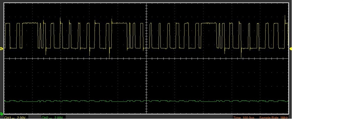

    Do you have an oscilloscope to have a look at the signal output?

  • Dear Dennis,
    please check the wave form and advise me.
    thanks.

  • Dear Dennis,
    This is the thing that i asked in the starting can you help me to trace why the pwm having unwanted width i already send the code and wave form to you. i am again attaching the same for your reference. this is the code

    and this is the scope out. please advise.
    thanks.
  • What do you want the PWM to look like?
  • Dear Dennis,
    Please look the output wave form. my pwm values are 0, 31, 59, 81, 95, 100, 95, 81, 59, 31 but the wave form is having some unwanted widths.
    thanks.

  • Dear Dennis,
    Please have a look on the image the arrow mark shows the unwanted PWM
    Thanks.
  • Can you sort the number of your CCR value to the unwanted cycles?

  • Which of your CCR values causes the unwanted output?
  • Dear Dennis,
    It may be 31 or 0
    Thanks.
  • If I were you I would test it to know for sure.
  • In your code, the timer generated interrupts too often and the CPU cannot handle them in time. The resulting waveform at P1.6 is difficult to predict.
    I slowed down the timer clock by a factor of 8x8=64. The result looks fine to me (but may not what you expect).
