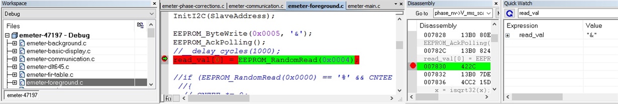

  • Here is the thing. With the following code, I have not the code crashed but it is reading from the bit which is the neighboring bit and &!
    So, sometimes & and sometimes P!
    InitI2C(SlaveAddress); EEPROM_ByteWrite(0x0003, '&'); EEPROM_AckPolling(); read_val[0] = EEPROM_RandomRead(0x0002);
    How can I get rid of P?!

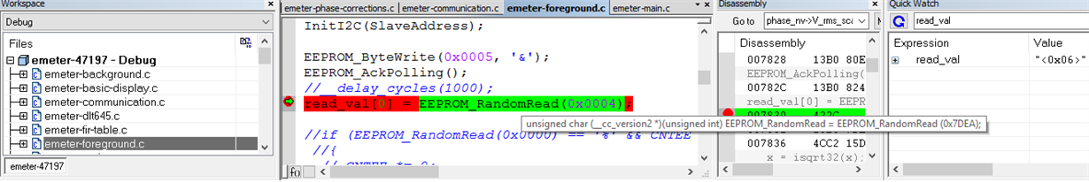

  • And not to mention that sometimes '.' which I don't know where it comes from!
    And now no '.' I changed the address I have two following characters.
  • Now it is crashed again!
