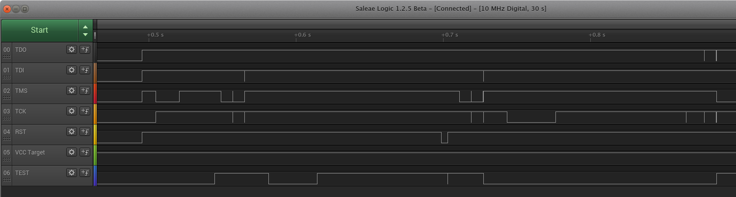

I have a MSP430F5338 on a custom board that I'm having trouble accessing the the MSP430 Flasher v1.3.7 utility. I'm running on Ubuntu 14.04 using a MSP-FET. I'm getting an 'unknown device' error from the flasher utility when running the tools without any command line arguments.
I've verified that my software install of the flash utility and MSP-FET are working correctly as I can identify and program a MSP430F5338 on a MSP-TS430PZ100C devkit without any problems.
I've attached two logic analyzer screen shots of runnign the flasher tool just to identify the attacted processor.
The first is of a bad transaction with the beta board:

The second is a good transaction with the devkit.

On the devkit, I see a couple of pulses on the TDO line just after the 0.4 second mark. I don't see those on the beta board. That looks like the first place that the traces start to differ.
Does anyone have any theories as to why I can't communicate with my custom board?
