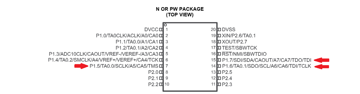

  • Erik,
    the MSP430G2452 has it's USI pins at P1.5 (SCLK), P1.6 (SDO) and P1.7 (SDI):
    For using the SPI functionality, you have to set P1SEL for each pin you want to use (you do not need SDI if your slave does not output anything). This line:
    P1SEL |= 18; // Selects SPI pins
    is the same like
    P1SEL |= 0x12;
    // OR
    P1SEL |= (BIT4 | BIT 1);
    So none of the SPI pins is selected. Furthermore setting USICNT should be done right before the transmission only, not inside your configuration. Sorry, my fault - you set USI16B inside the configuration. That's OK!

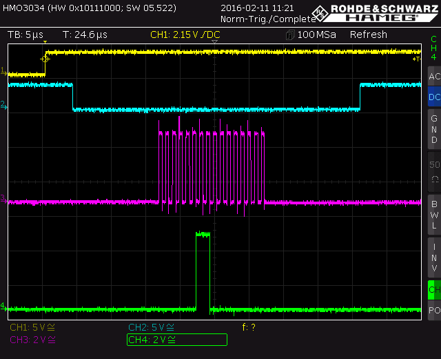

    The code works, as I can see from the oscilloscope pictures, but I do not know if your potentiometer just needs the value without any further command or register address, so this might not be plug and play for you.
    The yellow trace is the red LED1 on P1.0 that is set each time a transmission starts. It turns off after 100ms (interval of the timer interrupt) which is much longer than the transmission, so you do not see it turn off on the scope screen. The blue trace is chip select on P1.1, the purple trace is the clock signal and the green trace is SDO. In this picture the value 768d (0000 0011 0000 0000) is transmitted.
    The following two pictures show only LED1 at P1.0 and you can see that a) a transmission starts every second and b) the LED1 turns on for 100ms each time a transmission is started.
    Dennis
