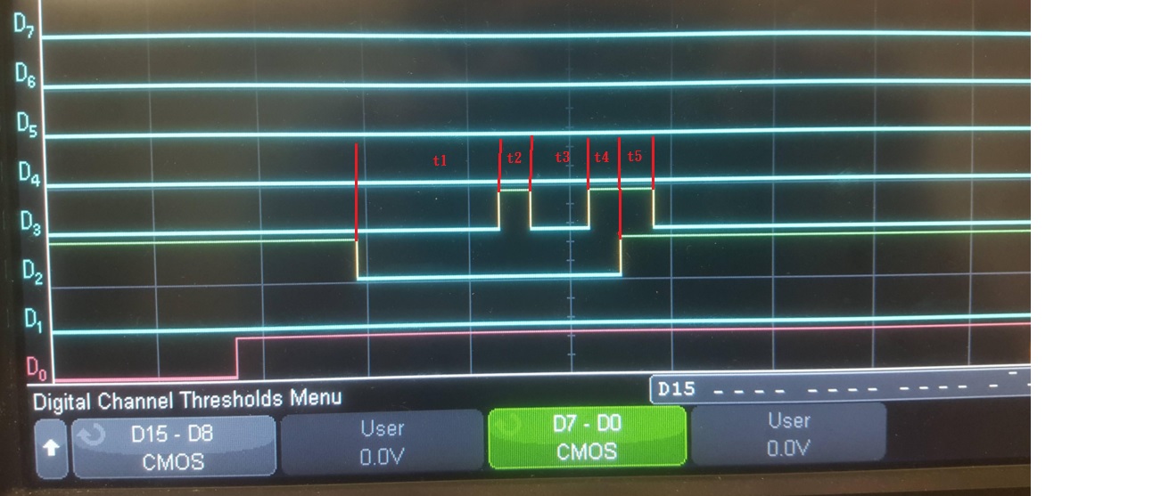

    Why I think the BSL is not working - Below is a picture of the entry sequence attempt using the FR5969 to invoke the BSL on the FR6989. The FR6989 is running a simple blink program at the time. There are two things that tell me the BSL isn't loading. 1. The FR6989's blink program doesn't stop. It should stop to load the code for the BSL. 2. As you can see in the picture below, UART TX is initiated first, then the device is reset with the BSL sequence. However the RX line is never driven high, which it would be if the UART hardware used by the BSL was being used. So the BSL doesn't seem like its ever loading.
    - scope for BSL on 6989 - http://i.imgur.com/J5Uem32.jpg D_0 is FR5969 TX (2.0), D_1 is RX (2.1), D_2 is RST(1.3), D_3 is TEST(1.4)
    Compare this to when I use a FR5969 to invoke the BSL on the FR5739, which is shown below. This picture is over a bigger timeframe, but you can see that the RX line does go high after 5ms. No matter how long I wait when trying this with the 6989 the line never goes high (and the blink program never stops).

  • Michael,
    What is the timescale on these captures? Recommended minimum time for pin states is 250ns for BSL entry.
    JH
  • JH,
    I'm not at the scope right now to give exact time measurements, however I am fairly certain they are at least more than 250ns. I'm running the MCLK at 8MHz (with no divide) and the minimum number of cycles I wait (the first time TEST goes high) is 50 cycles. All other times are at least 100 cycles. So by my calculations that  smallest time (50 cycles) should be 6.25us. Previously, I have tried to increase the number of cycles for this, but it did not seem to help.
    Michael
  • I think you need to make all the intervals t1, t2, t3, t4 and t5 longer than 30000 nsec. (That is, > 30 usec each.)
  • It would not hurt to make all intervals > 300 usec or even 3000 usec.
    But < 30 usec just would not work.

  • So after doing what you suggested it seems to work. I've been having odd issues where it would sometimes work, but usually not. I messed with it for a few hours before getting annoyed and replaced all the wires. Then it started working more correctly, but still not perfectly. Then I put an analog read (versus the digital I was using) on the reset line, and noticed it was at only about 1.8V. So I replaced those wires again and that went up to 3.5V. Magically it all started to work, seemingly every time.
    The one difference for me is that I have to have all times (t1, t2.... t5) greater than 67us to have it work. Much less and it just doesn't work at all. But thank you and others for the help. Now its time to figure out why it still isn't reprogramming. But that is another issue.
