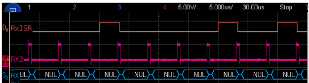

Here is a CRO capture to illustrate my problem.
The top trace shows the runtime envelope for my EUSCI receive ISR.  It runs in just over 3uSec.  This is more than fast enough to keep up with 2MBaud (where one char is 5uSec).  This runtime can be further reduced with optimization but I choose not since it's not necessary at this point (and it gets in the way of debugging).
The middle trace is the Rx pin of the MSP432.  The signal here is nice and square with minimal overshoot etc.  I don't think a signal integrity problem is at play here.  You can see I'm transmitting a string of 0x00 here.  There number of missed characters seems to depend on the data.  0x00 is missed more often than something with more transitions like 0xAA.
The bottom trace shows that my scope is successfully able to decode the data - further evidence that the signal itself isn't too bad.
This next picture is just a close up just to prove the time in ISR is less than the character time.

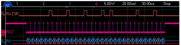

The problem here is in the top trace.  I've sent 32 chars, but the EUSCI interrupt has only fired 7 times (this is an extreme example - most bursts 32chars are received correctly.  Sometimes, one or two chars are missed.  Occasionally,  lots are missed).
There are no UART errors happening here (RxError, Overflow etc).  Character are just missed.
[That said, my college did some similar work and he always saw a missed character followed by an overflow error, so characters we always missed in pairs.  We can't work out why my result is different to his.  Code is very similar.  Maybe it is something to do with the MSP432 devices themselves??????]
Now, I've found that I only get missed characters with particular configurations.
Using a 12MHz SMCLK to drive the EUSCI module Baud rate setting between about 1.75MBaud to 2.05MBaud have lots of missed characters.  Outside this range the missed character rate falls away.
If I set SMCLK to 24MHz, I never see any missed characters when operating around the 2MBaud mark.
I guess I have given a workaround to my own problem here.
But (a) maybe this will help someone else in a similar situation in the future, (b) perhaps there is a real problem here that TI can take a look at???  and (b) this would have been difficult to debug if I had gone straight for DMA!

  • G'Day Clemens,
    Thanks for your response.
    There is a status bit check in there and no Rx errors are ever detected.  (The only bit I see set in the UCAxSTATW reg is the UCBUSY bit.  This seems normal to me - if we are receiving a stream of data, the ISR will be processing the previous charact while the next character is arriving, so UCBUSY will be set during the ISR, except for the last char in the stream.  That is exactly what I see!).
    I entirely agree the DMA is the only way to receive the data, and then do something useful with it at this data rate.
    But I have a situation where it would appear that, sometimes, the UCRXIFG flag is never set*.  In my understadning, DMA relies on the interrupt flags and if the interrupt flags aren't being set, a DMA implementation won't quite work (and it will be really hard to work out why!).
    So until I understand this problem with the interrupts better, I worry about moving onto a DMA implementation.  Do you know of a complete working example of UART DMA at 2Baud?  Particularly one that can deal with occasional missed characters (a particular issue because DMA operations are setup with a fixed size in advance).
    * I assume UCRXIFG is not set because that is the only interrupt enabled for the module, and the corresponding module's ISR doesn't run.
    Cheers
    Julian
  • G'Day f.m.
    Thank you for your response.
    The only interrupt going on here is the Rx interrupt so there is definately nothing else "stealing time".
    The code checks for all Rx error flags and none are every set.
    I'm reasonably sure there is no signal integrity problem here.
    I have the CRO connected as close as possible to the uC RX pin and I'm seeing nice clean signal.
    I can't see where driverlib makes RXBUF volatile - I'll look into that.
    Thanks!

  • Hi all,
    There was a fair bit of traffic overnight.  Thank you for your thoughts!  I'll repsond to each here:
     But first I just wanted to restate my original question (which was not clearly stated in the first place) :
    In implementing an interrupt based high speed (2MBaud) UART I am seeing:
    * Characters are missed if I run SMCLK = 12MHz, Bit rate = 2MBaud.
    * Characters are never missed if I run SMCLK = 24MHz, Bit rate = 2MBaud (just adjust the prescaler in the UART configuration accordingly.)
    Why????

    f.m.:
    "Add GPIO pin toggling code to the ISR (H at entry, L at exit), and watch it on a scope, together with the serial line data."
    That is exactly what I did!  Refer to the RxISR trace in the oscilloscope traces above.  The ISR is most definitely running quickly enough to keep up with the data rate.  MOST of the time it will receive all 32chars in a burst just fine.  But, on some bursts, some characters are missed (the GPIO doesn't toggle indicating that the ISR didn't run for some reason).  Sometimes one or two character are missed, sometimes most characters are missed.

    • Characters are missed if I run SMCLK = 12MHz, Bit rate = 2MBaud.
    • Characters are never missed if I run SMCLK = 24MHz, Bit rate = 2MBaud
    The User's Guide says in sections 22.3.9.1 and 22.3.9.2:
    Modulation is based on the UCBRSx setting […]. A 1 in the table indicates that m = 1 and the corresponding BITCLK period is one BRCLK period longer than a BITCLK period with m = 0.
    Modulation for BITCLK16 is based on the UCBRFx setting […]. A 1 in the table indicates that the corresponding BITCLK16 period is one BRCLK period longer than the periods m = 0.
    So you should avoid modulation, especially if the ratio between the clock source and the bit rate is not very large (in that case, the relative timing error due to the longer/shorter bits is larger). If possible, use a clock that is an integer multiple of 8 times the bit rate.
  • I have oversampling disabled, no modulation (UCAxMCTLW reg = 0) and set set the prescaler (UCAxBRW) appropriately based on the SMCLK rate.
    With oversampling disabled, section 22.3.9.1 is relevant for me and it says
    "In this mode, the maximum eUSCI_A baud rate is one-third the UART source clock frequency BRCLK."
    For me, BRCLK = SMCLK = 12MHz, so 4MBaud is the theoretical limit (though the datasheet for the RevB parts gives a max of 3MBaud with VCORE1).  It would seem 2MBaud should be ok.
    I don't quite follow where your comment "If possible, use a clock that is an integer multiple of 8 times the bit rate" comes from, but I feel it is close to the core of this problem.  There is some other limit in the relationship between BRCLK and the "BITCLK" (Baudrate) that I'm hitting up against when I run SMCLK = 12MHz.
    I think I'll continue on with SMCLK = 24MHz since that allows my clk to be at least 8 times the bit rate.
  • Sorry, "integer multiple of 8 times" is wrong; what matters is the ratio between BRCLK and the bit clock.
    With 24 MHz, the possible errors are half as big as those with 12 Mhz, but they are still there.
    See section 22.3.12 for how to calculate the receive bit timing errors. (In this case, there are no transmit bit timing errors because there is no modulation.)
    See the USCI UART Calculator if you don't want to do the calculations by hand.

    I think it is telling me that for BRCLK = 12MHz, BitClk = 2MHz
    * Use Low frequency baud rate generation:
       * No Tx error.
       * For Rx the three samples happen -8.33%, 0%, +8.33% from the middle of the bit period.  (reducing to 4.1% at BRCLK = 24MHz).
    * I take the "...not feasible!" to mean that we can't do oversampling because BRCLK is not at least 16x BitClk.  (This message goes away if I make BRCLK >= 16x Baud rate)
    * All the other baud rate calculators I see online give 0% error for all bits with this configuration.
    This all seems fine to me...
    I'm wondering whether the eUSCI module stuggles to find the start bit in the 12Mhz/2MBaud configuration hence I see missed characters???
  • There are three possible error sources when receiving data:
    • Actions can happen only at the BRCLK edges. If BRCLK is not an integer multiple of the desired bit clock (if modulation is used), these actions happen at the wrong time.
      In your case, this error cannot happen.
    • The clocks of the transmitter and the receiver do not run at exactly the same speed.
      This error cannot be avoided, unless you synchronize the rate of the clocks of transmitter and receiver with a separate mechanism.
      However, when using a crystal (frequency error < 1%), this is usually not a problem.
    • The transmitter can switch the voltage at any random time, but the receiver samples the signal only with BRCLK. So there is random jitter of up to one BRCLK tick in the detected time of the start bit.
      This error cannot be avoided, unless you synchronize the rate and the phase of the clocks of transmitter and receiver with a separate mechanism.
    All the other baud rate calculators compute only the first error. The calculator on the TI wiki computes the first and the third.
    As a rule of thumb, you should try to keep the errors as small as possible (< 1%). So if you can use 24 MHz, do it.
  • Thank you Clemens
