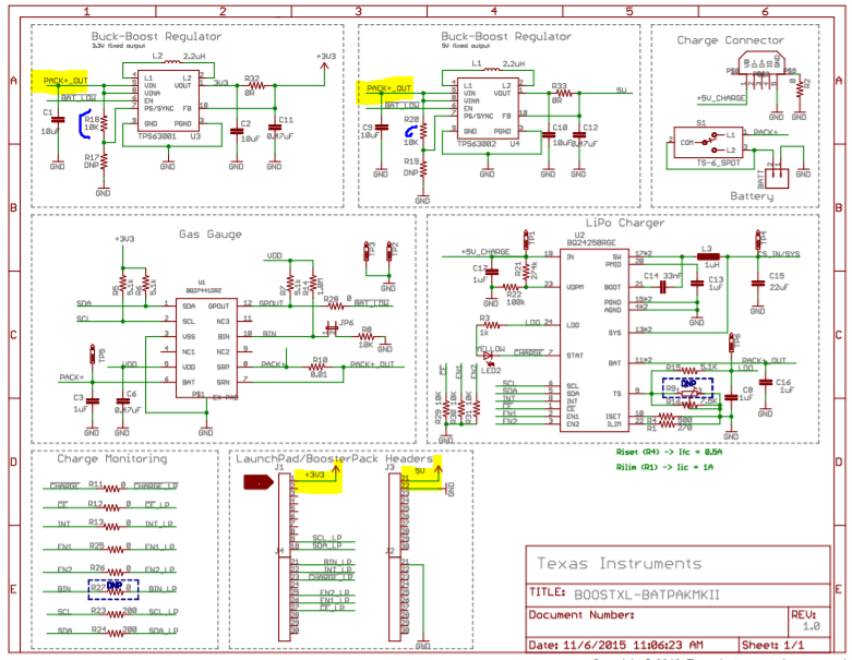

    Where exactly is the current being measured?
    The BoosterPack has many IC's on the board.
    Two buck boost regulators for 3.3 and 5V, a charger and a connector up to the LaunchPad board.
    Schematic page 19 of www.ti.com/.../slau618.pdf,
    Sleep current of bq27441 is very hard to measure, it is dependent on if there is I2C traffic.
    0.5mA with bq27441 in shutdown is all BoosterPack.
    bq27441 shutdown is 600nA, 3 orders of magnitude lower than 0.5mA
    bq27441 normal mode current is 93uA, nowhere close to 15mA.
    That is all boosterpack current.

  • In the BoosterPack user guide, the schematic shows 2 TPS6300x buck boost converters making +5 and +3.3V.
    These voltages go to the Launchpad connector.
    The TPS6300x  have their PS PowerSave mode disabled, by pulling the PS/SYNC pin high.
    Their datasheet shows the Iq being in the 50uA range, so that by itself should not be causing the current.
    However the voltages created go to the connector, so I must surmise that something is installed in that connector that is drawing the current.
    Do you have the MSP430 Launchpad connected?
    If so then that is what is consuming that current.

  • Where exactly are you measuring current?
    Can you send a picture?
    And do you have the USB cable connected?
    when the value is 00.00012 the switch is on ''disconnect''.
    When the value is 00.01344 the switch is on ''connect''.
    The value is in Ampere.
    The black device convert 1mA to 1mV
    Pierre Krebs
  • When the switch is "disconnect" the battery is not attached to the board.
    The current should read zero.
    So the calibration is off a little.
    It would be helpful to scope the current.
    A DVM will try to average the readings. The I-V converter may do the same.
    Whenever a question arises about current, the most accurate way to see it is with a scope.
    Battery current will very likely not be dc, rather it is pulsed in normal applications.
    Pulsed current would not be seen correctly by the DVM.
    And if it is pulsing, the nature and timing of the pulses may help lead us to the cause.
    I suggest experimenting with the setup.
    If there is really 15mA average being pulled then the battery gauge will show a capacity drop.
    The Tool is really made to demonstrate programming and communication using a MSP430.
    For in depth development we recommend the EVM, EValuation Module.
    Gauges need to be calibrated as well, and I don't know if the BoosterPack Tool was calibrated before sending out.
    In the bq27441 EVM, sluuap4a, there is a calibration section.
    Virtually all gauges they must be calibrated.
    www.ti.com/.../toolssoftware
