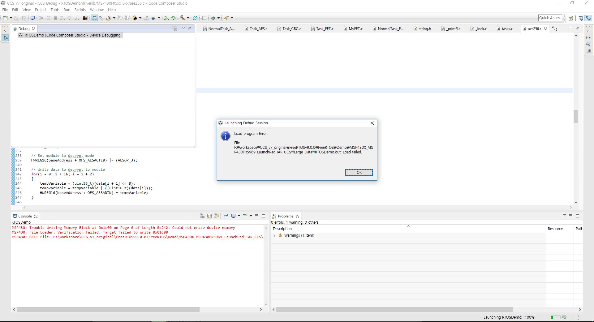

I am using MSP430FR5969 device.
I am having a problem while I am loading program with MSP430-FET debugger.
I have two MSP430-FET debugger.
When I am trying to run program with one debugger then the error message come out like below.
But when I try to run program with another debugger it works normal.
I think the problem is in MSP430-FET debugger but when I searched about this issue there are any comments that this is about debugger problem.
Few reply about this issue said it is about memory allocation problem but I do not think it is, because it works well with my another debugger.
If this is a debugger problem, is there any way to reset the debugger?
If it is not a debugger problem, does anybody have an idea with this problem?

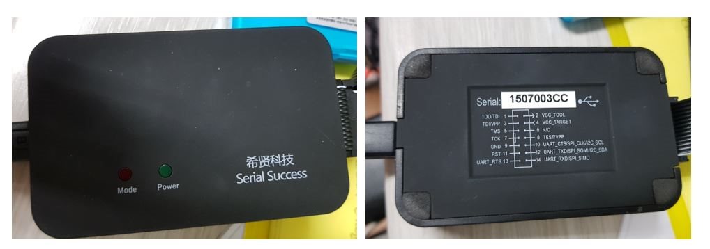

  • Actually I have two of MSP430-FET debugger, one is from TI and the other is from China (I think it it imitation.)
    The one from TI is not working and from China is working (program load is working) but having energy trace problem.
    I wrote this in other topic.
    I attached both debuggers below. and I will look at the link you gave me.
    Thank you.
    Serial number
    Debugger from TI : 17050008FW
    Debugger from China : 1507003CC
    Mirae
  • Hello Mirae,
    Thanks for sharing these screenshots! It's very helpful. The MSP-FET with the serial number "17050008FW" is a genuine TI product and is one of our newly produced MSP-FET's. We've found that they require the latest version of CCS to work.

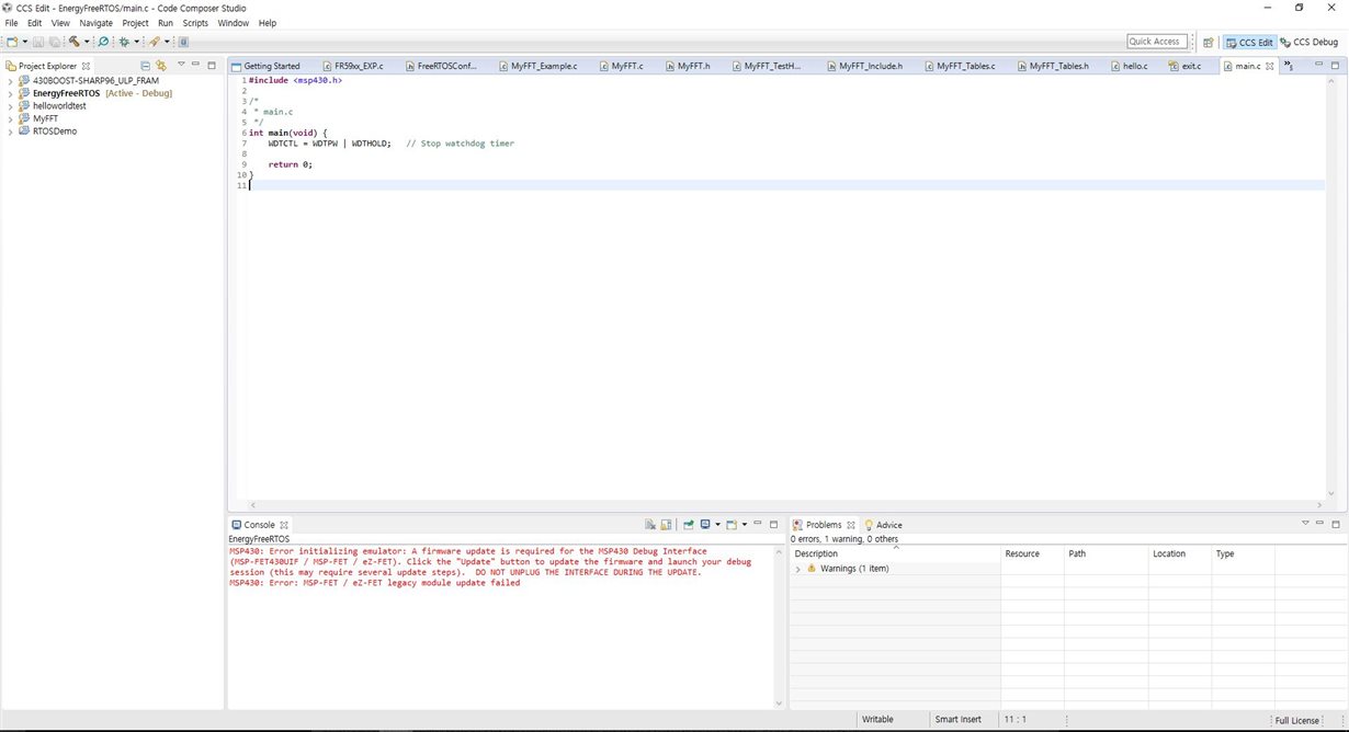

    I followed up the steps you gave with CCSv7.2.0 but it is still not working.
    There is no window pop-up asking if I'd like to update the firmware on your MSP-FET.
    So I checked with CCSv6.1.1, the window pop-up came out but when I clicked update "Hardware State is unknown" error message showed up.
    I tried several times and the other error message came out.
    Mirae

  • Hello Mirae,
    Thank you for letting me know. Looking more closely at your initial screenshot, I noticed that you're trying to write to RAM instead of FRAM. I suspect that you're using a modified linker command file (typically ends with extension '.cmd') in your project.
    Regardless, it sounds like you're now able to load the program which is good to hear!
    James
    MSP Customer Applications
  • It was not a problem of writing on SRAM.
    I have tried with unchanged version of linker command file but it did not work.
    I really appreciate for your help.
    Mirae
