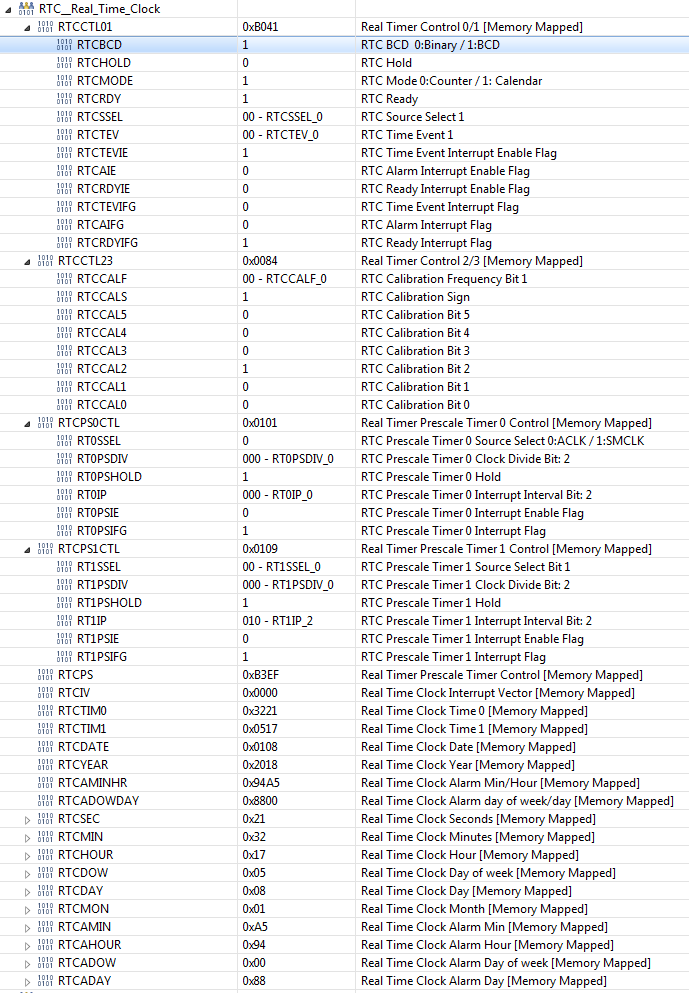

  • Nick,
    As the systems owner is being contacted for this matter, their initial concern was to make sure that the RTCALS bit is being set to 1. This was the first question because in your initial E2E post, you stated that RTCALS is set to 0. I am thinking that was just a typo in the initial post but I want to be certain.
    Matt
  • Good catch.  That was a typo. RTCALS is set to 1.    Complete register below:
  • Nick,
    Thanks for the clarification! The next question is whether you are using the RTC in Binary (hexadecimal) code mode or in Binary coded decimal (BCD) mode?
    Matt Calvo
  •  BCD.  Here is the entire RTC set of registers (trying to get ahead of the questions).
