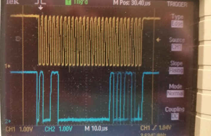

MSP430FR5994: I2C unable to receive from slave
Part Number: MSP430FR5994
Other Parts Discussed in Thread: MSP430FR2311
I2C unable to receive from slave MSP430FR5994
The transmit part of this test code (commented out) works ok and sends data correctly to the slave.  But the receive part (shown) is not able
to receive anything from the slave.  Scope waveform shows just a short positive pulse on the i2c data line and the clock line remains solid high.
During initialization:
UCB1CTLW0 comes out 0x680.  Thus UCMST (0x800) is not set and UCTR (0x10) is not set in transmit mode.
When running receive only one byte, only get a short pulse on data line with clk staying high,
So it is not sending the slave address on receive.  ConfigI2C() is still called prior to running the Testi2c() program, but is now redundant.

  • Hi John
    Two things you can check first:
    1. The SDA and SCL is pull up
    2. Can you get the ACK from the slave?
    By the way what' s the slave device?
    Best regards
    Gary
  • Great to hear from you, Gary:
    Yes this time I do have pullups on scl and sda(10k). Its running at clock speed of 400khz.
    The ack should work from the slave as it works correctly when sending data to the slave. Do get ack from slave when
    Writing to the slave.
    Even if the slave is dead the slave address should be sent by the uProc, shouldn’t it?
    The part is AD5259.
    John
  • Hi John
    I think you add the stop between the write to the reading register and the read data like below
    You should repeat start without the stop when you send the instruction byte. It is very similar with the SMBus communication.
    Best regards
    Gary
  • Gary:
       Here is a waveform of transmit to the slave unit.  You can see the ack and the data going across.
  • Hi John
    Can't see your picture.
  • Sorry Gary
    But I must not know how to send the repeat start when sending the instruction byte
    because I thought the software automatically sends the instruction byte after the slave adx byte.
    When i do the second half doesn't the receive software also send a (repeat) start, adx byte, and then read back the data?
    Don't think the waveform got to the post. I just took a pict and emailed it to myself and cut and pasted it.
    John

  • Hi John
    I have receive the picture in my email box. Do you have a Logic analyzer?It is very hard to count the wave on a oscilloscope.
    Gary
  • Gary:
    Also know its writing to the part because can see the part's potentiometer voltage vary up and down as it is written to.
    John
  • Hi John
    You can refer to the code that I sent to you first. If you can't solve the problem. I will help you next Monday, have a good weekend!
  • > UCB1CTLW0 = UCTXSTT; //I2c Read slave data, start condition
    Typo alert: Try:
    > UCB1CTLW0 |= UCTXSTT; //I2c Read slave data, start condition
  • Thanks, Bruce:
         I corrected the typo and still no i2c waveforms visible on scope during read test.
    Still wondering about the initialization code:
               UCB1CTLW0 |= UCMODE_3 | UCMST | UCSSEL__SMCLK; // I2C master mode, SMCLK
     executing this results in UCB1CTLW0 = 0x680 which is the default value.
    It should be 0xE80 !
    John

  • The unit doesn't emit clock pulses during read, so there is probably something dumb wrong with my setup. One thing is that does happen is that
    UCMST doesn't get set in UCB1CTLW0 during init.
    A logic analyzer won't help clock pulses come out and we can count pulses on a scope.
    John
  • UCMST gets set when I do it. UCB1CTLW0 starts out at 0x01C1 [per SLAU367M Fig 26-17] and ends up at 0x0FC0.
  • Hi John
    Which code you are test? Have you change the slave address and the sent data in the sent data buffer? You mean the write is correct ?
  • Add more information
    1. I used the eUSCI 0 in the configuration; 2.Can you check the UCBxCTLW1 value for me?
  • Hi John
    Make sure the UCASTPx bit is 00. And you set the UCTXSTP bit to generate the stop in ISR (you can refer to test code I have sent to you) .
