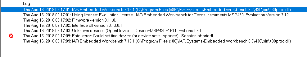

I have setup the debugger with the workbench, it does connect to my computer, there is power as well.
When i try to downoad and debug, it gives me an error saying:
Fatal error: Device not found (or device not supported)
I am not sure what the problem here is, please help.

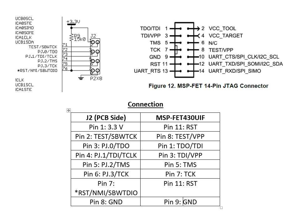

  • Thank you for the quick reply. I am only using the MSP-FET430UIF because I have inherited the project from back in 2009 and want to compile it on the device which was fabricated back then too.
    The MCU on the device is M430F5418A, I have that selected in the target device. The following connections is what I have made to connect to the target device:
    Let me know if you see something wrong with this pin connections.
    Also, do I need to externally power this device? If I am not mistaken, the 430 series is low power and the MSP-FET430UIF should be able to power it ? Please let me know if I am mistaken.
    Here is the log from IAR:
    Please let me know if I am doing something wrong.
    Rajan Joshi
    EDIT: the Log screenshot shows a different device since I was experimenting with different devices. I have made the change to the correct device, and the problem still pertains.
  • I was able to resolve the issue.
    I had to change the target name and play with some settings in the project options code.
    Thank you for the help Nathan
