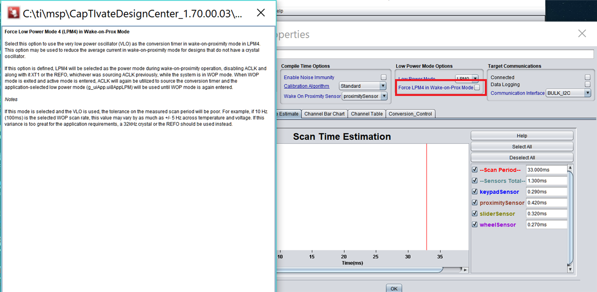

i have completed code and working with sleep mode and ultra low power mode but it automatically wakes up after some fixed time. The aim is to make it wake up only when we touch it but the issue mentioned above happens repeatedly. Therefore asking you to help me with the configuration setting.
