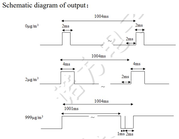

    The total period from R1 to R2 and R3 to R4 should be 1004ms +1%. The F1-R1 and F2-R3 is the duty cycle. Please help with the code and the calculation. Also help with reading the both pins consecutively every 10 secs.
  • 1) There's no "break" between the two TA1CCRx cases in the ISR, so a CCR1 interrupt always thinks there's a CCR2 interrupt as well.
    2) You probably want "%u"  rather than "%d" in the printf formats
    But the real problem is:
    3) With SMCLK=8MHz and ID=0, you can only time up to 64K/8= ~8msec. Your longest pulse (and period) is about 125 times that, so the timer is wrapping back to 0 (repeatedly). Even with SMCLK=1MHz and ID=3 you only get 500+ms.
    The simplest solution is to install a 32kHz crystal and use ACLK instead of SMCLK. That will give you a 2-second timer cycle to work with. (The VLO is probably much too sloppy for this.)
    The pure-software solution -- trying to count timer overflows along with capture -- is harder than it looks. It mostly works fine until some edge arrives near an overflow.
    How precise do your measurements need to be? If counting milliseconds is enough, just make a software millisecond timer (increment a variable every 8000 ticks) and do the "capture" with a GPIO interrupt. [Edit: I think you could actually continue to use the timer (rather than GPIO) for capture -- just ignore the CCR values.]

    1) Do you have any way to independently verify the signal(s) your device is actually sending? A scope would be good, but with such long cycles you could probably contrive something with the Launchpad LEDs. (I always believe data sheets .... until I don't.)
    2) Do you ever see COV set? On the one hand it seems unlikely, on the other hand if you did you might see odd results. It might be worth monitoring with a breakpoint or an LED.
    3) Most of the graphs you showed in the original post look reasonable, except the last (very high measurement), which has that disconcerting spike at the end. Is there any chance you're encountering that case?
    Unrelated: In your earlier post the SensorN[] arrays are much too short (should be more like 40 than 20). I recommend snprintf() rather than sprintf(). And make the arrays bigger as needed.

    The above is from the sensor datasheet. I have not posted any graphs earlier. Please let me what you meant by the graphs in the orginal post.

  • Yes, it's that third graph (999ug)  that was disconcerting -- I suspect that little spike at the end will get in your way eventually. Does the book say at what level that spike appears?
