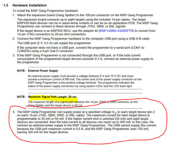

I had asked about programmig 8 MSP devices previously and got introducted to the MSP GANG (thanks!)
I have a followup question.
These products are fairly large, 12” x 12” and I have 8 laid out on a 8’ x 4’ Table.
That said, I need the 14 Conductor ribbon Cables to be much longer in order to reach.
What is the max length that will work?
I am using slower BSL Mode, so this may help increase length. Thanks!
