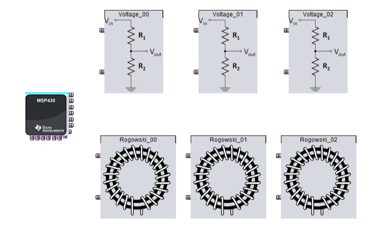

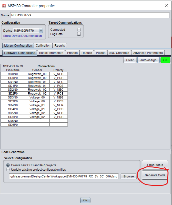

    The bought chip is empty, you need to program it. Normally, you can create the code by after setup your system in Emergy Measurement Design Center:
    Actually, you can't find the MSP430F67771A , you can refer to this FAQ: [FAQ] MSP-EM-DESIGN-CENTER: Why isn't my MSP430 part number listed?

    See from the designer center. You can only test the current.
    But see from the document EVM430-F6779(Three-phase Meter : Class 0.2 Accuracy), it test 4 current.  please give me some time to consult our expert about the difference. You can ask Carlo for my e-mail.

    EMDC can support measuring neutral current. For this, another current sensor can be added in EMDC to the seventh ADC channel of the F6779 device.
    Neutral current measuring (also called monitoring) allows you to detect tampering and can indicate unbalanced loads in the system. Ideally, no current should flow through the neutral connection if the loads are perfectly balanced. However, a small amount of current will probably flow in the real world. Higher amounts would flow when tampering has occurred.
