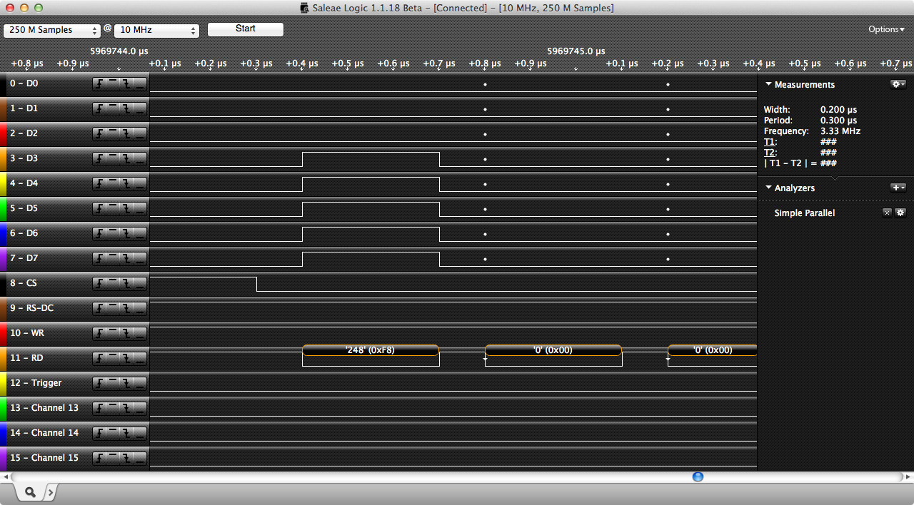

    What pins are the LCD signals connected to?  You mention port B, the scope traces are named port D and the code refers to port H.  Can you post your actual configuration code for the pins that the LCD signals are connected to?
    Sue

    The D-ports on the logic analysers are connected to the LCD_DATAH_PERIPH = SYSCTL_PERIPH_GPIOB port.
    Output is
    Kentec 7" screen
    800x480
    1:0
    2:0
    3:0
    4:0
    5:0
    0

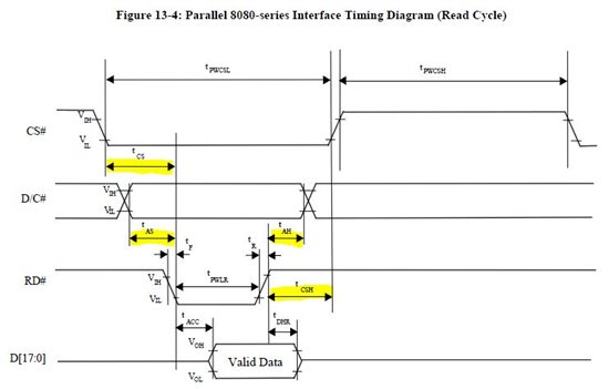

  • Hi Rei,
    Thanks for the additional information.  When you say that the Tiva MCU does not get the value of 0xf8, What does the MCU read?
    It appears from the logic analyzer tracing that the read signal goes high at the same time the data goes away.  I'm not familiar with the timings on the Kentec display, but is it possible that the read signal should go high before the data goes away?  Maybe:
        // Assert the read enable signal. x10 = 200 ns

  • Thank you for your message. I tried the new approach, reading the value twice. Unfortunately, result is still 0.
    Kentec 7" screen
    800x480
    1:0
    1*:0
    2:0
    2*:0
    3:0
    3*:0
    4:0
    4*:0
    5:0
    5*:0
    0
    Is the GPIO port correctly configured?

  • Perhaps this adds insight/clarity... this the, "Read Timing Diagram (8080 ver) from the datasheet you provided:
    By my read - "Read Data" is Valid (Tacc {32nS min}) post the fall of RD - and remains valid only (Tdhr {1nS min!}) post RD's rise.  Thus - my belief is that you/others have, "no chance" to read valid data - if keying upon RD signal rise...  The cascade of "reads" seems inefficient/misguided - ARM MCUs are superbly equipped w/multiple timers - one of those is sure to be able to accommodate the 32nS min sought by Tacc.  (setting timer to one-shot - 35nS for safety - and commence your read upon the one-shot's expiration)  A single read should suffice - so long as that read occurs w/in the "safety" of post Tacc and pre RD's rise.  Your driving RD low for a read confirms that you've config'ed SSD for 8080 rather than 6800 mode.  (one hopes)  WR must be ordered high - and remain such - throughout this read process.  And - you cannot toggle CS, D/C, & RD via a single instruction (CS & RD for sure - D/C may allow - but not worth the risk.)  {this reporter now surfaces for a breath...}
    Suggest that you temporarily, "break" all connections - your MCU and the Lcd.  Devise some simple means to "load the data bus (pull-up Rs come to mind - and 0x55 or 0xAA work nicely to identify bus shorts/opens) and then exercise your "read code" and see if you can recover that, "pull-up created data" introduced upon your Port B.  (i.e. no proof exists that you can successfully read - that port @ this time)  KISS always guides/assists - and a systematic method seems very much needed here...
    Look again - SSD Timing chart under Read: may suggest that only one data byte per CS cycle may be extracted!  Note that CS toggles after the singular Read - multiple strobes upon RD may disorder the SSDxxxx.  (SWAG on display here)
    Long past we've used that SSD - but in its 16b mode - which better speeds all transactions w/the display. (and it's hoped - 16b will sooner rather than later - replace the 8b port limit created by LMI...and allowed to continue on all but external bus devices)  Other ARMs - even w/out ext. bus - support 16b I/O via single instruction...
    While you note your, "surprise re: absence of pixel reads" - never are we told if pixel "writes" succeed.  That fact has some value - should be included...
    One final "note" (best - saved for last) - it is possible that dreaded, "bus contention" occurred - and that your MCU came under attack.  Recall that you likely first place Port B into output mode.  Once so configured - even in the absence of your MCU's "write strobe" - should the SSD "RD" line drive low - while CS is asserted - both your MCU and the SSD may output - and contend!  Never good!   In our experience these MCUs are nicely robust - but you should check repeatedly and take care to prevent such unwanted, potentially damaging, "mis-operation."
  • According to Kentec, it is a hardware issue due to the BoosterPack:
    The PCB of EB-LM4F120-L35 is using the 8-bit interface for SSD2119,
    It connect the higher 8-bit data line (DB15~DB8) to the lower 8-bit data (DB7~DB0) line,
    It’s no problem for SSD2119 but not prefer for SSD1963 (from the SSD1963 datasheet, the  ”Pins not used should be floating”).
    You might need to cut the “DB15~DB8” on the PCB (connected to the 60pin LCD connector, Pin 32 to Pin 41).
  • Hi Rei,
    Today I opened the data sheet of SSD1963 and surprisingly, the pixels can be read by read_memory_start command (0x2E) followed by read_memory_continue command (0x3E) , provided you previously set the column and page. More, your command 0xF8 is not listed by the data sheet. Does this comes from the other display?
    One more thing: it seems that reading process is/has timing constraints - you can do it only in intervals when the display is not busy, so setting tear on should be provided. Consequently, the signls CS, RD must be short -and in these cases using two serial writes is inapropriate for the purpose.
    Petrei
  • Tahnk you for your answer.
    The 0xf8 is actually the correct value sent by the screen as part of the 24-bit colour 0xf8 0x00 0x00 = red.
    I use SSD1963_SET_COLUMN_ADDRESS, SSD1963_SET_PAGE_ADDRESS and SSD1963_READ_MEMORY_START before reading. It is the same logic that for the SSD2119-based 3.5" display.
    I'm going to investigate the timing constraints more closely.

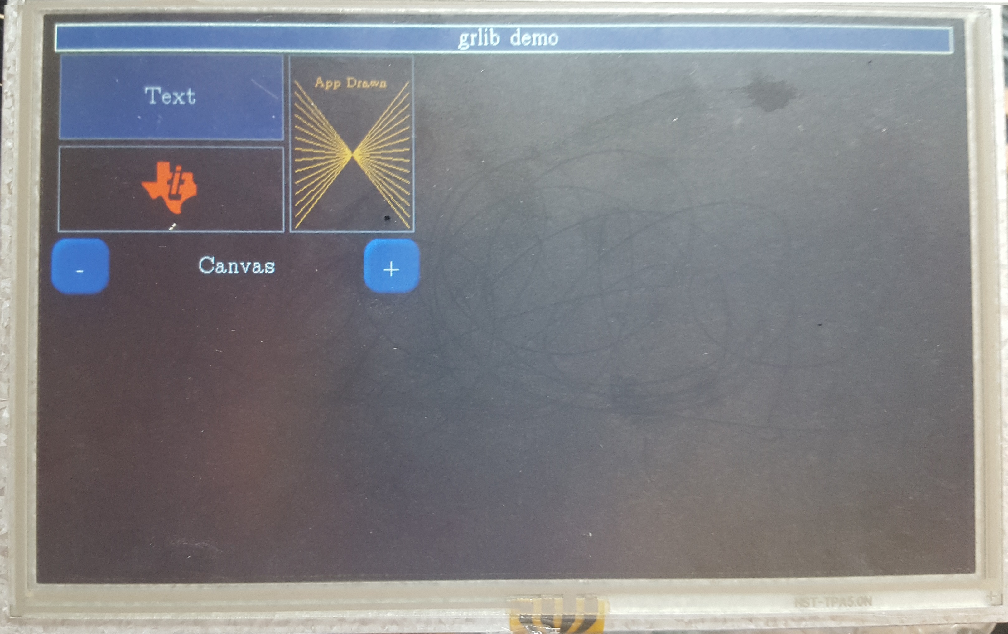

    Here is what I have loaded on the 5" right now.  The buttons work but the touchscreen portion seems to have spread out the widgets to where they should be relative to the 3.5".  So in this screen below the button is drawn at 270x190 and is 40x40 pixels.  But to press the button I have to touch the screen in the lower right hand corner.  This seems to be the same relative location that it was for the smaller 3.5" screen.
    Any ideas on what needs scaling?  I'm pretty sure the problem is in the 'touch.c' file but can't exactly tell where.
