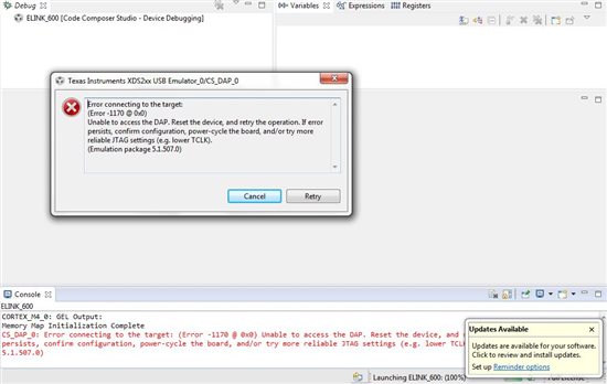

TM4C1294NCPDT JTAG Error- Unable to access DAP
Other Parts Discussed in Thread: TM4C1294NCPDT, UNIFLASH, LMFLASHPROGRAMMER, EK-TM4C1294XL
I'm unable to program TM4C1294NCPDT on a custom board using XDS200 USB emulator. I continue to get error- 1170 @ 0x0 whenever I try to program the microcontroller. I have verified that the JTAG connection is correct - scroll down to see snapshot.
The JTAG scan test that I did came back without any error - see attached txt file. I don't really know to what extent to interpret the result. Not sure if it also indicates that the microcontroller is still functioning.
I thought I may have inadvertently locked up the JTAG port. So I decided to use Uniflash to unlock the port. This does not resolve the issue even though it showed a message that the process was successful.
I'm open to any suggestion or ideas at this point.

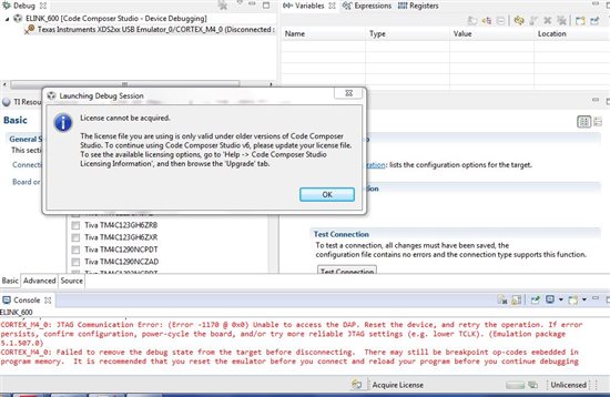

  • Amit,
    I had no luck unlocking the first board using LMFlashProgrammer with Stellaris ICDI. Tried multiple times but still got the same error.
    I was able to get my hands on a new board to program using Code Composer Studio 6 (CCS6).CCS6 appeared to have partially of fully programmed the board before giving an error shown in the screen shot below (It only shows this error on a new board).
    This appears to be a bug because my software is fully licensed. The same thing happened in the case of the first board. The second board started behaving the same way as the first board.
    It appears as if Code Composer Studio 6 is putting the microcontroller in a state that makes it unresponsive.
    First Error Screen Shot:
    Subsequent Error Screen Shot:

  • Caner,
    I have not been able to program a board. The first attempt to program a new board appears to be going smoothly until CCS6 throws an error due to licensing issues - see screen shot in posts above. Subsequent attempts gives the "Unable to access DAP" error.

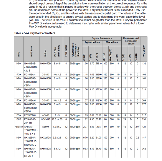

  • Okay now I have found your problem.
    There is a 2k resistor between your 25MHz crystal and the OSC1 pin. That should not be there. Just remove it and directly connect to OSC1 pin. In here: http://www.ti.com/general/docs/lit/getliterature.tsp?baseLiteratureNumber=spmu360&fileType=pdf
     it is 0 ohm resistor.

  • Caner,
    I'd have to disagree with you on setting the 2K  resistor to 0. There are recommended values for this resistor and it varies based on the manufacturer of the crystal - see snapshot below. You can get more information on Page 1840 of the datasheet:
    http://www.ti.com/lit/ds/symlink/tm4c1294ncpdt.pdf
    The document you referenced belongs to a different chip. The correct document is:
    http://www.ti.com/lit/ug/spmu365a/spmu365a.pdf
    The good thing about your observation was that I discovered that the value of the resistor that I should have used is 2.5K. I must have misread that section when I was doing the design of the board.

  • @Akın:
    Sorry that I was looking to wrong pdf. Your design seems exactly like the EK so I think it is okay.
