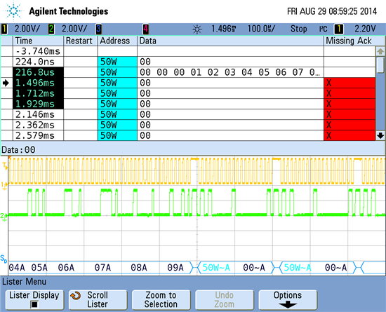

  • Hi!
    ive new I2C challange in front of me. We are trying to simulate i2c slave device (EEPROM) with our TM4C123GH6PZ uP.
    weve implemented complete state machine simulating behavior of EEPROM, but i dont know how to implement waiting time of EEPROM, when it is writing data from buffer to actual EEPROM (its about 3 - 4 ms). Exactly problem is how to force slave NOT to send ACK after last byte written to it. I guess i need something like "disable" that particular slave for that period of time. Is there any function in i2c.h? The slave is on I2C0 primar.
    For better understanding i enclose scope screen displaying behaviour of real EEPROM we need to simulate.
    Cheers
    Jan
    EDIT: I can achieve that with I2CSlaveDisable(uint32_t ui32Base); and after period of time again I2CSlaveEnable(uint32_t ui32Base); ? But this will cause enable/disable whole I2C device. Both primar and secundar slave right? Thats undesirable ... i need to disable only one of them so the second can run.
  • Hello Jan,
    if you are using I2C of TM4C device as a slave then you have to use the I2CSACKCTL register which can be used by the Slave to control response of received frames from a Master.

    i am wondering, if that particular I2CSACKCTL settings is applied (using I2CSlaveACKOverride(I2C0_BASE, false);) will works for both slaves on I2C0 bus (we are using primary and secondary slave). For us would be the best, if we could disable only one of those (primar or secundar) at the same time (so the other slave could further generate ACK).
    I hope you understand what i mean.
    Jan
  • Hello Jan,
    I think you are referring to SOAR and SOAR2 registers as primary and secondary slave's. If that is the case then I believe the control will assert for both the addresses. However by making sure that after the affected slave operation is done, the I2CSACKCTL register be returned to the default value
    Amit
    so iam still trying to control ACK/NACK of my slave, but still no results. Non of the combinations of I2CSlaveACKOverride(I2C0_BASE, 1/0); and I2CSlaveACKValueSet(I2C0_BASE, 1/0); is making desired result.
    I thought that i should call I2CSlaveACKOverride(I2C0_BASE, 0); in initialization and then at palce i need to make NACK answer call I2CSlaveACKValueSet(I2C0_BASE, 1); and after i want again send ACKs i should call I2CSlaveACKValueSet(I2C0_BASE, 1); ?
    That approach unfortunately doesnt work ... Communication just stuck after calling I2CSlaveACKValueSet(I2C0_BASE, 1);, but properly it should send NACK after each byte send from master.
    Best regards
    Jan
  • Hello Jan,
    Are you trying to NACK during the address phase of the I2C Transaction or the Data Phase of the Transaction?
    Amit
  • My goal is to NACK after series of bytes are transmitted to my slave, so when master will try to communicate after that long frame is sent, he will get NACK.
    So i guess iam setting NACK when communication is IDLE (after that frame sent, after stop). Look at the picture (thats how actual EEPROM is behaving after write), after that long frame is sent, master is polling by sending 50W 00, if no ACK is present, he just asks over and over again till there is ACK and he continues transmission.
    Pitty that i cant find any examples describing that Slave ACK handling ...
  • Hello Jan,
    So in this case you want to NAK from Slave after receiving 0x08 data. If my interpretation is correct then you need to first call the function I2CSlaveACKOverride(I2C0_BASE,true). After getting the byte I2CSlaveACKValueSet(I2C0_BASE,false) must be called. On getting the Stop condition (based on the I2CSRIS Status bit)
    I2CSlaveACKOverride(I2C0_BASE,false);
    I2CSlaveACKValueSet(I2C0_BASE,true);
    must be called.
    If you attach the code you have or Slave, we can have a look into why it is not working: or what would happen
    Amit
  • So i think ive found solution in disabling whole I2C channel. That results in desired behavior - so this way we will be able to simulate EEPROM behavior (EEPROM write delay).
    Iam going to take a vacasion for rest of the week. When i come back and ill solve that, ill put there final solution for others
    cheers
    Jan
