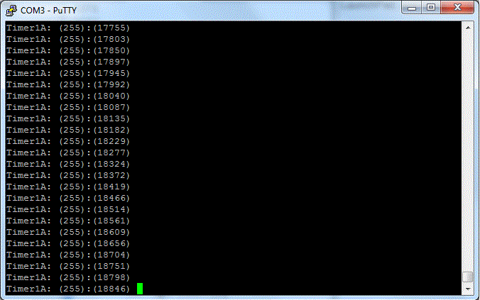

  • I tried to force the counter to 16-bit based on my reading of page 976, but the result is the same, no prescaler, neither real prescaler nor extension when overflow
    Output:

  • Hello David
    For 16-bit mode it is
    TimerConfigure(TIMER1_BASE, (TIMER_CFG_SPLIT_PAIR|TIMER_CFG_A_CAP_COUNT_UP));
    instead of
    TimerConfigure(TIMER1_BASE, TIMER_CFG_A_CAP_COUNT_UP);
    Amit
  • Tried it, the result is the same.
    Prescaler has no effect, and it doesn't serve as extension either (I read val2 =HWREG(TIMER1_BASE+0x38);)
    TIMER_CFG_SPLIT_PAIR = 4, so I got a feeling it is the same as my previous test with HWREG(TIMER1_BASE)=4

  • Hello David,
    I made some code changes and now it works. In the data sheet the conditions for the timer in up count is mentioned as GPTMTnILR > GPTMTnMATCHR and GPTMTnPR > GPTMTnPMR.
    Also the read has to be done in the same register as TimerValueGet namely GPTMTnR
