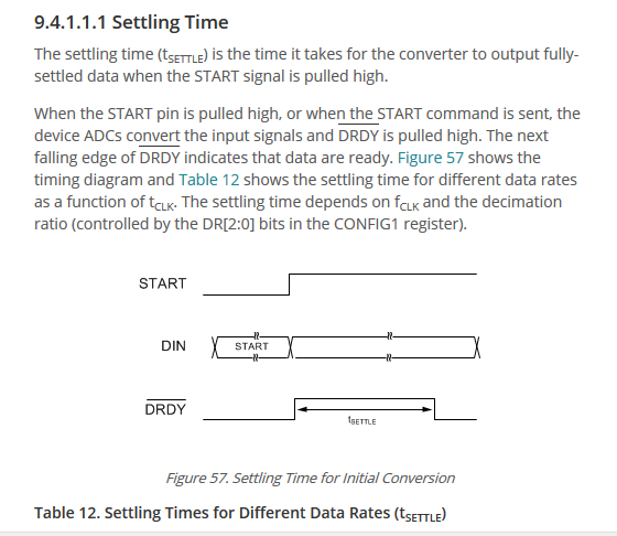

  • It sounds like you are reading the  ADS1298 too soon. Are you checking for !DRDY to go high and then to go low again before reading the data? You may want to compare the SSICLK to !DRDY on your scope.
  • I set the bdataReady true in a GPIO interrupt that is triggered in the falling edge, and is connected to the DRDY pin of the ADS1298. This flag starts the read and in the end I send another START command to make another conversion.
    Seeing the signals in the oscilloscope I realize that the falling edge of DRDY and the SPI signals doesn't match as it should, let me analize that part, maybe you are right.

  • This looks more like a ADS1298 issue than a TM4C issue. I am pushing this thread to the precision A2D experts.
  • When I was about to write the post I was thinking in publish it to the Precission converters forum but in the oscilloscope I saw that the zero doesn't come in the signals so I guess it was a TM4C issue.
  • But in the logic analyzer, it shows the first byte from the slave (ADS1298) as 0x00, the second byte as 0xC0. What the master is putting out is 0x12 then 0x00.
  • The 0x12 corresponds to the RDATA command, and the 0x00 beneath that command it should be read by the flush received FIFO
    while(SSIDataGetNonBlocking(SSI2_BASE, &ui32FlushFIFO));
    Immediately after, the ADS responds with the 3 status byte and the result from the conversion.
    There are ways to work around this situation but it bothers me, it shouldn't happen
