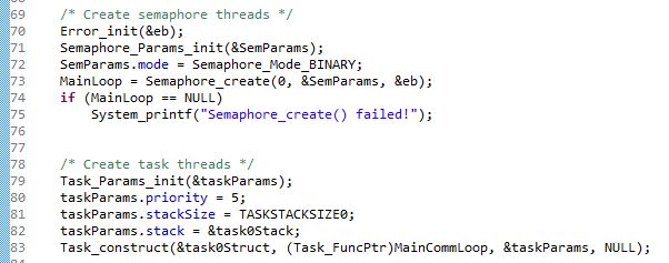

I'm using a Launchpad TM4C1294 board to develop Modbus/TCP communication with the help of TI-RTOS and NDK.  The application works very well at the beginning.  The board is communicating well with my PC host interface and proper modbus formatted messages are being exchanged with my LabVIEW interface.  The semaphore is being posted and pending works well.  My code uses the NDK recv() function inside my user created ModbusServer() function.  recv() is set to non-blocking.
Unfortunately after about 30 seconds of data transmission, the semaphore_pend() no longer seems to respond.   I know that semaphore_post() is still working as I can see the count at 1 and the debugger still responds to breakpoints in the semaphore_post() contained function.

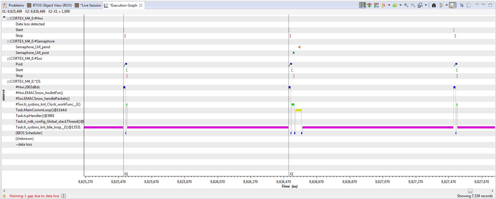

My debugging capability is evolving as I'm new to RTOS.  I haven't noticed any unusual stack issues for the tasks in ROV.  My execution graph works as expected up until the point of the lost semaphore_pend() at which time I can't graph any new events.  I'm using an LED on the board to help me determine that the semaphore_pend() is blocking.  When I halt the code after the Semaphore_pend() fails, I often find the code in Clock_workFuncDynamic() in the file "clock.c" with the exception when servicing clock0 which successfully calls MainLoopTrigger and appears to post the Semaphore.

When Semaphore_pend() no longer seems to respond, the program appears to stay within Clock_workFuncDynamic() in the file "clock.c" except when servicing clock0 which successfully calls MainLoopTrigger.

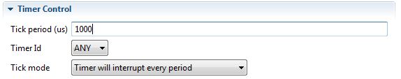

  • I continue to learn more about this problem.  In my search through the forums, I found a post on Debugging Queue and Semaphore that helped me focus on the timer controller.  I changed the tick mode from "unnecessary timer ticks will be suppressed" to "timer will interrupt every period".  I also updated the tick period to 1,000us and changed the clock0 period to 25 to maintain my desired 25ms semaphore servicing.  This improved my performance dramatically.  Since I'm new to RTOS, I'm not sure if I'm causing myself any future headache to this further down the line.  Will this scale well?  Can anyone offer advice?  Is it better to have clock0 period to be 1 and the tick period at 25,000us?

  • Thank you Alan and Charles for your help and recommendations!  Here is what I have in the cfg file now:
    Clock.tickPeriod = 1000;
    var clock2Params = new Clock.Params();
    clock2Params.instance.name = "clock0";
    clock2Params.startFlag = true;
    clock2Params.period = 25;
    clock2Params.arg = null;
    Program.global.clock0 = Clock.create("&MainLoopTrigger", 1, clock2Params);
    Previously my Clock.tickPeriod was set 25,000 and my clock2Params.period was 1.  This original Clock.tickPeriod setting was the source of my problem and should be set to 1000 as you suggested. This seems to be working well now.  I really appreciate your time and expertise to help me resolve this problem.  Thank you!
