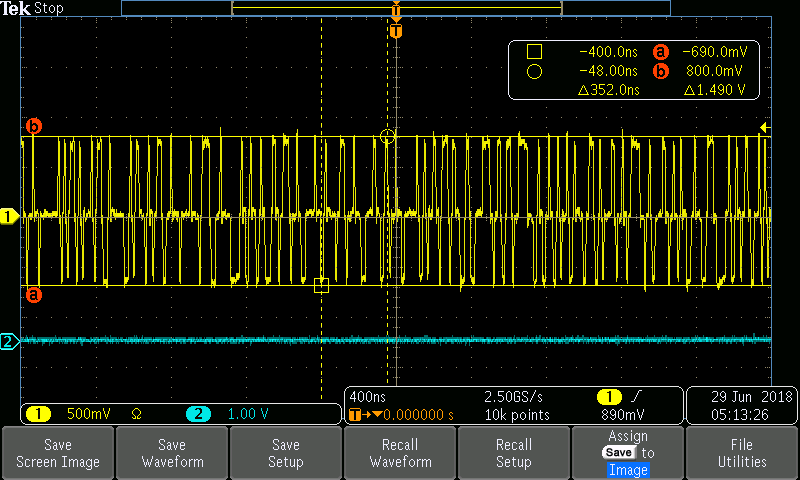

    i am also facing the issue of Ethernet link establishment. The link OK LED is not glowing. When i checked the normal link pulses(NLP) of auto negotiation at EN0TXO_P and N0TXO_N, i found out that they are not coming properly (I compared them with launch pad kit). Can you please cross verify this issue with your faulty boards??

  • How did you verify the pulses?  Oscilloscope.  My problem is the pulses are getting degraded in amplitude.  Do you have any pictures of your capture.

  • hi,
                 Yes i am using tektronics scope to verify pulses.
              As a company policy i can not upload photos of degraded signal right now. But i will try to find a way to upload photos.
               After studying  few documents i found out that Rbais resistor affects the voltage levels of differential Tx lines. So it may be one of the cause for degraded pulses. Please verify

  • Digvay,
    I used an oscilloscope to verify.  The boards were all good at one time but then the signals got degraded.  We are fairly certain that it is ESD as we have taken many boards that were working and were able to damage them by numerous power cycles. I am using 4.87K for rbias.
    Try to measure resistance from 3.3V ethernet termination plane to ground.  Our failing boards measure around 200 ohms where a good board is 7000 ohms.

                         I am also getting resistance of 230 ohm between VCC and GND.  I was able to establish link (malfunctioning) by changing Rbais. But i am facing another problem. The voltage on TX-P and TX-N line is not symmetric. On TX-N line it is giving 1.08 V which is right. But on TX-P line it is giving voltage of 720 mV. They should be same. When i opened tracks by removing component on track and measured resistance with respect to ground it was giving 1K for TX-P and 42K  for TX-N. Can you please verify this with faulty board.  I am planning on populating second card and then testing this issue.
