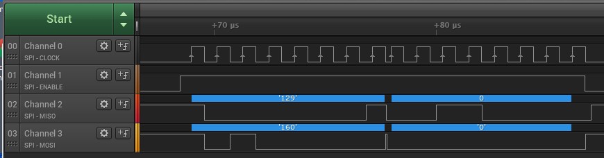

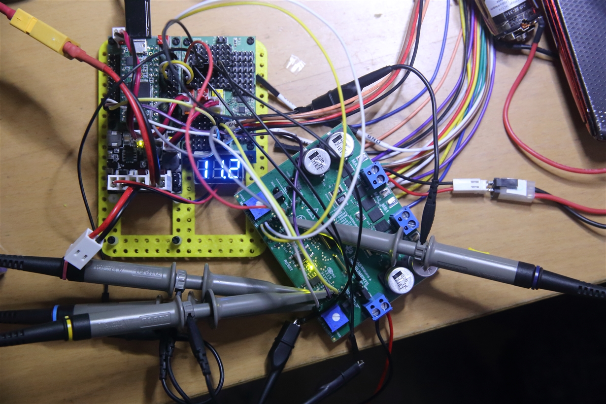

* SPI interface for Motor
* This code controls DRV8704 motor driver. DRV8704 is SPI-compatible, and to command it, you send
* 12 data bits and 1 read/write bit.
* The circuit
* - SCLK: to SCK(ICSP-3) or digital pin 13
* - SDATI: MOSI(ICSP-4) or digital pin 11
* - SCS: 10
* - SDATO: MISO(ICSP-1) or digital pin 12
* created 31 Mar 2017 by Irene Zhang
