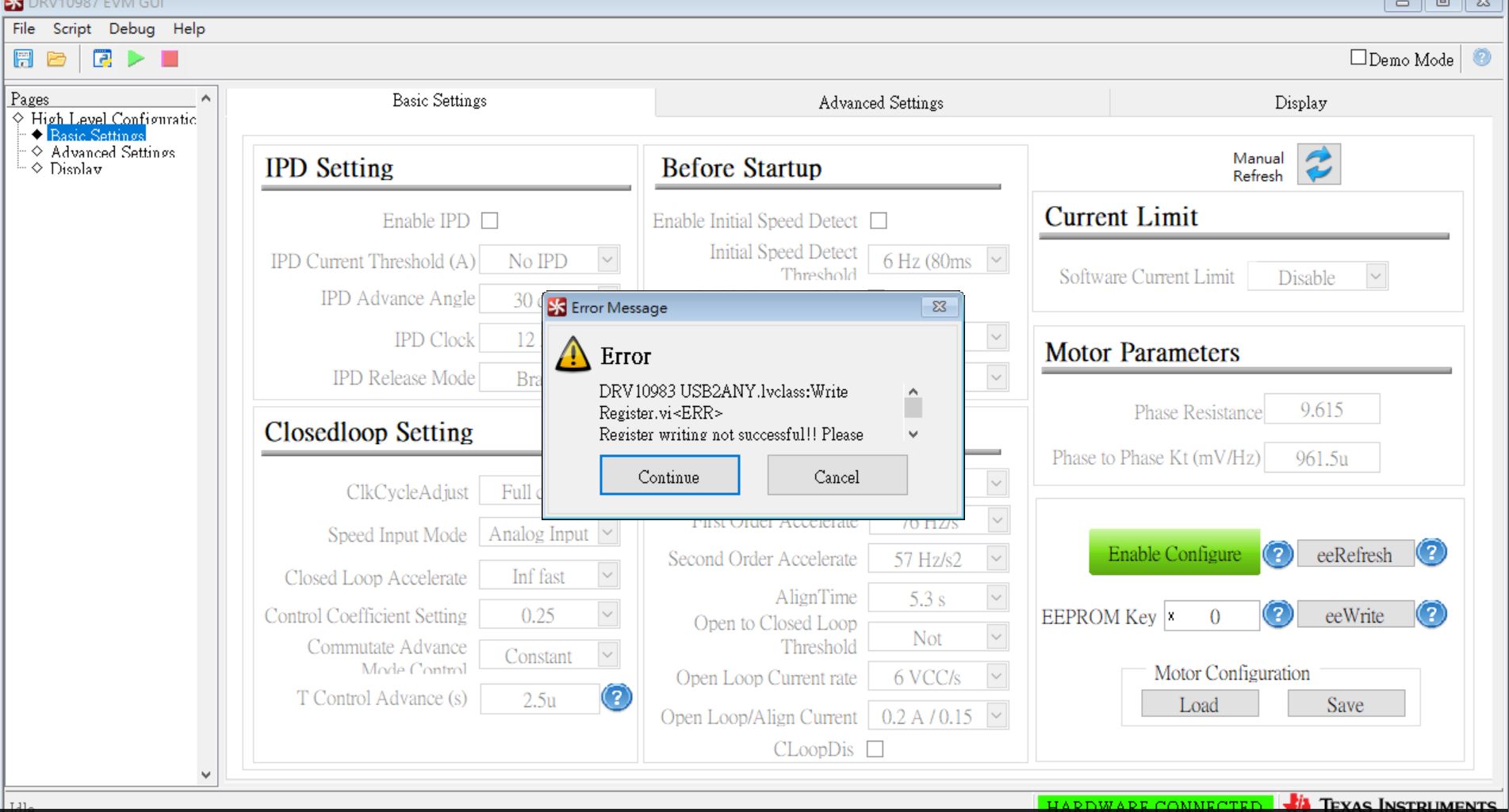

    Now Motor use Runtian ZWL12_22_2.5A.
    BTW I also got some error message as below then how can I solve the issue?
    Thanks.
    Eric

  • Hi Cole,
    Yes, I still got the same error message every time when start up GUI and I also uninstall GUI then re-install again but still got the same message as below.
    Would you have other better suggestion for our check again?
    Thanks.
    Eric

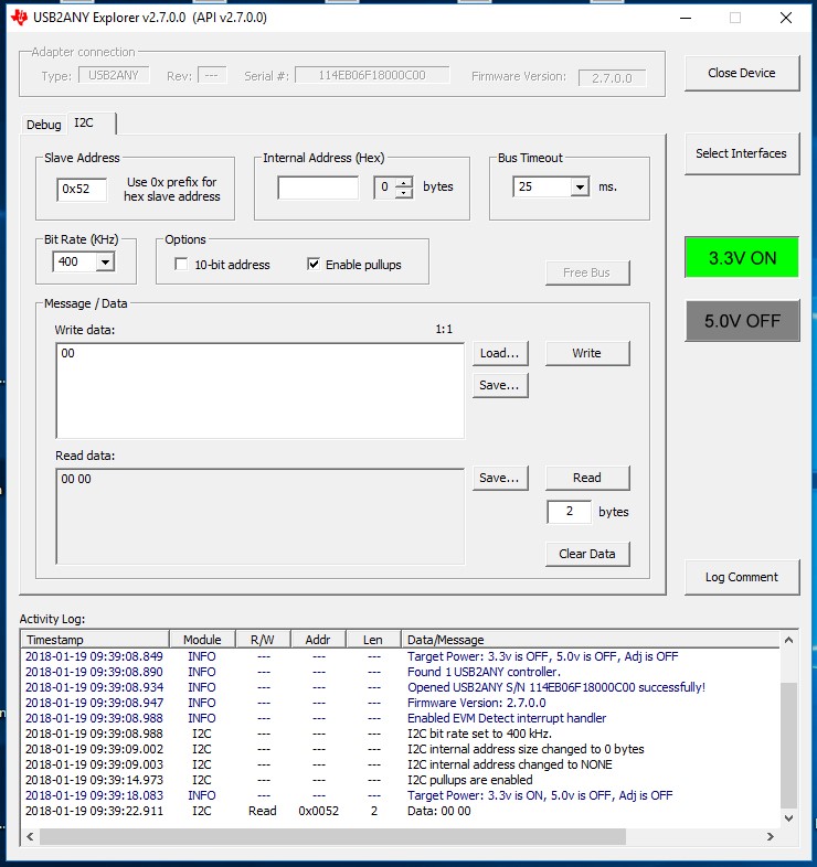

  • Hey Eric,
    After trying to recreate the problem a few different ways on the bench, can you confirm that the USB2ANY Firmware is of 2.7.0.0? You should have gotten an error to update the firmware upon opening the GUI but the firmware could have been updated to the incorrect version.
    You can check by using the USB2ANY Firmware Loader.exe or USB2ANY Explorer.exe found by default in C:\Program Files (x86)\TI USB2ANY SDK\bin.
    Another thing you can check is the markings on the IC and make sure it says DRV10987.

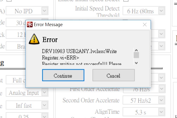

    Also, can you provide a screenshot of the entire GUI window along with the error?
    -Cole
  • Hi Cole,
    The below is our USB2ANY firmware version for your check again. It seem V2.7.0.0 version.
    BTW, the below is full screen error message inculde GUI for your check again and now use OS is WIN10.
    Eric

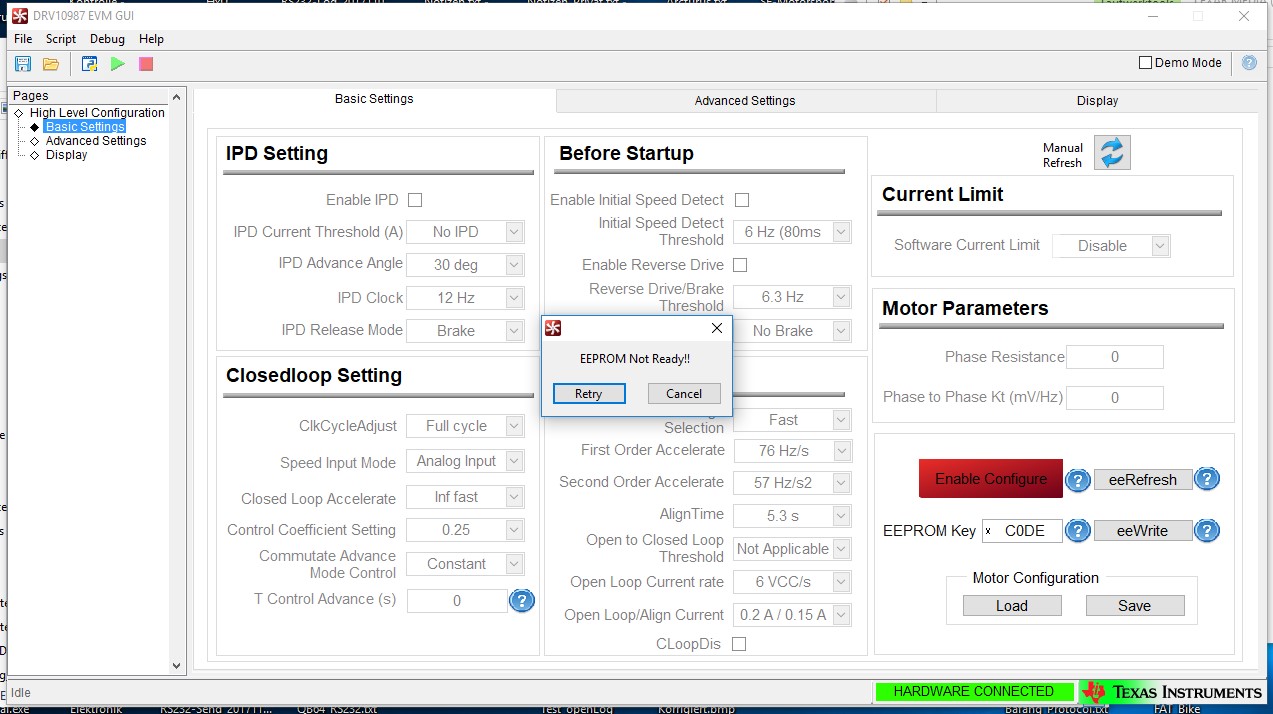

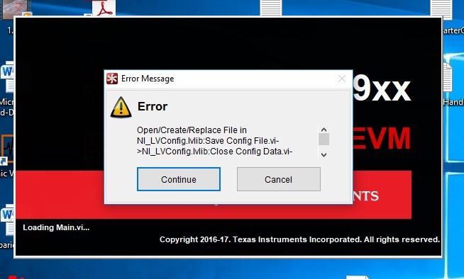

    I have the same problem OS is WIN10 64-bit. I have the same error messages if I want to write parameters to the DRV10987 EEPROM.
    I have a error message if I start the GUI:
    Do you have the same message?
    Ulf
  • Hi Ulf:
    No, this should need to install "LVRTE2014f2std.exe" file from http://www.ni.com/download/labview-run-time-engine-2014/4887/en/
  • Hi Eric,
    I had installed the "LVRTE2014f2std.exe" and also I rebooted the PC before using the GUI.
    I have looked with my scope on the I²C clock and data line everything seem to be normal.
    Ulf

  • Hi Cole,
    I have also trouble with a DRV10987EVM. I use WIN10 64bit.
    At My DRV10987EVM board I can measure VREG = 5.07V, 1P8V = 1.796V, 3P3V = 3.272V.
    If I use the USB2ANY Explorer the I²C Bus seem to be normal:
    Start DRV10987EVM Application on PC:
    Errormessage after click on OK:
    Message before click on eeWrite:
    Errormessage after click on eeWrite:
    Signals on the I²C Bus after click on eeWrite:
    The DRV10987EVM was shipped from Mouser at 11.Jan 2018 and arrived on 15.Jan 2018.
    The DRV10987 delivers the normal voltages, but I can not change any values to optimise the controller for a motor and it make no reaction on a change on the Poti and also no reaction if I use a PWM signal.
    I hope you can help me to identify the problem.
    Ulf

  •  Hi Cole:
    Update information as below for your reference.
    Thanks.
    1. Connect DRV10987EVM as shown in DRV10987EVM User's Guide  --> Yes
    2. Power on DRV10987EVM with appropiate voltage to VCC as shown in device operation range in datasheet  --> Yes
    3. Start DRV109xx GUI (no error)  --> Yes
    4. Select DRV10987  --> Yes
    5. After some loading, click load button, and load a .csv file (no error)  --> Use this file. Please rename *.123 to *.CSVRuntian_ZWL12_22_2p5A.123
    6. File successfully loaded with no error  --> No, got can't load the file message.
    7. Close GUI and restart using steps 3-4 then recieve the error above. Is this correct? --> Yes
    8. If you can double confirm again on WIN10 system?
    Thanks.
    Eric
