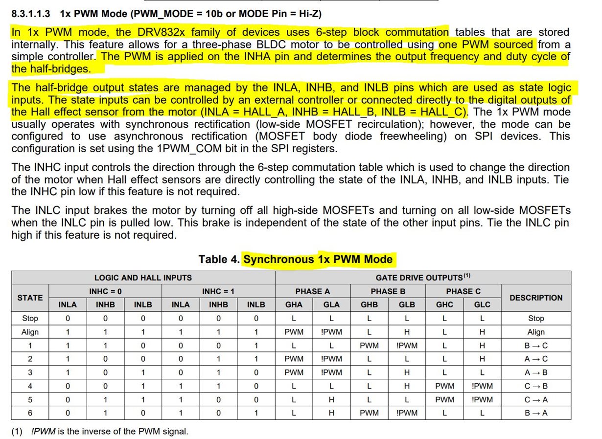

I designed motor driver with DRV8323RH.
1x PWM mode is working.
And 6x PWM mode is working, when I use SVPWM.
But it doesn't working with 6-step commutation.
For example, hall signal is as follows. [Mode is 6xPWM mode]
HallA : high
HallB : high
HallC : low
then, I assigned INLx and INHx signals as follows.
INLA : low, INHA:low
INLB : !PWM, INHB:PWM
INLC : high, INHC:low
I check the INLx and IHLx signals with scope, and it is right.
But, GLx and GHx signal is wrong.
In this case,
GLA : low, GHA : low(--> But GHA shows high )
GLB : PWM, GHB : !PWM
GLC : high, GHC : low
I don't know why GHA is high. What should I check?
