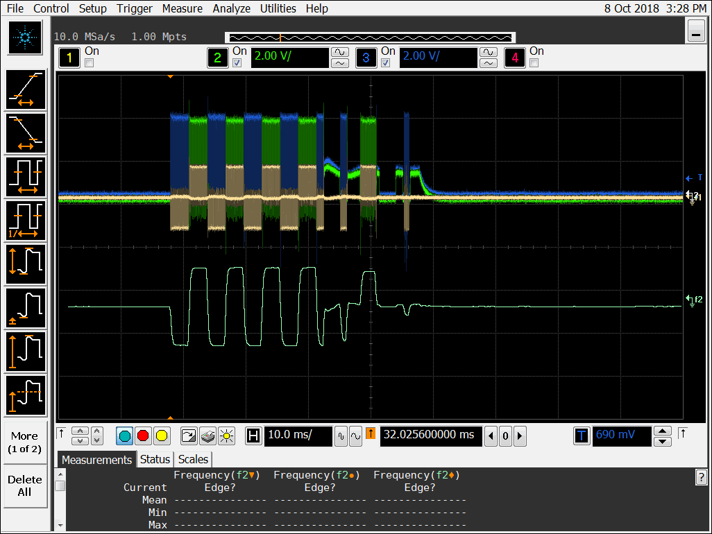

    My question is we're using open loop to drive our vibrator now,and also enable auto-break for breaking.
    1.As I know, when using auto-break,DRV2624 will change to closed loop to break the vibrator, but since we use open loop(170Hz),the break frequency(maybe 160Hz) will not the same with operation frequency, is this will cause any problem like increase the breaking time or some side effect?
    2.What time does DRV2624 need for start-up and breaking?
    3.Attach photo is using the same DRV2624 with same vibrator but the result show the different breaking pattern, is it a normal behavior?

    Yes, at least the first part of the braking looks consistent across the three tests, although there seems to be some small variation at the very end.
    About the auto-break time, that would be the spec, the plots from figure 10 and 11 show around 20ms.

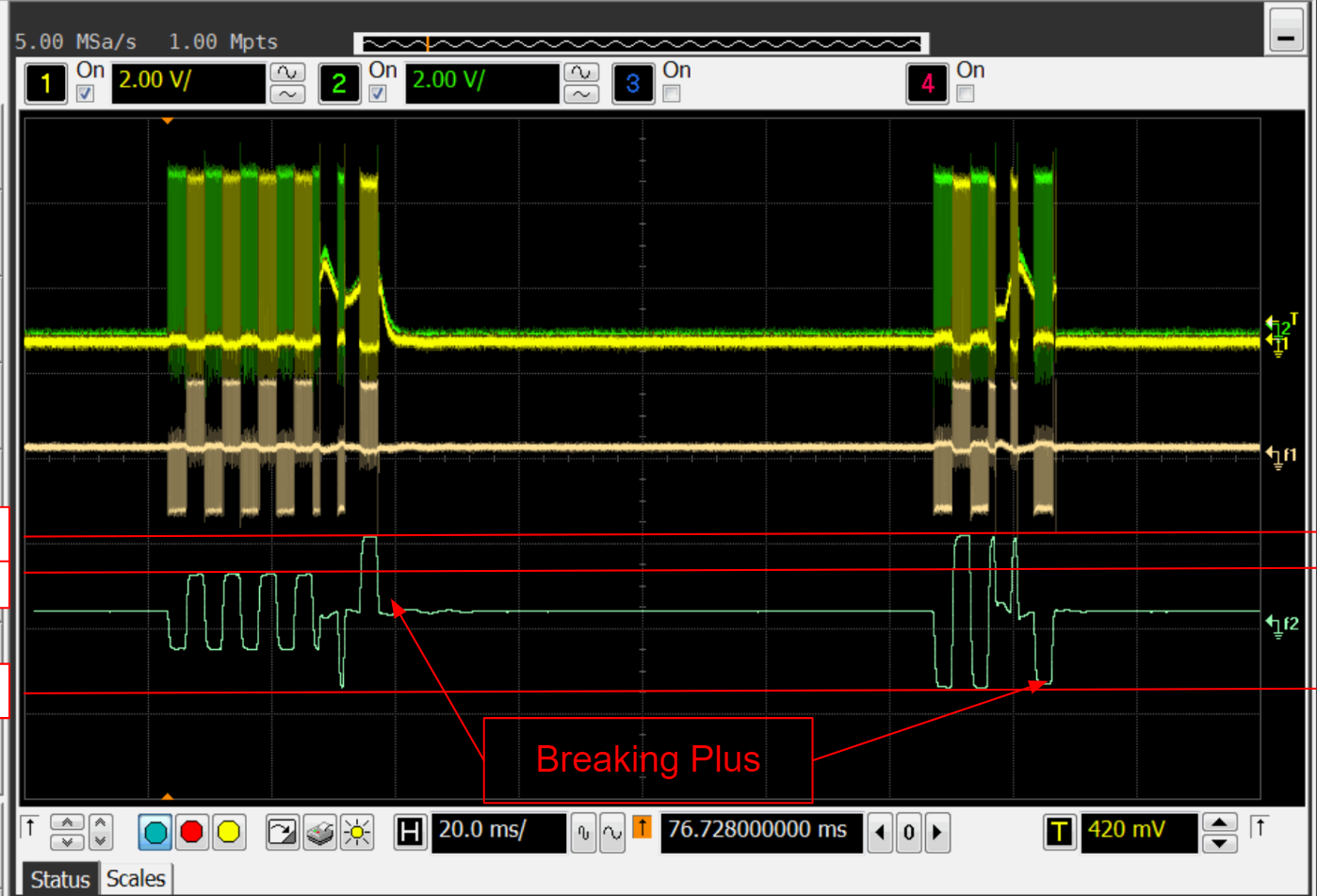

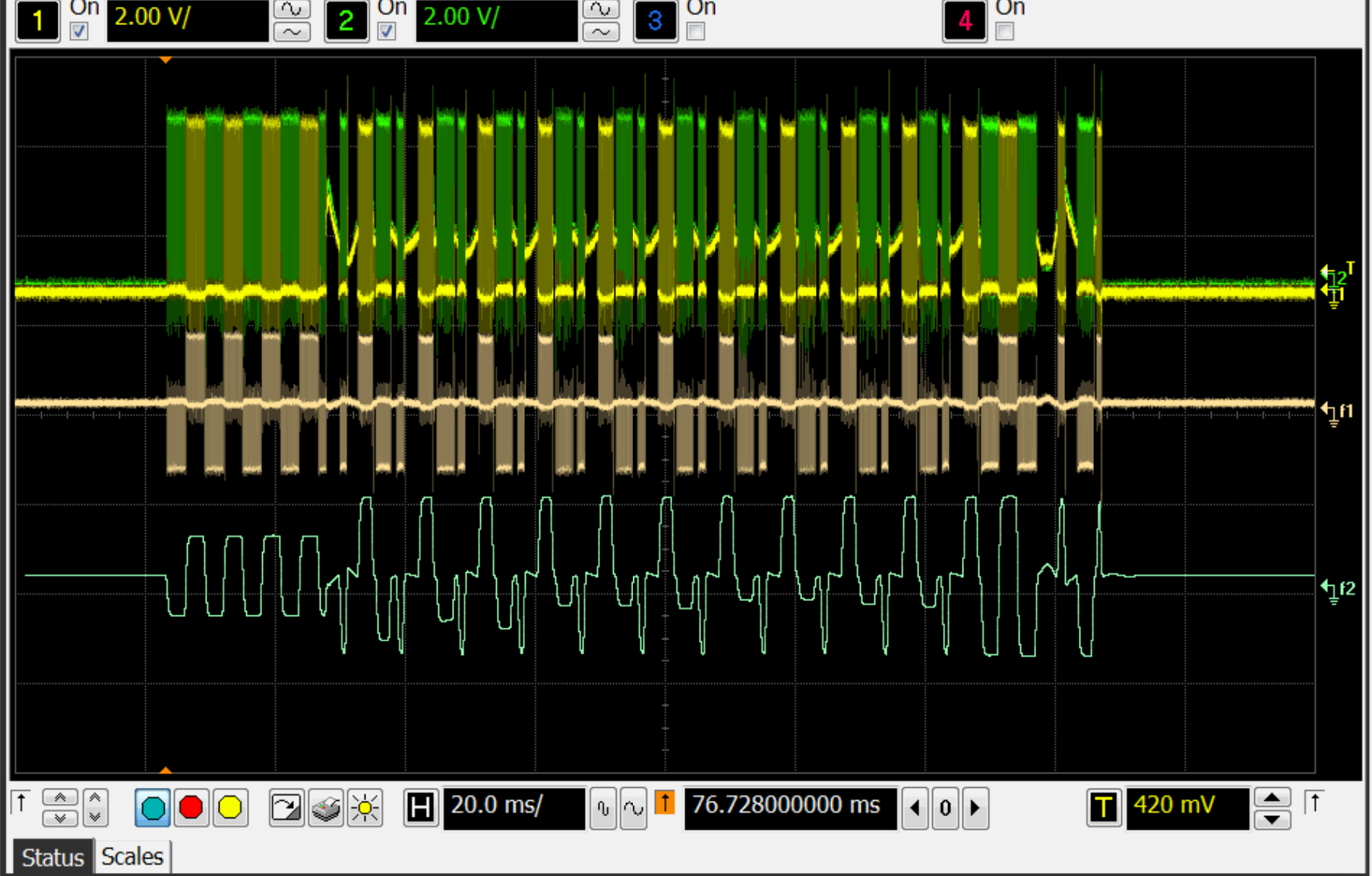

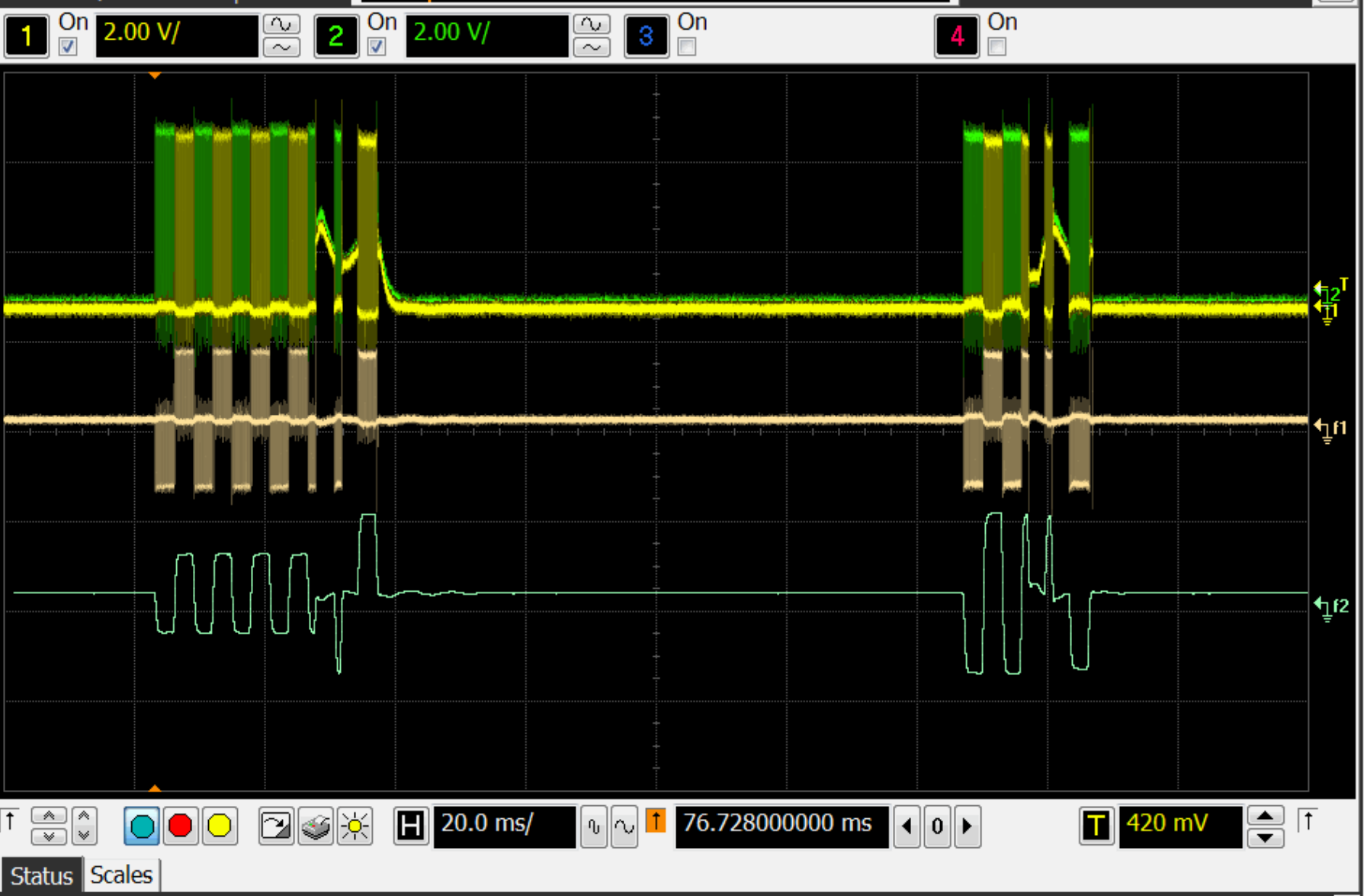

    We have a issue on the device that when we enable two vibration which are 25ms with 0.9v(OD_LCAMP) and 10ms with 1.8v(OD_CLAMP) in sequence mode, and there is 100ms between this two vibration.It can't stop the vibration after the first vibration
    From PWM waveform,the DRV2624 is keep doing breaking during the 100ms, is there any clue we can check on this issue?or any factor cause this issue?
  • Eddie,
    It seems like the feedback value from the actuator is not letting the device know that the actuator is stopped.
    Does this happens only for this specific combination? Does this happens randomly or every time the sequence is ran.
