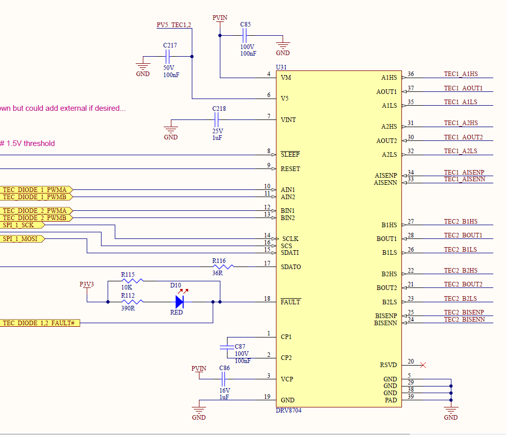

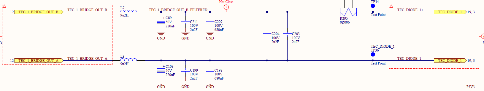

I was wondering if the support team could offer some advice on a design where we are implementing the DRV8704 into a TEC (Peltier) driver system. To achieve this, the outputs (xOUT1 and xOUT2) from the MOSFET bridge are LC low-pass filtered (yet to be optimised). Depending on the complementary duty cycle of the PWM inputs to the DRV8704 (an inverter is used on a single PWM signal to provide true commentary inputs), the DC output has a bipolar swing from 0V differential voltage through to almost the full VM (PVIN: +48V) across the outputs. So, each output will have ½ of VM applied to it for a 50/50 duty cycle into the device. The MCU is not generating the PWM signals but has control over if they are in-phase or are inverted, and if they get sent to the DRV8704 or not (can be disabled).
I have attached schematic captures of the DRV8704 driver, bridge, and output filters. The SLEEPn line can be assumed to always be pulled high in fixed hardware, the RESET line is controlled by an MCU (internal pullup enabled), however currently this has no external pullup on. I am aware the DRV8704 has an internal pulldown on this pin. The PCB layout is fashioned as the one recommended in the datasheet. I have a six-layer PCB where the gate drive traces via straight from the device pins into an internal layer and are widened.

I can’t see any obvious issues in driving the CSD19531Q5A FETs with the default register setup, even at 200kHz. I think it may be wise to change the VCP capacitor from a 16V to say a 50V capacitor however. Or it could be possible that the LC filtering itself had something to do with the failure.

    I didn't find something obvious wrong in your circuit and test waveform. Now, we have to step by step debug it.

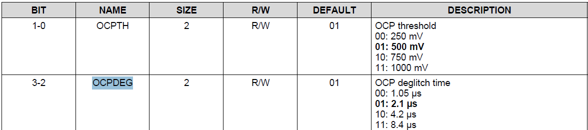

    Regarding over current stress check: I was driving the LC filtered outputs into a 10-ohm resistive load and the driver / FETs died instantly when the PWM inputs were enabled so unfortunately, I didn’t have chance to record the temperatures. The OCPTH and OCPDEG settings were at the defaults (500mV threshold, 2.1us deglitch time).

    I now have a concern over the OCPDEG settings – does this mean I need to limit the maximum applied duty-cycle for a given input frequency? Otherwise like you say, the driver cannot have OCP as the HS FET minimum turn-on time will be less than the OCP deglitch time. So, to allow a suitable deglitch time, as an example for an input frequency of 200kHz and setting the OCPDEG to 2.1us, we can have 42% duty-cycle minimum (period * duty-cycle %), and for 1.05us OCPDEG we can have 21% duty-cycle minimum?

    First, we want to check how high the current can go in OCPDEG. If it is too high, we may have to change the design to limit the peak current. For example:
    If the OCPDEG is 2.1us; the inductor is 10uH; the input voltage is 48V and assume the LC filter output doesn't change to much in 2.1us, the output current could rise I= V*t/L=48*2.1/10= 10A. If you use a small inductor, the current could be even higher and the inductor may be saturated which cannot limit the output current.

    The maximum output current on this particular channel is up to 10A. The inductors on this channel are rated at 9.2uH, 12A RMS, 10.5A Saturation current. The test setup then could theoretically allow up to 10.96A at 48V with a 2.1us deglitch time, which would then put the inductor into saturation.

    Delta I= Vin * Ton/ L. To avoid the issue, we have to reduce input or OCPDEG or increase L.

    2) Most importantly, increase the inductance value with a saturation current that can tolerate the RMS load current plus the peak ripple, but also the RMS load current plus the current inrush produced within the 1.05us OCP deglitch time, to protect against a fault event. This would mean that even at extreme duty-cycles, while the device OCP may not have enough time to react compared to the FET on-time, the increased inductance would prevent the current ever rising to the saturation value within this time. Obviously the MOSFETs must be able to tolerate this also.
