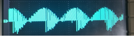

I  configured the chip with 8microstep/step  and mixed decay mode.
I  set the Vref (pin12 and pin13) to  1.33V and make the motor rotate continuously.
The current sense resistor is 200mΩ.  So the setting current driving the motor is 1.33A.
When the motor is running,I measured the voltage of the current sense resistor using my multimeter,  which is 22mV. That's is only 0.1A driving current.
Why the actual current is lower than the set-up current?
I measured the voltage of the current sense resistor using my  oscilloscope, but waveform isn't a  sinusoidal wave.
What's the reason?
Here is the waveform of the current sense resistor:
  • Hi Feiyue,
    >>> The sense resistor does not indicate the total current through the winding. The sense resistor is used to indicate when the current has reached the desired level. The sense resistor voltage is valid when current is being driven through the coil. In slow decay the voltage across the sense resistor is 0.
    You can see the peak voltage is approximately 240mV to 280mV, which is an indication of 1.2 to 1.4A.
    What's the reason?
    The waveform will not be sinusoidal, since the current does not flow through the resistor in slow decay. In mixed decay there will be a voltage across the resistor when current is being driven, an opposite voltage in fast decay, then 0V during slow decay.
    The waveform appears as though it is inverted. Please check your scope probe to see if it is inverted.

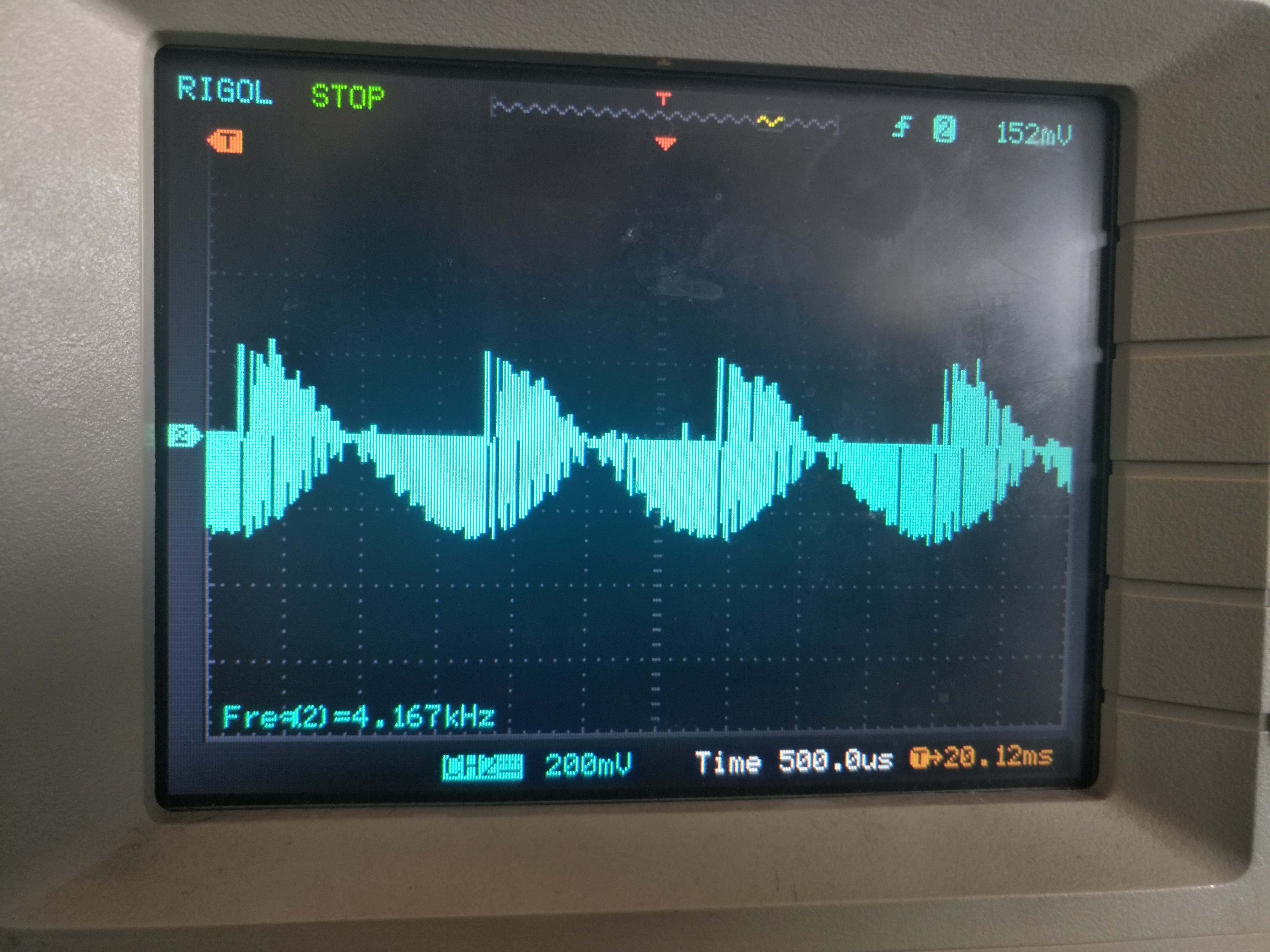

    I say this because it seems the current in the coil is always negative according to the resistor's current waveform?
    This is puzzling. If the scope capture looked like below, it would make sense. Positive only voltage is slow decay when the current is increasing. Positive and negative voltage is mixed decay when the current is decreasing.

    I think I know what confused me.
    Current of the power supply is less than the set-up current. It's is right.
    And the waveform of the current resistor is also right.
