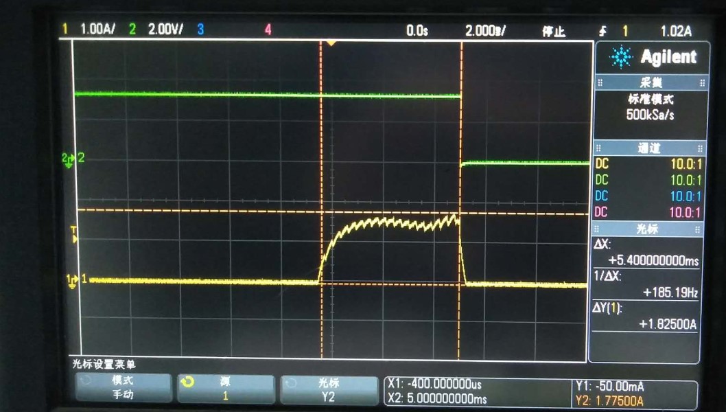

In the test, it is found that nFault will protect the DC motor when it starts, which causes the motor to not rotate properly, and the phenomenon repeats when it is re-energized.
Testing power supply V_MT, no abnormalities (higher than 8V) were found. Please help to analyze the reason why DRV8814 can not properly drive the motor to rotate.
Waveform (Aout1 motor current in yellow and nFLT signal in green)
  • Hi shuang,

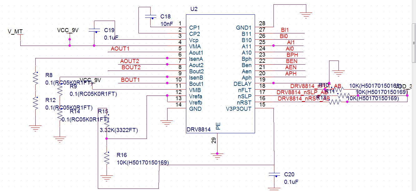

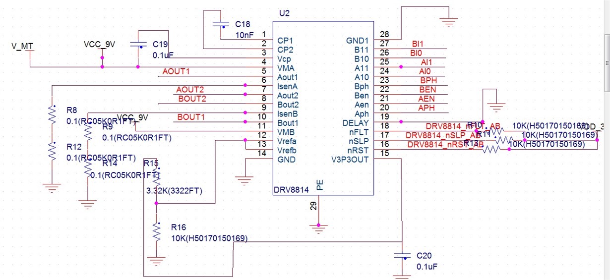

    Can you please retake the same scope shot above, but add a probe to measure the VMA voltage at the IC pin? Sometimes trace impedance between the power entry point on the board and the supply pin causes the power rail to dip. I know you said VM_T had no issue, but I want to double check that you are measuring in the right spot.

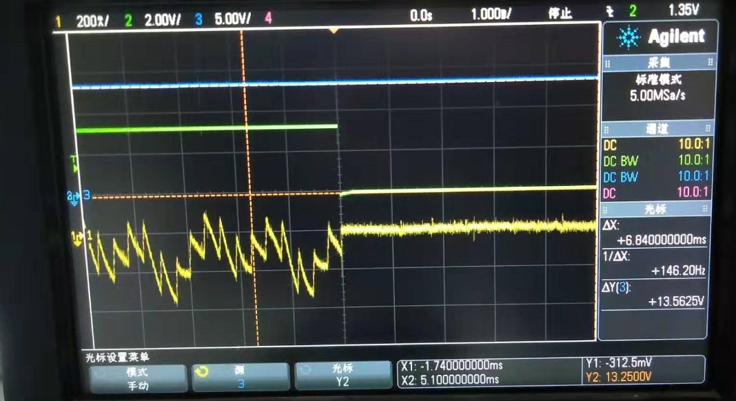

    If there is still no issue, the datasheet recommends putting a 1-MΩ resistor between VM and VCP. I noticed that you do not have this in your schematic. Can you add it to see if it helps?
  • Hi James,
    This is the waveform after adding 1M resistance between VCM and VCP. The blue one is VCM, the green one is FAULT, and the yellow one is motor current.
    The phenomenon is the same as that without increasing the resistance, but it is better than before, that is to say, the turn will stop, now it will take a little longer to stop.
  • Hi shuang,
    Other than putting a resistor between VM and VCP, did you make any other changes to the setup? The current waveform in your second post looks much different from your first post.
    How do you have AI0, AI1, BI0, and BI1 configured?
    When you experience this condition, are you trying to drive one or two motors? Can you try driving with just one set of outputs then the other? I want to see if the issue occurs on one channel or the other.
