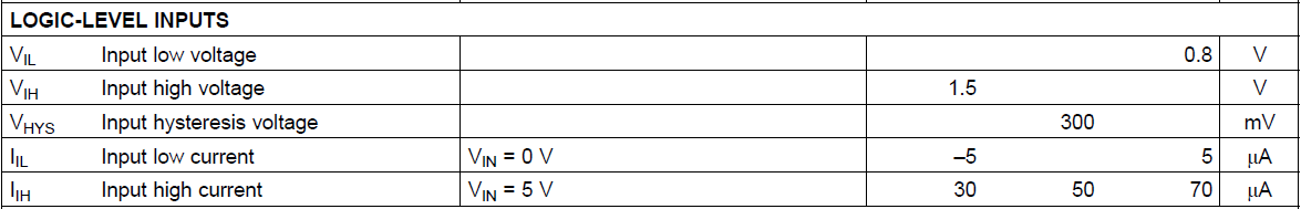

    The clock signal is less 5mV. The SPI command should not work with 5mV clock. The clock waveform is 1us/div. SDI signal is 20us/div. I don't know what command do you send to DRV8711. Would you order an EVM to do a comparison?

    Do you test it with an EVM? If the clock signal is only 5mV, it is much lower than the logic-level input high voltage threshold.  So, the IC doesn't get any command.
