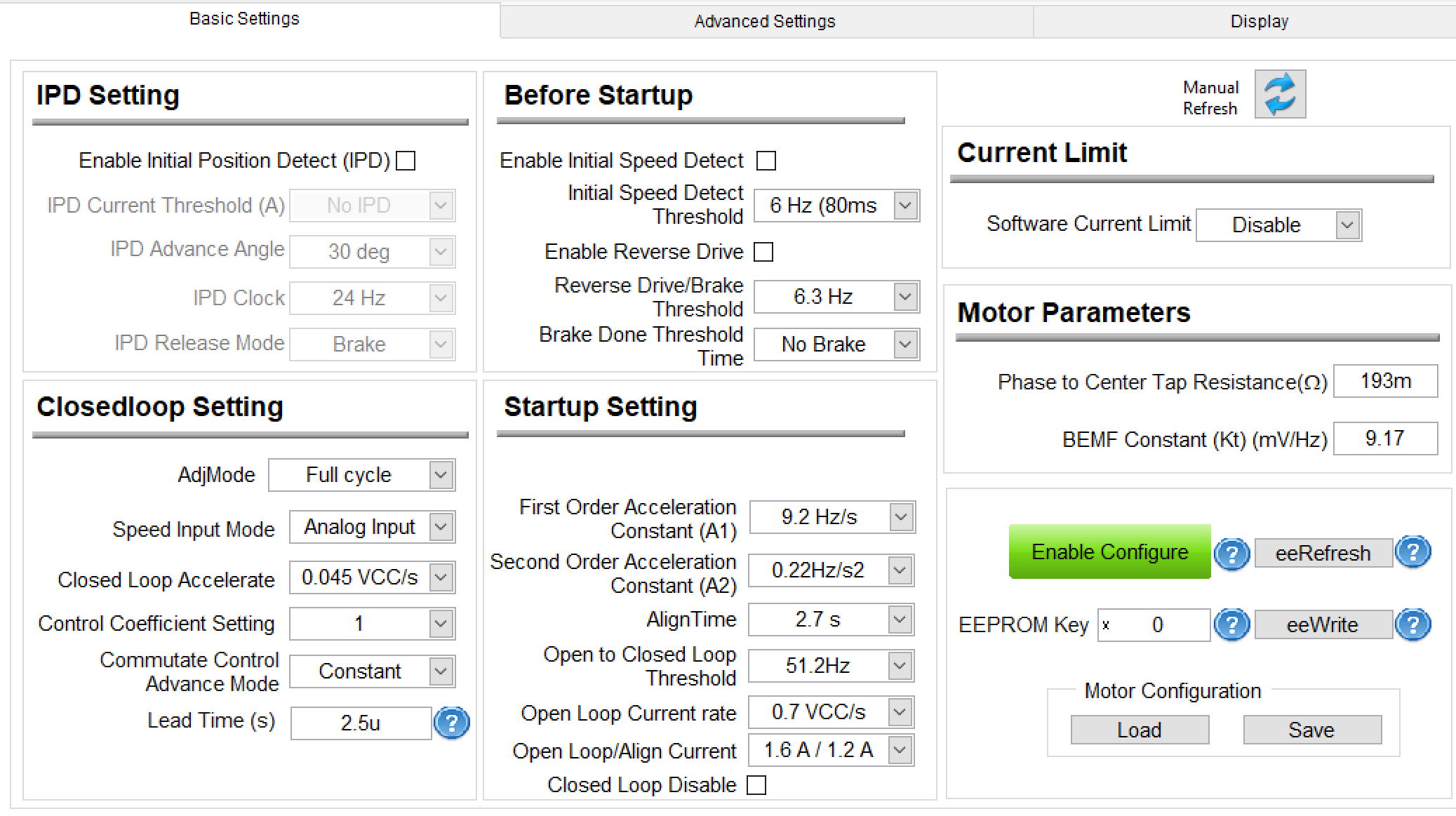

I'm using A2212/13T 1000KV BLDC motor i.e., used in drone. By using external microcontroller i wrote 12 registers (0x20 - 0x2B) of DRV1093 via I2C regarding to motor parameters. And on register 0x00 & 0x01 i wrote 0XFF for full speed, it also included overRide Bit so that speed command through I2C.
measured phase Resistance is 0.155 ohm (according to table value for Register 0x20 is 0x18)
I measured Motor Velocity Constant ≈ VCC / maximum motor speed (no load)
My example: motor spins with 12000 rpm as its rating is 1000 RPM/Volt, so my volt is 12V that's why 12000 RPM. 12 poles and 12V power supply:
12000 rpm / 60 / (6 pole pairs) = 1200 Hz
BEMF constant Kt = 12 V / 1200 Hz =>10 mv/Hz (according to table value for Register 0x21 is 0x0B)
Rest Registers
#define REG_22 0x3A
#define REG_23 0x00
#define REG_24 0x50
#define REG_25 0xDA
#define REG_26 0x8B
#define REG_27 0x10
#define REG_28 0x27
#define REG_29 0x3A  // DeadBand 400 nsec
#define REG_2A 0x04  // Buck Regulator output 3.3V
#define REG_2B 0x0C
But motor spins in unmannered behaviour sometime run and sometime stop because DRV10983 output generate with only 3% duty and it comes after every 4 sec and rest time it off.
So please help me regarding to values of these registers. And it's valuable response if support is regarding to A2212/13T 1000KV BLDC motor's parameters.

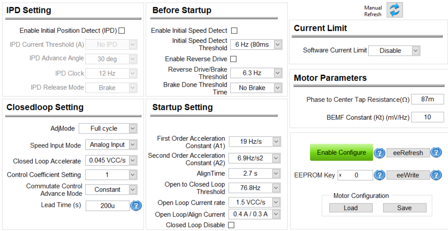

  • for the first 5 sec speed is not too fast and after that A2212 motor continue spinning with very low speed as per given registers
    #define REG_20 0x09 // 87mOhm (Table = 0x09)
    #define REG_21 0x0B // 10mV/Hz ( Table = 0x0B)
    #define REG_22 0x3A
    #define REG_23 0x00
    #define REG_24 0x50
    #define REG_25 0xDA
    #define REG_26 0x8B
    #define REG_27 0x00 // disabled all locks
    #define REG_28 0xFE // current limit
    #define REG_29 0x3B // B=11 i.e., 11*40 = 440nsec
    #define REG_2A 0x04
    #define REG_2B 0x0C // Please check this register Abnormal Kt lock detect threshold
    for full speed via I2C I also write in Register 0x00 = 0xFF and in Register 0x01 = 0x81, but when i read Register 0x10 i got 0x00 and Register 0x12 varying 0x0a-0x0b, what is this matter?

  • Hey Shariq,
    The speed constantly displaying as 1Hz shows the motor isn't commutating correctly.
    1) Please try the settings below:
    Biggest changes implemented:
    a) Doubled pwm frequency to get better motor control.
    b) Increased open to closed loop threshold. The Kt of the motor is low, so we need to increase the handoff speed. If this doesnt work, I would suggest increase
    c) Increased Open Loop current to provide more torque when spinning the motor in open loop. this motor can handle even 10A according to the datasheet, so might as well apply more current.
    d) FG outputs only in closed loop. So if you dont see any FG signal out when the motor is spinning, that means the driver never reached closed loop, so its an open loog configuration problem.
    If this doesnt work, please let me know what fault triggered. Try increasing the open to closed loop threshold if it doesnt work.
    We'll start from this step.
    I think getting a motor phase current oscilloscope capture might help as well.

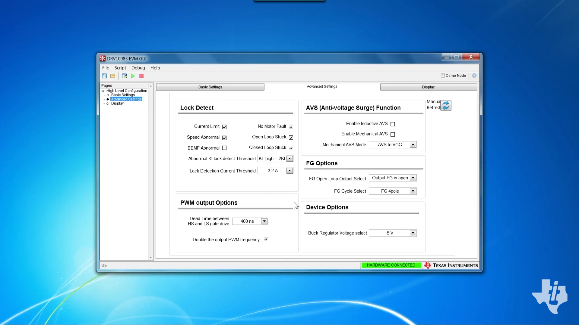

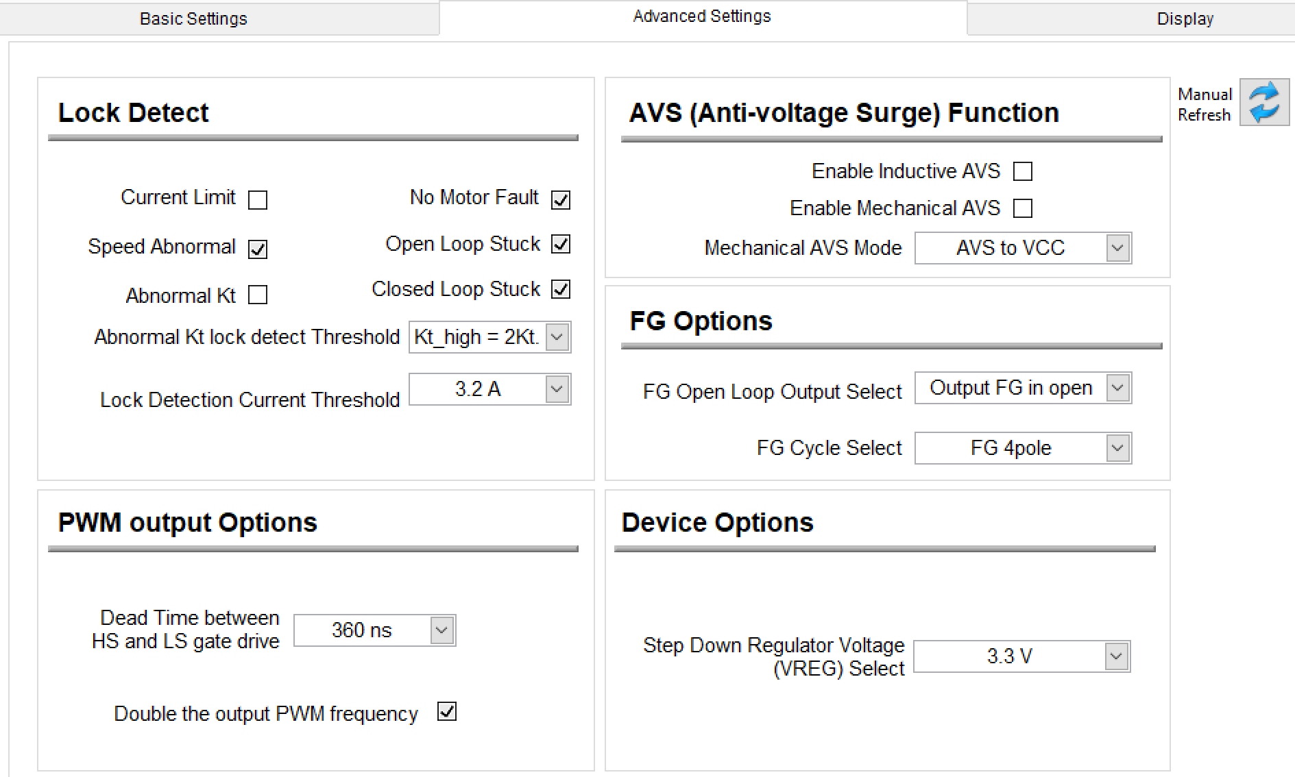

  • Hello sir,
    As per your recommendation I applied following values to EEPROM :=>
     I attached videos for today's work please check the condition
    #define REG_20  0x89          // 87mOhm (value for Rph acc. to table = 0x09), Freq =  50KHz
    #define REG_21  0x0B         // BEMF 10mV/Hz ( Table = 0x0B), AdjMode = Full cycle adjustment
    #define REG_22  0x3A         // commutate control advance = constant, lead time = 200 usec
    #define REG_23  0x00         // ISD Disable
    #define REG_24  0xD0        // open loop current rate 1.6Amp, Open-loop align current 1.5 VCC/s,No brake
    #define REG_25  0xDA        // Control coefficient = 1,open loop start-up accelerate (second order) 6.9 Hz/SecSq
        // Open loop start-up accelerate (first order) 38 Hz/s
    #define REG_26  0xA9         // Align time 2.7 s, Open to closed loop threshold 76.8 Hz
    #define REG_27  0xA0         // No motor fault,abnormal speed fault, I remove your bit i.e.,  detect current limit
    #define REG_28  0x0E         // SWiLimit No acc. current limit, Lock detection current limit threshold = 6 Amp
    #define REG_29  0xFB        //deadband 11*40 = 440nsec,stuck in close loop,Closed loop accelate = 0.045 VCC/s
    #define REG_2A  0x0C        // IPD Disable,Stuck in closed loop, Buck Regulator 3.3V
    #define REG_2B  0x4C        // FG outputs only in closed loop,Kt_high = 2Kt. Kt_low = 1/2Kt
    Motor not accelerate, but there is some kind of force which want to accelerate motor but every time after a little bit jerk motor stop,
    then I read status register which indicates 0x2F, means this Bit indicate that a phase to phase overcurrent event happened. This is a stickybit, once written, it stays high even if overcurrent signal goes low. This bit is cleared on Read
    I also read fault code register which indicates sometime 0x05 means Kt abnormal but mostly  0x01  means lock detection current limit
    I checked phase to phase current it reaches to 80 mAmp, Suddenly by mistake Y Phase wire got disconnected and motor spin with full speed this time phase to phase current is 38 mAmp, when i connect that Y Phase wire Again motor stopped with high jerk, for this i hvn't idea how motor run with two phase.
    I saw in CRO when motor spinning with good speed by two phase one phase duty is 48% and other's was 35%. But in this case of two phases after some time one channel's duty exceeds 60% and motor stopped with high jerk with status register 0x2F.
    when motor spin with good speed by two phases i read motorKt i.e., motorKt1 =0x00 & motor Kt2=0x1E-0x20
    Now what to do, I also attached video regarding to this work please check them

  • I'm confused about the current oscilloscope reading because it looks like the current frequency reduces over time instead of increases to a final value.
    Let's break down getting the motor to spin into steps:
    1) Please give me your most up-to-date full eeprom settings you are using, from rgister 0x20 to 0x2B.
    2) Let's first make sure the open loop works. Please disable closed loop through the CLoopDis. Spin the motor in open loop, and make sure the motor phase current looks smoothly sinusoidal and that the motor is spinning smoothly. The most important thing is to make sure the BEMF Constant Readback from MotorKt1 and MotorKt2 (Kt = {MotorKt1:MotorKt2}/2/1090) matches the expected kt of the motor (I think you expected around 10mV/Hz). If it doesn't match, then try increasing the open to closed loop threshold.
    3) Once open loop works as expected, please enable closed loop again through setting CLoopDis = 0. If it doesnt work, try changing closed loop accelerate or ClsLpAccel bit to the minimum for the least acceleration and try adjusting the TCtrlAdv bits or lead angle.
    Lets have this as the preliminary plan.
    Also, if you could capture 1 motor phase current from startup to spinning or failure, all in one scope capture, that would be really helpful to see whats going on. I would be able to see the align, open loop, and closed loop.

    2) When i disable CLoopDis bit by writing 1 to it . Motor not spinning, only make humming noise but current continous flows through phase, for which i attached video with this conversation. This time MotorKt1 is 0x00 and MotorKt2 ix 0x0F = 6 mv/Hz. And my Kt is 10 mv/Hz not matched with the read value so i increase the open to closed loop threshold to maximum REG_26 = 0xF9 . This time motor make more humming and max current limit reach above 4 Amp that's why humming stop and i read in 0x10 register bit 0x20 overcurrent.
    3) Motor not spin in open loop only humming noise created and continous current flow through phase when REG_26 = 0xA9 // Align time 5.3 s, Open to closed loop threshold 25.6 Hz
    Please check the 4 videos, to download videos then go to link .................... https://we.tl/t-SxWEg969gH
  • I will go through your videos. My only comment is first focus on getting open loop to work. If motor is just humming this usually means either the open loop current needs to be adjusted or the acceleration rates need to be slower.

    Your current open loop settings are below:
    I would suggest adjusting the open loop/align current and reducing the acceleration rates.
    3) I cannot open your videos from your file sharing link because TI blocks access to this link. I will have to either view the videos later at home when not on TI network, but I would recommend just uploading the videos directly to e2e like you did previously, or uploading to youtube and sharing a link.
  • Sir,
         Today i adjust open loop current and reduce acceleration rates as per your suggestion. But can't got success, still motor makes humming noise to move but not move and current continously flows through the phase. for which i attached video.Control coefficient is 1, but it doesn't matter whatever is control coefficient because i already disable close loop by enable bit CLoopDis.

  • I am able to spin the motor as shown below.
    Settings attached are below:
    ShariqueSolution2.csv
    What I did basically was:
    1) Disable Current limit and let the Overcurrent protection just protect the circuit. This way, motor phase current can go up to around 3.5A.
    2) Increase open loop acceleration a little bit so the motor doesnt get stuck vibrating
    3) Use max open loop/align current
    Please take and modify these settings for your application and let me know if it works.
