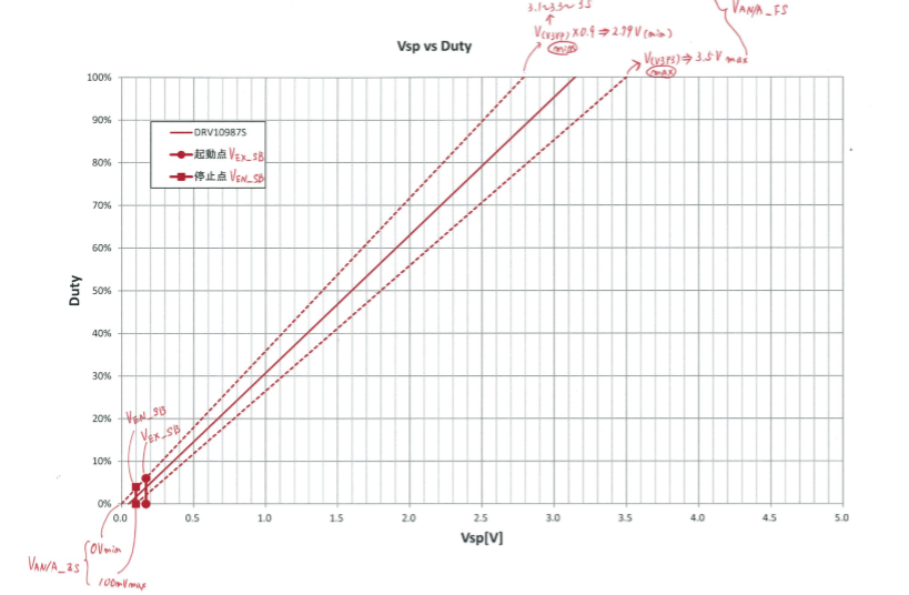

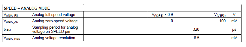

   It will be defined on the datasheet, 0.1V to 0.9* 3.3v.
   I am not sure the real resolution of internal ADC, but I wonder the
  lower reading values & higher reading values would be conveted to Full & Zero?
2. Resolution.
  It will be defined, typ. 6.5mV.
  I wonder the resolution will be reflected the error like INL, DNL?
  If you know like ENOB, Please advice me.

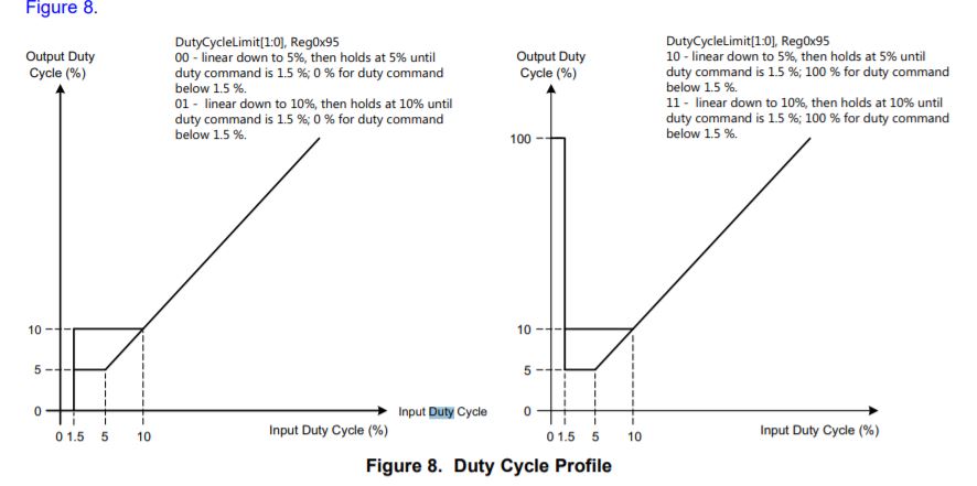

    Answer 1) If the voltage is in the range of "Analog zero-speed voltage" spec,  then it will be zero speed/duty cycle.  If the voltage is in the range of "Analog full-speed voltage" spec,  then it will be full speed/100% duty cycle. But there are two duty cycle profile modes which you can select as shown below and in the datasheet.
    Question 2) "I am not sure the real resolution of internal ADC is". What is effective number of bits? (ENOB)
    Answer 2) Like you mentioned, the analog voltage resolution is 6.5mV typical. As per ENOB, I will have to check, but I would guess around 9 bits, since 3.3V/6.5mV = 507, and 2^9 = 512. I need to check if that calculation is correct.

    Because the ADC accuracy is not listed as a spec in the datasheet, I cannot give an ENOB. However:
    1) if you want to get rid of the adc error, you can control speed through PWM control or use I2C control, which should both be extremely accurate. All speed control methods have a resolution of 6.5mV/3.3V or 10/511, which is almost 0.2% resolution.
    2) Lets assume even if you throw away the first 3 bits out of the 9 bits, you would still have a duty cycle resolution of (6.5e-3V/3.3V)*2^3 *100% = 1.6% duty cycle accuracy. You can decide if this accuracy is good enough for you or whether this is a good estimate for you on ENOB.

  • Q1. Is it no problem to input resistor divided voltage on SPEED pin?
    A1. Its fine. Just keep in mind the internal speed pin pulldown resistance might affect your resistor network.

    Q4. They will use 3.3V LDO output The other side, full & zero-speed ratio & value are defined on datasheet. Does it mean the speed threshold will have the variation due to input voltage shift?
    A4. Correct me if my assumption is wrong. My understanding is you are using 3.3V LDO output as voltage source for the resistor divider. And your question is regarding the consistency of duty cycle commands given from the analog speed control when you have variation from the 3.3V LDO and variation from the the "Analog full-speed voltage" and "Analog zero-speed voltage" voltage values. You are correct that there might be slight variation. Just keep in mind that the ADC reading the analog voltage has resolution of 6.5mV. For more precise duty cycle control if that's desired, I would use pwm speed control or i2c speed control.
