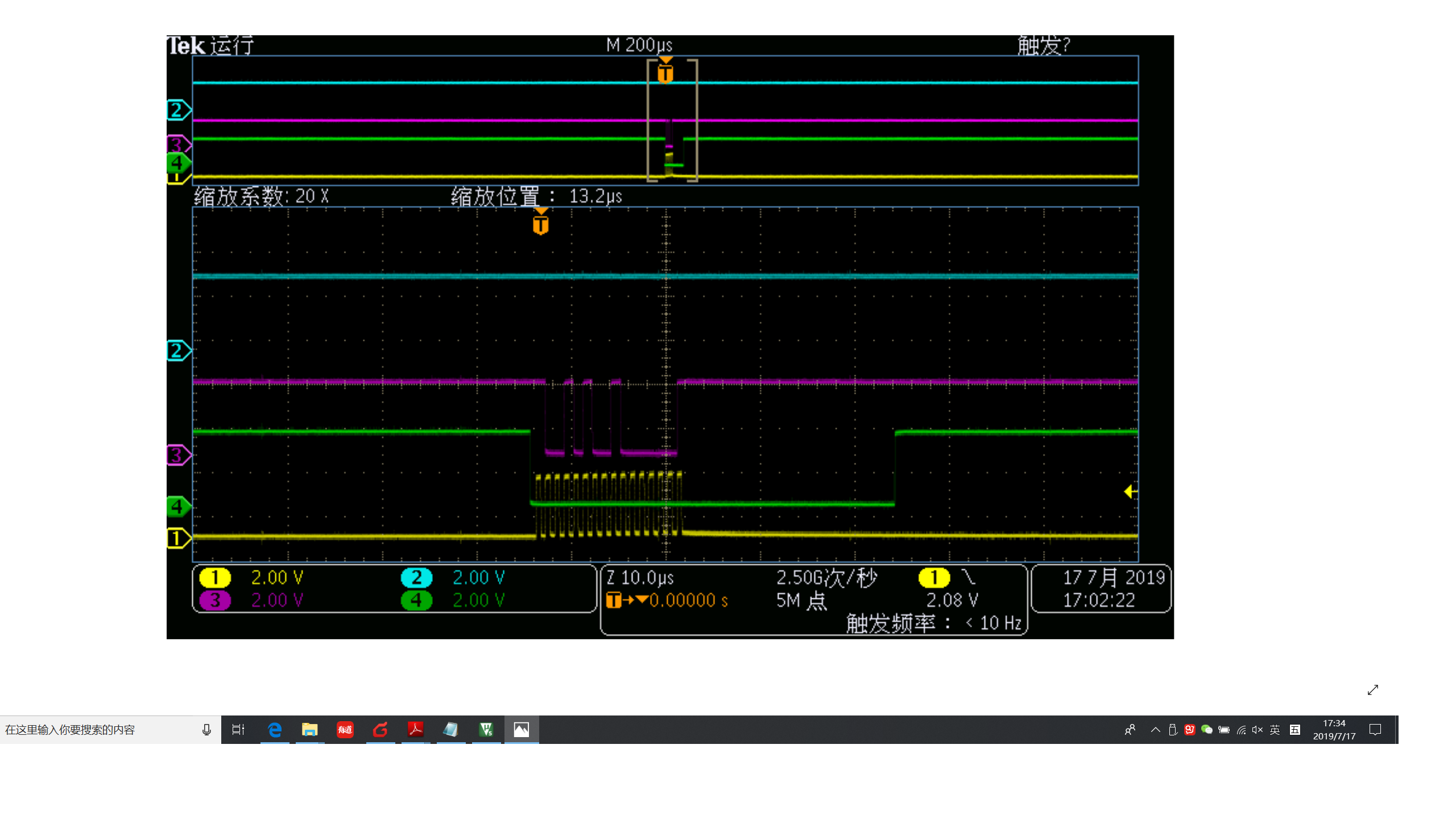

MCU  SPI Output 0x9481 Read  0x02 Register, But DRV8350RS  SDO  have no Signal,  pls help
  • Chai,
    Please mark for me on the scope plot all the SPI signals.
    -Adam
  • Chai,
    1. Why does your nSCS stay low at the end of the transaction?
    2. I see you are trying to read register 0x02, why are you sending data during the read operation?
    3. Have you tried removing the MCU and any filter from the SDO line? Maybe the MCU is holding the SDO high? Please keep the 1k pullup to 3.3V, this is required.
    -Adam
  • Hi Adam,
    here is the feedback from customer:
    1Why does your nSCS stay low at the end of the transaction?
    it doesn't keep as low, after around 20uS, it jumped back to high. please check the screenshot below:
    2 I see you are trying to read register 0x02, why are you sending data during the read operation?
    Sending data should not be influenced by reading data.
    3 Have you tried removing the MCU and any filter from the SDO line? Maybe the MCU is holding the SDO high? Please keep the 1k pullup to 3.3V, this is required
    here is no filter, only 1kohm.
    do you have more suggestion? thanks

  • Hi Matt,
    Could you help to give a list the show the sequence from power-up to SPI communication success? Which conditions must be met and time interval for each stage? The main issue is communication fail between MCU and Smart Gate Driver, The Driver is no response always.
    When the DRV8350RS is enabled and start to communicate, the SDO output is no longer always high, but it is still abnormal and the SDO becomes exactly the same as the nSCS. See below picture.

  • Update from customer:
    SPI was working correctly, the register written happened to be all cleared so nothing was being returned on the SDO.
    -Adam
