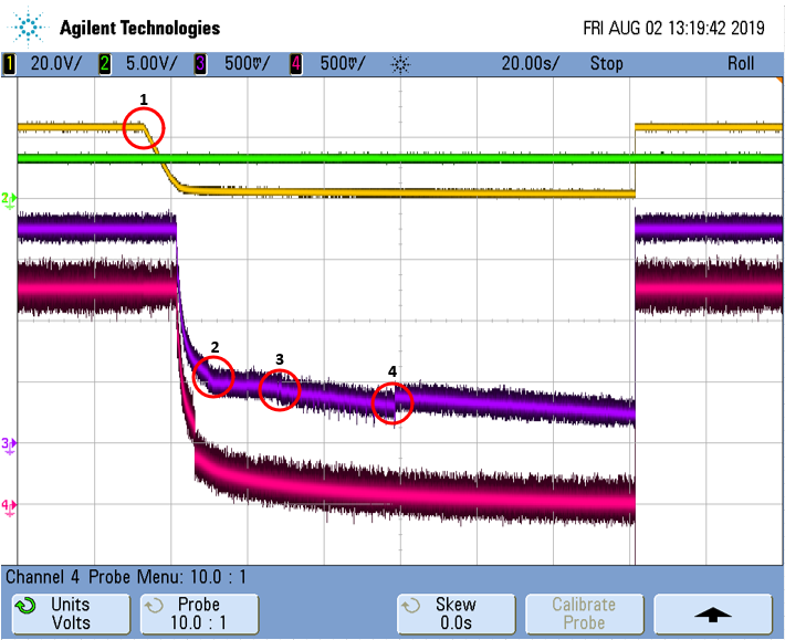

Consecutively to the fact that I was able to repeatably re-create the issue, I instrumented the board to capture PSU_CTRL, PSU_PWR (DRV8308_VM) and DRV8308_VINT (Internal DRV chip core power supply) in order to figure out if this timing behaviour could be the consequence of some internal power supply behavior upon power cycling.
I obtained the following scope capture:
CH1 (Yellow): [Motor 2] PSU_PWR Voltage (DRV_VM)
CH2 (Green): [Motor 2] PSU_CTRL Voltage (3.3 V for MCU)
CH3 (Purple): [Motor 2] DRV8308_VINT Voltage
Step #1: PSU_PWR turned OFF
Step #2: First voltage discontinuity appears on DRV8308_VINT
Step #3: Second voltage discontinuity appears on DRV8308_VINT
Observation:
  • If I bring back PSU_PWR Voltage (DRV_VM) between Step #2 and Step #3, I will always have the DRV Chip bring-up issue.
  • However, If I bring-up PSU_PWR Voltage (DRV_VM) after Step #3, the chip will always boot-up properly and be responsive on SPI bus.

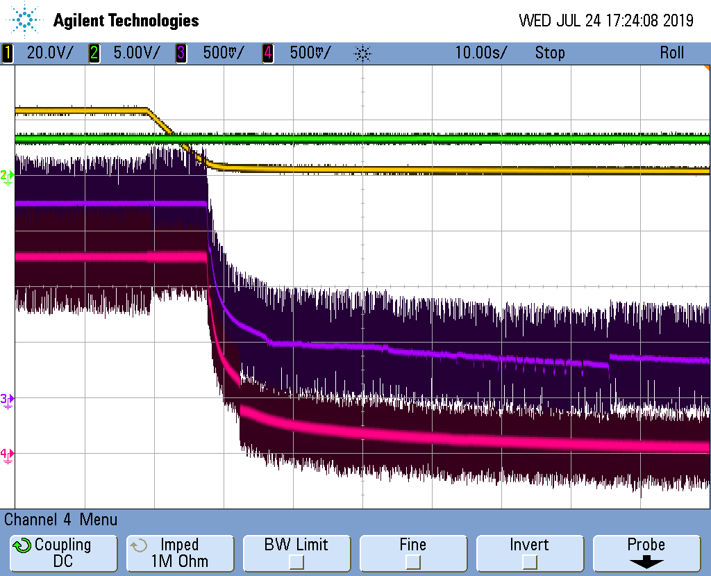

    Thank you for your feedback, below some additional test results I would like to bring to your attention.
    Our board is in fact equipped with to identical Motor-Driver function build around the DRV8308 chip. The board I used to perform my test has one particular motor-driver function that is failing at boot-up: Motor Function #2; and the other one that never presents this failure: Motor Function #1. Following previously published test results, I instrumented the other Motor-Driver function DRV8308_VINT Voltage on the same board that never happens to show the issue in order to look for a potential behavior difference. (See scope capture below)
    CH1 (Yellow): [Motor #2] PSU_PWR Voltage (DRV_VM)
    CH2 (Green): [Motor #2] PSU_CTRL Voltage (3.3 V for MCU)
    CH3 (Purple): [Motor #2] DRV8308_VINT Voltage
    CH4 (Pink): [Motor #1] DRV8308_VINT Voltage
    Observation:
    • [Motor #2] DRV8308_VINT Voltage shows the same repeatable behavior has before.
    • [Motor #1] DRV8308_VINT Voltage seems to be powered down much more quickly and nicely when supply voltage drop below a certain DRV chip internal threshold.
    It is as if [Motor #1] DRV chip always gracefully cut-off all its internal modules when  PSU_PWR  drops below a certain value, whereas, the [Motor #2] DRV chip that fails to boot up seems to have its internal modules not shutting downs at the same timing.

  • Hi Adam,
    Sure, please find the related scope capture below:
    CH1 (Yellow): [Motor 2] VM Voltage
    CH2 (Green): [Motor 2] Enable signal
    CH3 (Purple): [Motor 2] V_INT
    CH4 (Pink): [Motor 1] V_INT
    Step #1: DRV_VM turned OFF
    Step #2: First voltage discontinuity appears on [Motor 2] DRV8308_VINT
    Step #3: Second voltage discontinuity appears on [Motor 2] DRV8308_VINT
    Step #4: Third voltage discontinuity appears on [Motor 2] DRV8308_VINT
    As you suggested, I switched VM back ON when VINT voltage dropped below 300 mV. (Monitored with a DMM) In this case DRV8303 is responsive on the SPI bus after boot-up.
    I noticed that this test doesn't lead to repeatable results as some time VINT voltage drops below 300 mV before step #4 and on next try it will drops below 300 mV after step #4. In this last case only, the DRV8303 (VINT purple CH3 trace) driver will be responsive on the SPI bus.
    Moreover, I leverage this post to add a better DRV chip behaviour description following some additional test I've performed on an actual DRV8308 chip that shows the boot-up failure. It seems that there is a kind of memory behaviour when the chip previous failed to boot-up properly (Non-responsive on SPI bus)
    Observation:
    • If PSU_PWR Voltage (DRV_VM) is brought back between Step #1 and Step #2, the DRV Chip doesn't show start-up issue only if it had previously started OK.
    • If PSU_PWR Voltage (DRV_VM) is brought back between Step #2 and Step #3, the DRV Chip doesn't show start-up issue only if it had previously started OK.
    • If PSU_PWR Voltage (DRV_VM) is brought back between Step #3 and Step #4, the DRV Chip will always shows start-up issue, even if it had previously been brought up OK.
    • However, if PSU_PWR Voltage (DRV_VM) is brought back after Step #4, the chip will always boot-up properly and be responsive on SPI bus whatever the chip was responsive or not on SPI bus before it has been power cycled.
    Hope this can help.
    Guillaume
  • Guillaume,
    What you are seeing is the digital core resetting itself and shutting down as the 1.8V regulator starts to decrease. In the cases that there is a startup failure, the Digicore is not getting reset correctly and therefore SPI will not respond on subsequent startups.
    It seems like your shutdown is taking a very long time, maybe almost a whole minute?
    Did you try the parallel resistor as I suggested?
    I would think that the answer here is to simply alter the VINT such that it shuts down much quicker and then the chip should always reset itself correctly.
    -Adam
