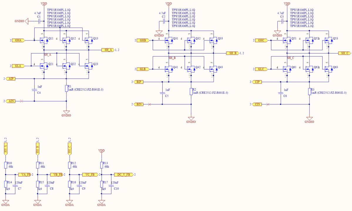

Hi, I'm driving totally 18 MOSFET's with DRV8323RSRG used with MCU TMS320F28069. Total gate charge of single mosfet is 91nC. When I apply 45KHz pwm with 50% duty cycle (VDD 12V), supply current is approximately 170mA. Output voltages are always OK. But when the power supply voltage increases, the current consumption increases too and DRV starts heating.

    Please share your schematic.
    -Adam
    I enclose the schematics related to DRV. Device is composed of two boards, control and power part which are connected by 1.25mm pitch connectors.

    Are you including current into VIN when mentioning the DRV charging current?
    According to all our information, the current should not increase as the VDD increases once the CP has exited doubler mode.
    Since you have three parallel FETs, have you tried with gate resistors or when installing only one of the three FETs for each HS or LS?

  • Hello, thank you so much for your quick reply,
    As the "DRV charging curent" I ment total current measured on power supply minus state, when DRV is enabled with PWMs off.
    When I tried to solder only one FET for each side the current was as follow:
    10V supply -> 110mA total current
    20V supply -> 100mA total
    30V supply -> 90mA total
    -         When I subtract current when PWMs are off, the current consumed by “DRV charging” seems to be constant here.
    With 2 FET’s on each side:
    10V supply -> 140mA total
    20V supply -> 140mA total
    30V supply -> 140mA total
    As you suggested, I tried to add gate resistors (to each FET) with both 4R7 and 8R2 values, but any of these has effect on current consumption. I also watched the gate voltages on the scope, but I didn’t notice any undesirable ringing with or without the gate resistors.
