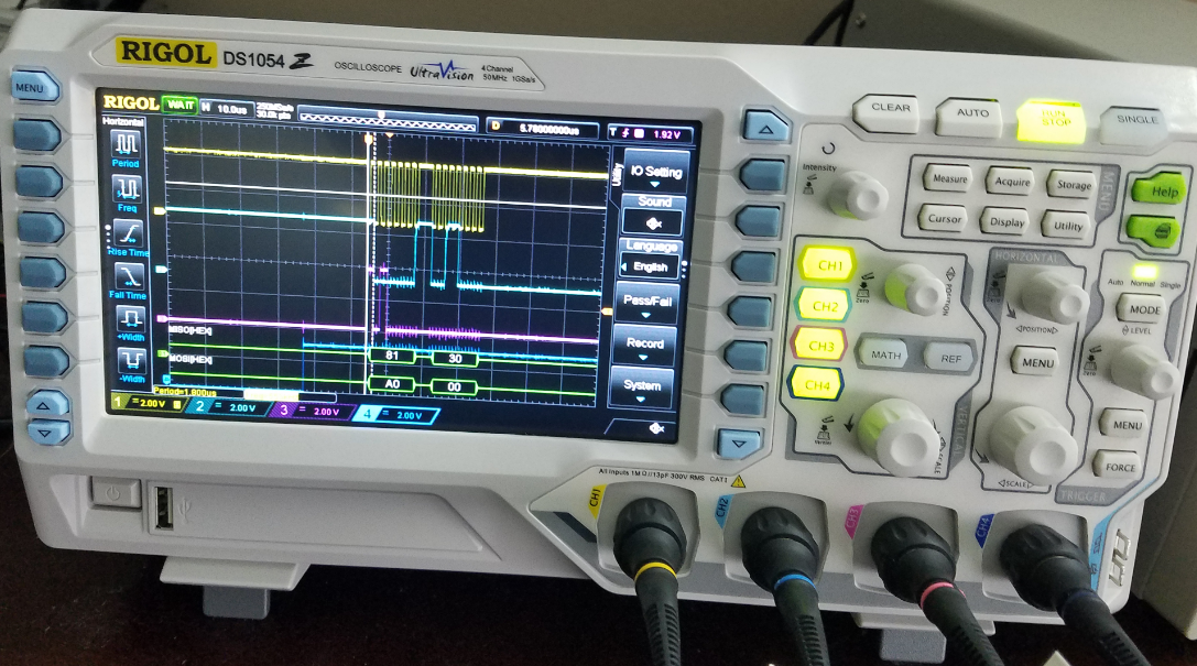

  • Hello Rick,
    I can see the data on the scope but I am not sure why I am getting 0X81 for the first byte plus I am only getting 0x30 in my buffer.
    Mikias Mekonnn
  • Hi Mikias,
    Only bits 8 through 0 are relevant when reading register address 0x2. So 0x81 followed by 0x30 on the scope is correct for bits 8 through 0.
    If you are only seeing 0x30 in your buffer, are you reading your buffer at the end of each 8bit transmission?
    This appears to be a code issue, where the first 8bits (0x81) are overwritten by the second 8 bits (0x30).
