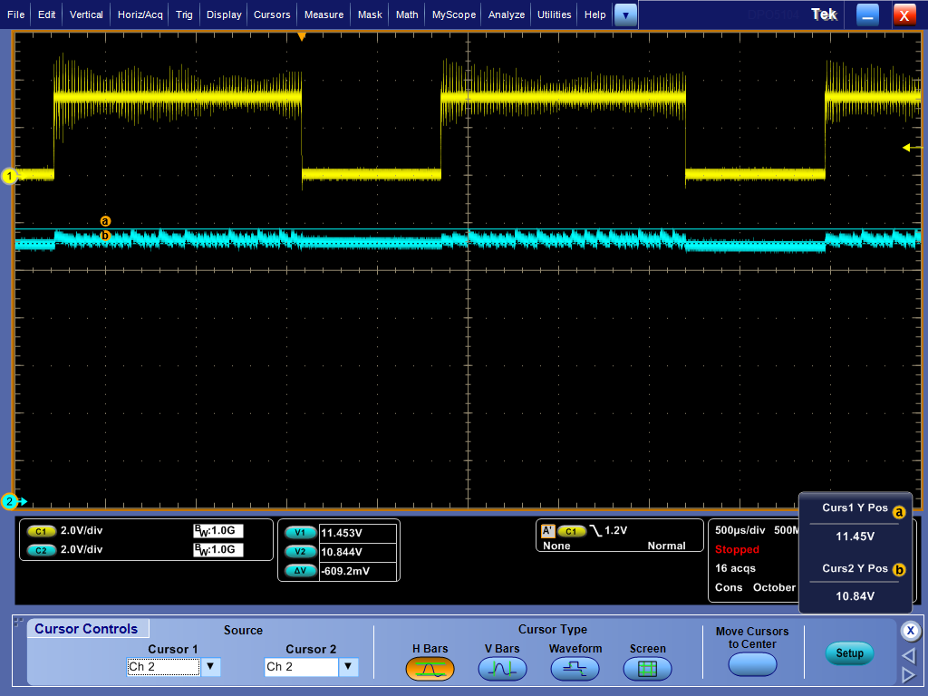

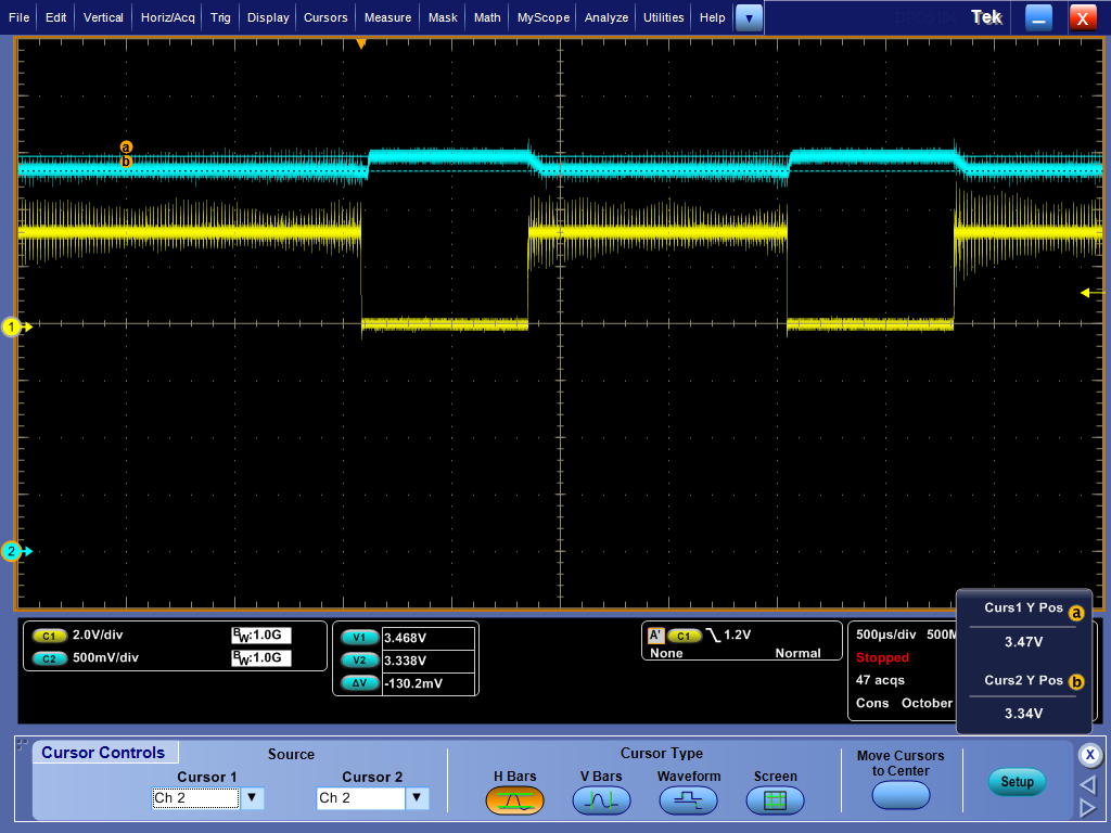

  • Hi Adam,
    we have modyfide a PCB to seperate the power path from the logic side. Also with no improvement.
    After this modification i measure the voltages PVDD, DVDD and GVDD again.
    Ch1: nFault
    Ch2: PVDD
    Ch1: nFault
    Ch2: GVDD
    Ch1: nFault
    Ch2: DVDD
    As you can see there is no violation of the thresholds given in the datasheet.
    OC is disabled. I have also checked the buck voltage in case of the thresholds, which is also fine.
    Is there another possible source for the fault-pin that is not given in the datasheet?
    Thomas
