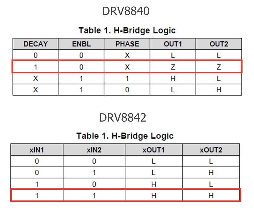

I would like you to confirm whether following input is allowable or not.
* Input "HIGH" level(100% duty) to both IN1 and IN2 for DRV8842.
 According to datasheet of DRV8842, min "Externally applied PWM frequency" is defined as "0 kHz". It seems that user can input 100% duty signal to IN1 and IN2.
On the other hand, I found DRV8840. Input interface of this device is defined "PH/EN". (I'm not sure what is different between DRV8842. Because DRV8842 also allow 100 duty cycle.)
I confirmed logic table of H-Bridge.
According to above, DRV8842 have both output High state. (In this case, If user use 100 duty cycle as PWM, I think there is no chance to reduce current.)
So, the question is below.
* Does DRV8842 actually allow 100% duty for high level to IN1 and IN2 pins ?
Thanks in advance,
  • Hi Machida-san,
    Yes, the DRV8842 does allow 100% duty for high level to IN1 and IN2 pins.
    Current will decay slowly if this is setting is used.
