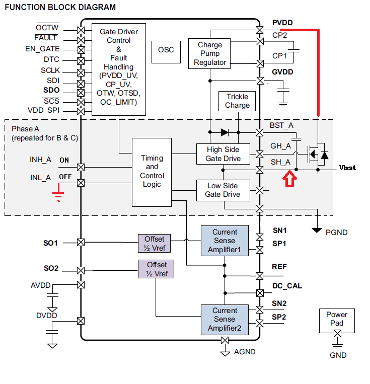

A while ago I asked if the DRV8303 could supply gate drive for a reverse polarity protection connected FET. When power of the correct polarity is applied, the substrate diode of the FET power up the circuit. The driver chip then turns on the FET and shorts out the substrate diode to reduce the power lost. The circuit works as planned when correct polarity is applied but fails under reverse polarity. The trace from Vbat to SH_A burns up and the chip smokes.It seems the SH_A pin to ground cannot handle reverse voltage. I replaced the driver chip and left the connection from SH_A to the BST  cap open and the gate drive still works and the circuit can handle reverse voltage without a problem. When i connected the BST cap to the SH_A  pin  but left the connection to Vbat  open the gate voltage would only rise to 1.4 v.olts with greater that 6 volts applied on Vbat. When the BST cap was removed from the circuit the gate voltage could then rise to a level that turned on the FET (Vgs = ~11 V). Any thoughts on this implementation of the chip? Also why is the gate voltage limited to 1.4 volts ( 2 diode drops?) ?

    I am not fully understanding the different cases you mention above with the VBAT/BST/SHA variations, could you show schematics for the various cases and the resulting operation?
    -Adam
  • I first tried the circuit shown below. The circuit worked with the correct polarity. The FET substrate diode powered the chip and then the trickle charge circuit applied gate voltage to the FET and turned the channel on. Reverse polarity smoked the driver chip and burned the trace going to the SH_A pin.
    It seems the SH_A pin can not handle reverse polarity to ground.
    I replaced the chip and left the SH_A connection open. this connection worked as hoped. With the correct polarity the FET turned on and with reverse polarity nothing happened.
    As third experiment I connected the boot strap capacitor to the SH_A pin but did not connect the SH_A pin to Vbat. This time the voltage on the gate seemed to be clamped at 1.4 volts. Since the source of the FET was at Vbat the FET never turned on.
    The last experiment was to leave the bootstrap capacitor off completely. The circuit worked as hoped.
    Do you see any problems using the chip in this last configuration?
    I was thinking of putting back to back connected 16 volt zener diodes across the gate to source of the FET.
    Also could you explain why having the bootstrap capacitor connected to the SH_A pin would prevent the turn on of the FET.

  • Michael,
    My apologies for not realizing this sooner. It is rare that our drivers are used like this and I assumed you were trying to drive a normal half-bridge or motor.
    The BST isn't needed if you don't plan on using a half-bride where the source of the high side FET is intended to stay at VBAT while the High side FET stays on.
    The reason why the DRV was likely dying while the BST was installed is because if your SH node was not at zero when the charge pump attempts to charge the BST cap, the BST voltage is reduced by the voltage sitting at SHx. Then when the FET attempts to turn on, the charge pump has to work much harder to keep the FET on because of the reduced BST voltage, overworking it.
    One recommendation I do have for when not using the BST cap is to install a Cgs cap and series gate resistor which will help ensure if your VBAT fluctuates that the charge pump and associated circuit doesn't have to struggle to regulate the gate voltage.
    I don't have a great suggestion for the value of cap but something less than 100 ohms should work.

  • Here is the proposed circuit. Where would the resistor and capacitor go?
  • Adam
    In your circuit PVDD goes to the 8303. Battery power comes in through the source of the FET. If the source of the FET is connected to SH_X and reverse battery power is applied the chip smokes. The ground to SH_X connection can not handle reverse polarity.
    mike
  • Michael,
    Thanks for the explaination.
    Looking at your latest schematic, this should work fine. The only thing I would add, optionally, is a Cgs capacitor between the gate and source of each FET. Make sure this is on the FET side of the gate resistor.
    -Adam
