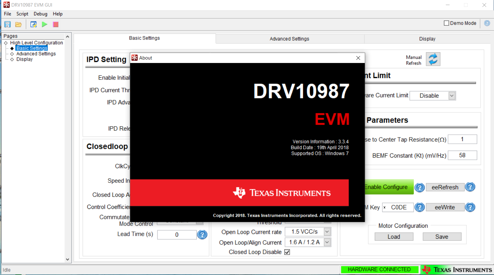

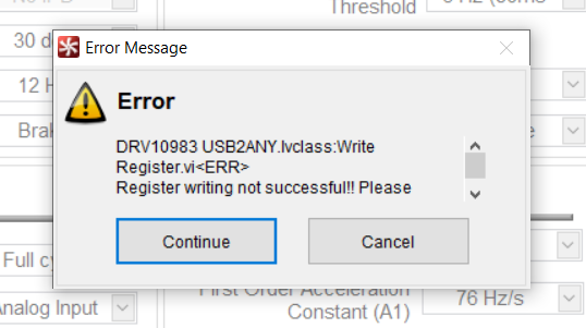

DRV10987: Hello, i'm trying to configrate drv10987 controller with GUI109xx software
Part Number:
i have 2 question about drv109xx controller
1 )  i'm trying to configrate drv10987 controller with GUI109xx software when i connect board to PC and open the GUI i get error
"DRV10983 USB2ANY.lvclass:Read Register.vi<ERR>
Register reading not successful!! Please"
you can see ss in blow.  İ also replace controller on drv10983 EVM board and connect the GUI.  Is ıt make some problem?  With drv10983 it works correctly i just get this problem with drv10987.

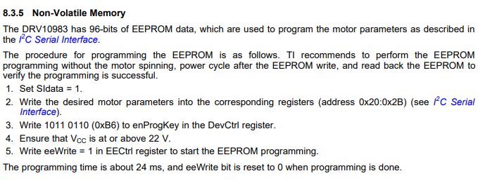

2 )  With drv10983 controller i configrate motor parameter and write eeprom then disconnect GUI with controller motor run correctly there not any problem but when i turn off power suplly and turn on again controoler parameters which i wrote eeprom deleted. Can you please let me know how can i write eeprom permanently to save parameters even supply turn off

  • Hello Dogan Birdal,
    Let me address your questions below:
    The steps for programming the EEPROM are in the datasheet. I've copied them below:
    However, I see you are using the GUI so I will put these steps in context of the GUI. On the Basic Settings, there is a button called eeWrite which will follow the steps in the datasheet. However, the GUI will not automatically populate the EEPROM Programming Key (enProKey). The user must type in 0xB6 in the space themselves. I've showed the example below.
    Before we get into troubleshooting, I first want to acknowledge some basic checks to ensure everything is working as expected. Assuming you are using an EVM:
    1. When powering the EVM and Device with a VCC > 6.2V and VCC < 28V, is VREG = 5V, and V1P8 = 1.8V?
    2. If J2 is configured to use the potentiometer (R2), does the device try to start spinning a motor when it is turned clockwise?
    3. Do you connect the USB2ANY after the device is powered up and observe that the yellow light on the USB2ANY is not flashing (i.e. steadily on)?
    4. Are the markings or text on the top of IC show DRV10987?
    5. When opening the GUI, is the DRV10987 option selected in the drop down?
    6. After hitting continue on this error message, are you able to click the Enable Configuration Button and have the button turn green without any error? Can you click the manual refresh button without triggering any errors?
    7. Did you close the GUI and start the program in administrative mode to ensure there are no permission errors with the GUI accessing the LabView Runtime program?
    Once you have confirmed these steps, we can move onto more
    -Cole

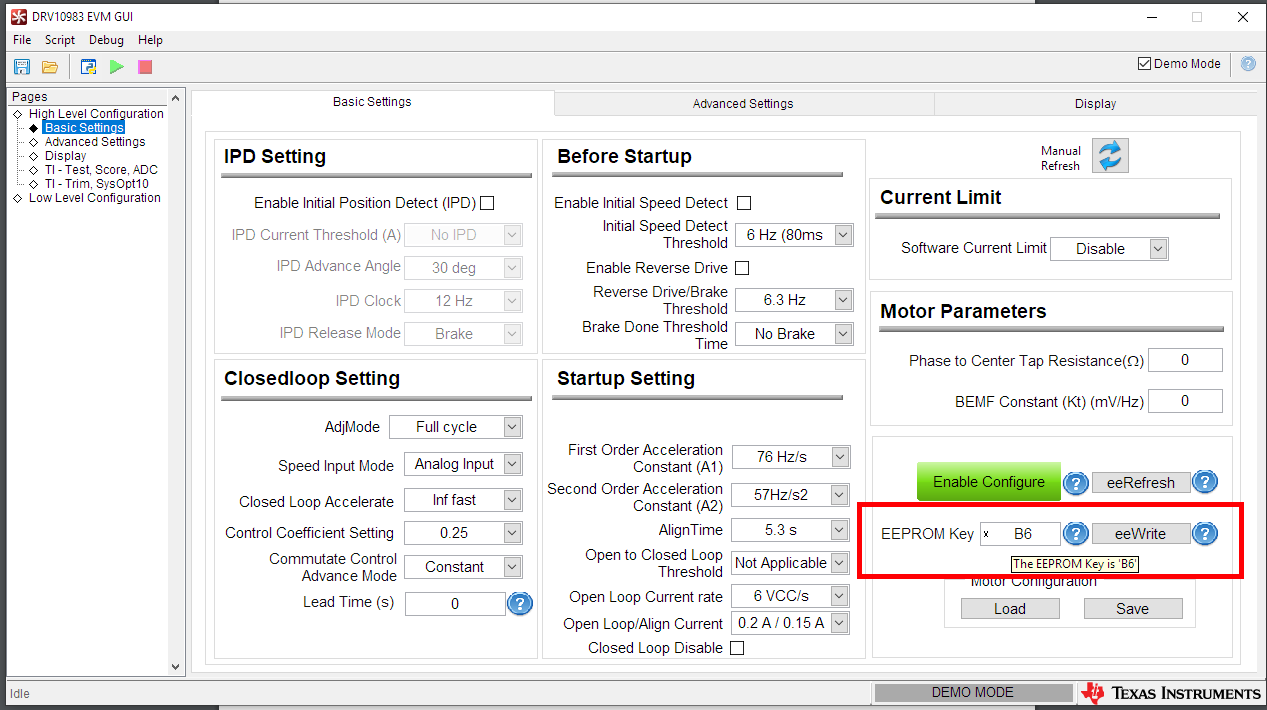

  • Hello Cole,
    thanks in advance for your return so quickly,
    my second problem solved thnaks to you. I can write eeprom permanently but when write 0x02 it works intead of  0xB6 address.

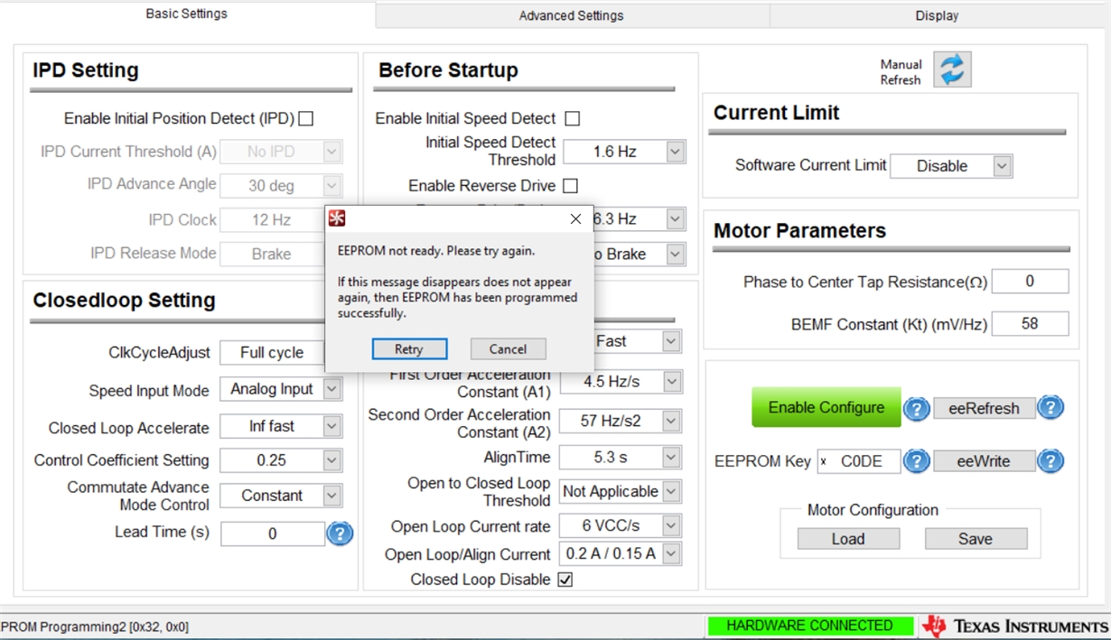

  • Hi Cole,
    Finaly ı managed to solve board problem, now Vreg=5v and i can configure parameter on GUI.  But now some new problems appeared.
    1 ) When i write to eeprom i get a error "eeprom not ready please try again" you can see image in blow. After click "retry" eeror diappear i think it write to eeprom but don't understand why gives this error every each time

  • Hey Dogan,
    I'm glad the hardware is now fixed.
    Let's get through the new questions:
    This is normal, when the user clicks the button, the GUI reads the setting the EEPROM write enable bit (0x35[2]), if it is 0b0, the window will flag it and write the bit for you. Clicking retry will check if the bit is enabled (and since it is) the EEPROM write process will begin. If the write was not successful or the bit wasn't set, then the error message would appear again.
    As a result, you should interpret the message as "If it doesn't show up after clicking retry then programming was successful."
