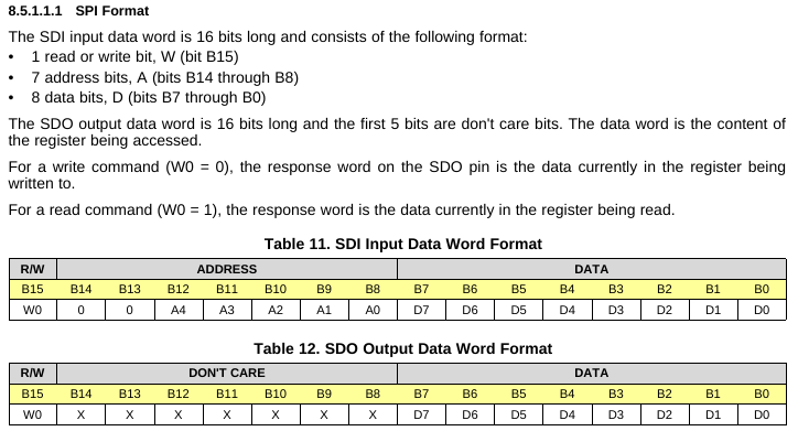

  • I have few questions related to the above image ( a part of datasheet of drv8343).
    Q1: The SDO output data word is 16 bits long and the first 5 bits are don't care bits, and SDO word shown in Table 12 has 7 don't care bits. Why?
    Q2:  For the statement "For a write command (W0 = 0), the response word on the SDO pin is the data currently in the register being
    written to.".  a. What is response word?  Is it the data already written into in the register, or is it directly bypassing the SDI data to SDO?
    b. If some bits sequence is available on SDO, does it mean that SPI communication is successful?
    Q3: what are the steps required in reading the register? As there are differences in SDO word format of different drv such as drv8323, particularly B15 (W0) which is not available in other drv.
  • Dilip,
    Q1) I am checking on this but I suspect this is a typo, usually the address in the SDO response is Don't Care so your 7 bits would be correct.
    Q2) I am checking on this.
    b) No, movement on the SDO line does not imply SPI is working completely, it may be working partially. For example there could be data integrity issues because a GND is missing or something.
    Q3) The steps are standard SPI and are mentioned in the datasheet here at section "8.5.1.1.1 SPI Format"
    -Adam
  • Dilip,
    I have confirmed that yes Q1 is a typo, is should be 7 don't care bits.
    -Adam
