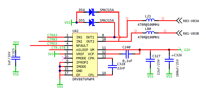

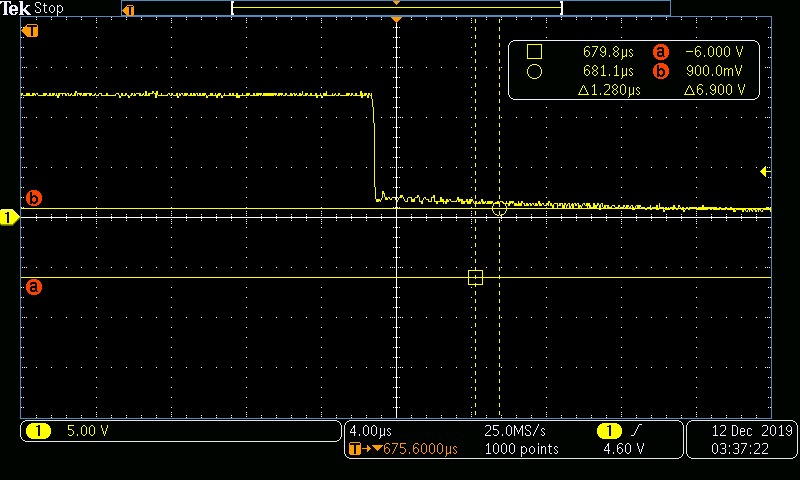

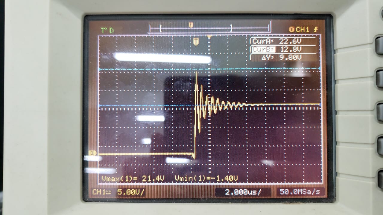

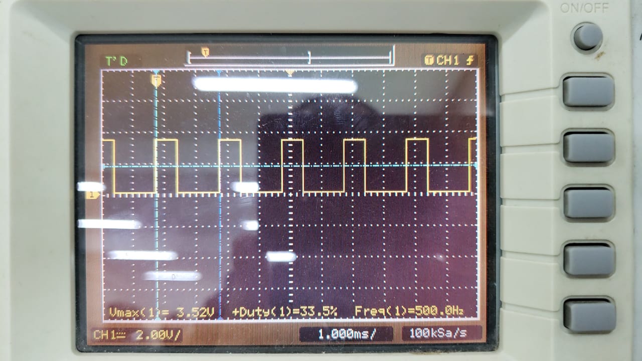

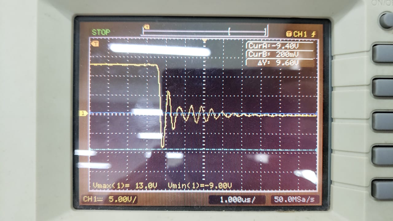

My circuit use the SMAJ15A as H-BRIDG protection:

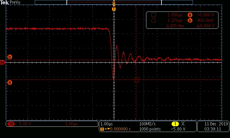

I try to use the circuit above to drive a Solenoid valve, putting OUT2 to LOW and applying a PWM on OUT1.
The problem is witch the H-BRIDGE BURN after some time.
May you suggest me a way to protect H-BRIDGE in that situation?
