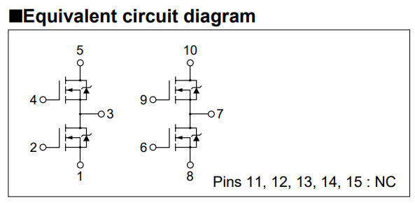

POUYA,
si-7510 sequencer solution uses two SLA5074 devices as the motor driver. In this case, DRV8910 can replace two SLA5074 devices. DRV8910 or SLA5074 is a motor driver product for us. Si-7510 sequencer is a controller. For us, it is not motor driver products. That is why you cannot find a similar device in brush and stepper motor product line to compare with Si-7510..
BTW, for a bipolar stepper motor, the control sequence could be integrated in some of motor driver devices because of its high volume. Such as: DRV8825...
SLA5074 block diagram:
