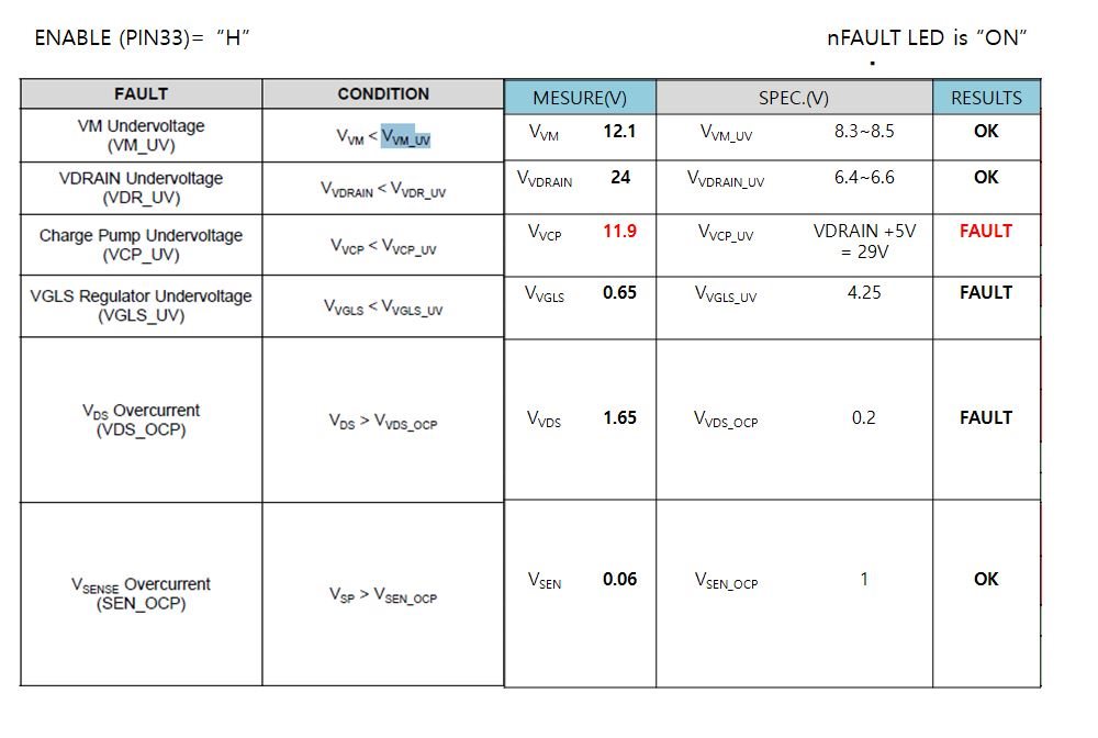

EVM board is operating in H / W mode
Input power is + 24V and BLDC motor is connected.
nFAULT alarm occurred.
According to your technical data, nFAULT occurs when the VM voltage is lower than the VM_UV threshold.
How can I solve this here? I can't see the VM_UV threshold on the EVM board. Therefore, it is not known how to solve this.
