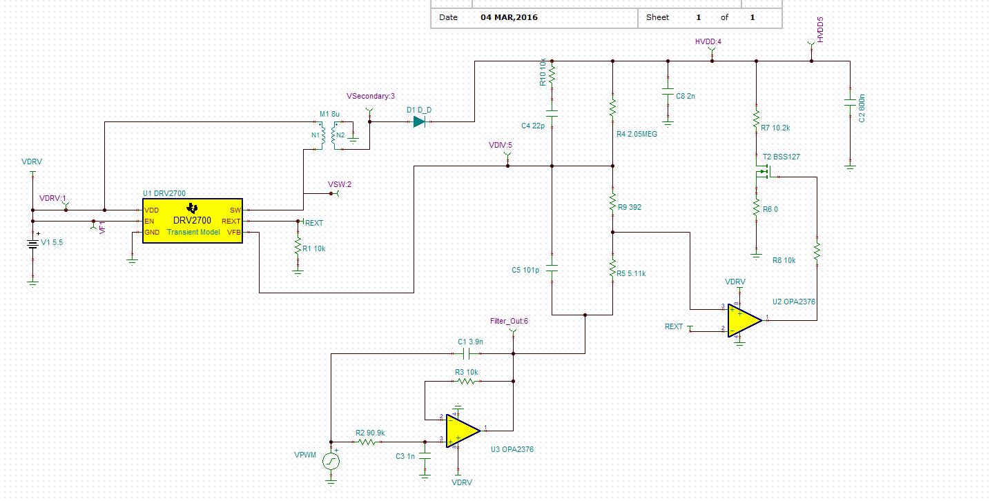

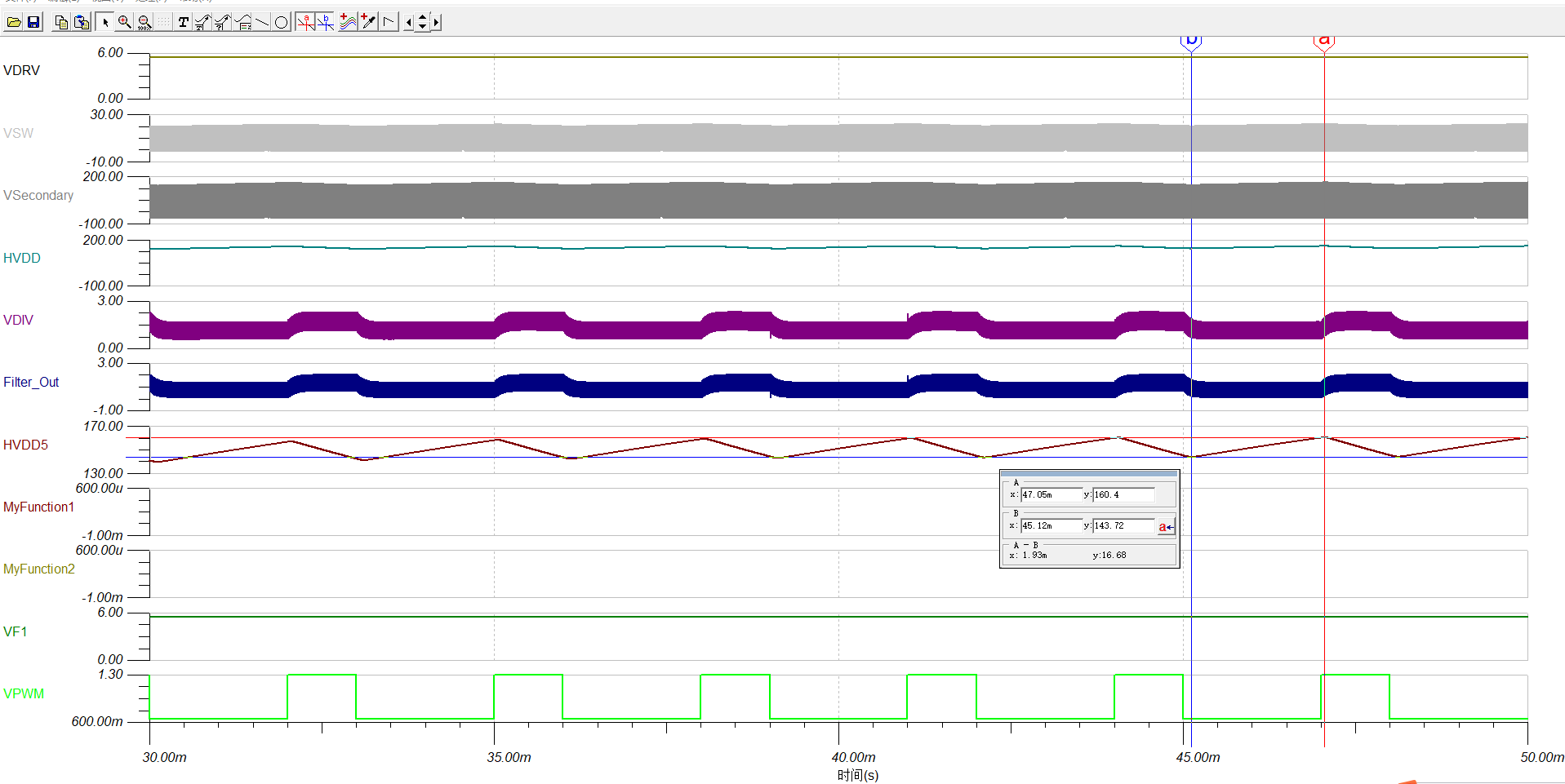

This is a piezoelectric ceramic power supply with flyback configuration. It has been adjusted to an amplitude of about 150, but the voltage output fluctuation is relatively large. Below is the output and schematic:
Customer would like to know are there any improvements or suggestions?
