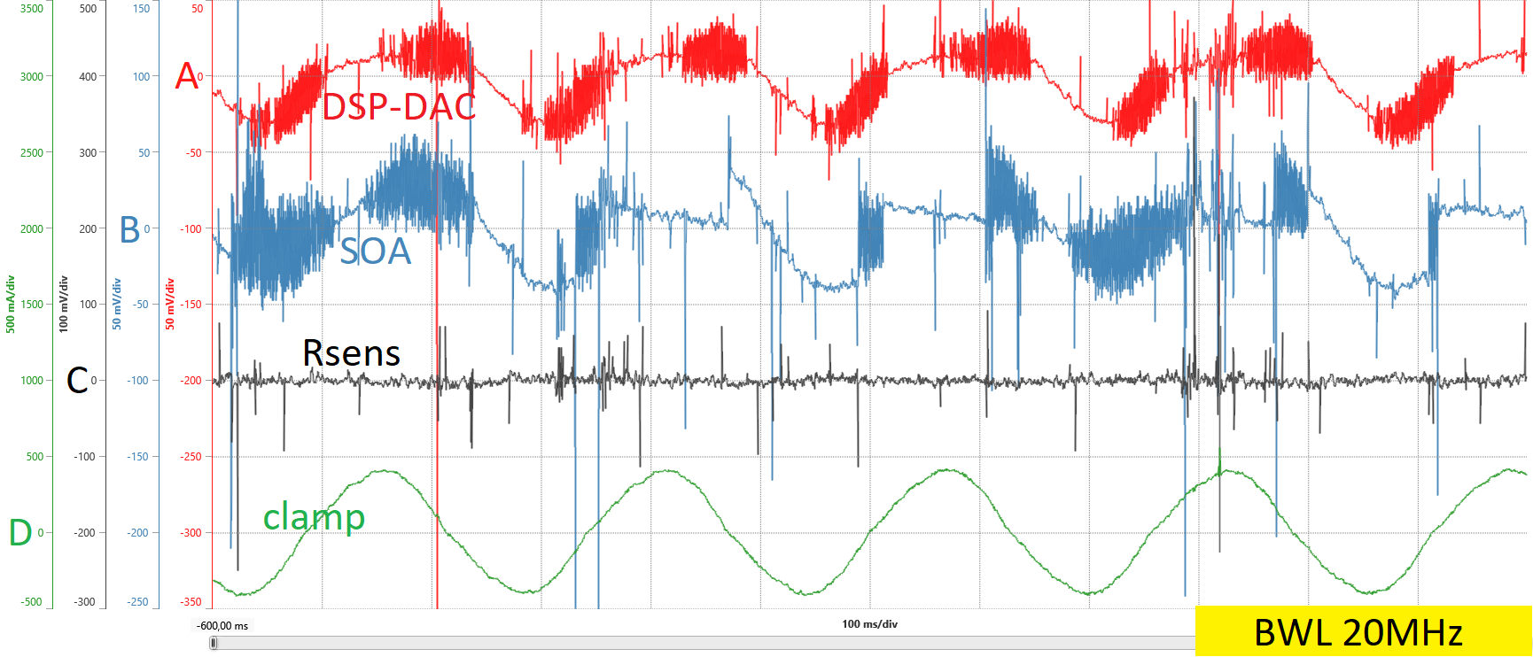

We have a problem about DRV8350 SOx current sense as bellow; Both sense resistor voltage and drive output voltage have a problem. However, our real signal is fine when we measure it by a clamp sensor as shown in figure. Can you explain the What is the problem.

    There are two different result for 20kHz and 20MHz scope filter. All probes are isolated. A and B channels are biased to 0V.
    Channel - A: digital signal in the DSP with 12-bit ADC. This signal measured via 12-bit DAC.
    Channel - B: SOA pin of the DRV8353RH.
    Channel - C: The voltage of Rsens (2mohm)
    Channel - D: Actual current measured via clamp probe.
    Scope used 20kHZ bandwith filter in figure 2.
    Figure 2
    Scope used 20MHZ bandwith filter in figure 3.
    Figure 3

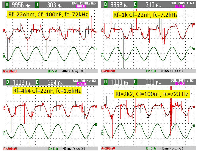

    I'm glad you were able to get a sinusoidal output waveform on the SOB signal. You may need to raise the filtering more, we typically filter in the hundreds of kHz range and even up to 1MHz to only filter out high-frequency noise.

    Could you repeat a few of these measurements again without the 2.2k pulldown resistor? The 2.2k pulldown resistor is creating a voltage divider with Rf and changes the cutoff frequency equation to fc = 1/(2*pi*(Rf || 2.2k)*C. Typically for Rf we use small resistances (i.e. 56-ohm) and C = 2.2nF.
  • Thank you Aoron,
    Thank you very much for answering very quickly and for your time.
    I measured again without pull-down resistor. But there is a continuous cutting top of  the signal.
    Best Regards.

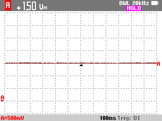

    Can you ensure that you are taking DC measurements of your waveforms? Because your sinusoidal waveforms are biased at 0V, I'm assuming you're taking AC measurements on your oscilloscope.
    Since VREF = 3V, I would expect to see your sinusoidal waveforms biased at 1.5V (VREF/2), and when no current is driving the motor, the SOx signals should be 1.5V. Could you confirm this please?

  • Hi Aaron,
    SOX voltage is zero with some noise. Motor is OFF.
    Channel A 50mV/div
  • Hi Omur,
    This is interesting. I was expecting to see SOx = VREF/2.
    Was the part powered and enabled when this measurement was taken, and can you confirm that VREF = 3V on the oscilloscope?
    Was this measurement taking during auto-calibration (i.e. <50us after powerup)?
  • Hi Aaron,
    Sorry for my mistake. I forgot enable driver.
    I take a new measurement when driver is enable.

    Let's recap what we have done so far:
    - The best scope capture was through the DSP DAC, but the signal was crashing periodically
    - The scope captures from when the 2.2k pulldown resistor was removed seemed to "cut off less" and improve as the cutoff frequency is lowered.
    - Since then, many of the scope captures have been taken using AC coupling. Can you take scope shots from now on using DC coupling because SOx signals should be biased at 1.5V (confirmed from scope capture when motor is off and driver is enabled)
    It looks like the frequency of your sinusoidal current is 10Hz. Could you try selecting a filtering cap to get a low cutoff frequency, i.e. 47Hz to see if the signal improves? Typically we don't have many customers driving sinusoidal current through the DRV835x devices, so I'm curious if high frequencies from noise or some external source are causing to periodically cut off the signal.
    What are you supplying for your VREF = 3V? Typically it needs to be a low noise source, i.e. a voltage reference IC.
    I appreciate your patience as we work through this issue.

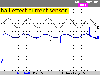

    Actually, I appreciate your patience as we work through this issue. It was a great pleasure working with a professional like you.
    I gave up using SOx in our application, instead I used a hall effect current sensor. We obtained the signal we wanted as below.
    I am very grateful for your time.
    Omur
    New measurement related to SOx your last requested.
    Below you can see the result we obtained with the hall effect current sensor.
