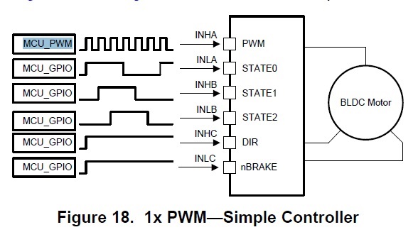

I'm having problems with DRV8320H.   Motor hums but does not spin.
I am running with following settings..
* Supply Voltage 12.5V@24A.
* 1x PWM with MODE pin floating.
* PWM /  I/O controlling from Arduino.
* IDRIVE and VDS are pulled up to DVDD with 18K resistor.
* Motor resistance between each phase is 0.3 Ohm.
* Motor configured as Delta Winding.

    What is the drive time in between each states in 1x PWM mode?
    I am using 4000ns drive time and 100ns dead time.

  • Hi Raj,
    Are you using hall sensors?
  • Hector,
    No hall sensors...
    Thanks...
  • Hi Raj,
    Can you verify if your commutation is correct, according to Table 4 of the datasheet?
    Also, what PWM frequency are you using to commutate?
    I think there might be a commutation step being skipped.

  • Hi Raj,
    1. Have you measured DVDD to make sure it is 3.3V?
    2. Your delai and SPEED parameters are how much regarding time?
    3. Your PWM is 3.921 kHz, correct?
  • Hector,
    Yes....it's 3.196v
    Microseconds...
    Yes...
    I could not find the Launchpad codes for the evaluation board.... Is it possible to get to see how it drives?    Then I can implement on my own board with Arduino...
    I need to know exact timing I need to apply in between the commutation states.
    Thanks...
  • Hi Raj,
    The thought I have relates to your commutation speed. It appears you communicate without getting positional feedback from halls, voltage zero crossing, or current measurement on the feedback. If the only parameter that separates you from proceeding to the next commutation is a delay, it might be too fast or too slow and the motor magnets do not have enough time to energize and commutation the phase change or take a long time between each phase change.

  • Hector,
    Does  eval board codes support parallel control?   I am trying to achieve with figure18 synchronous 1x PWM mode.
    Thanks...
